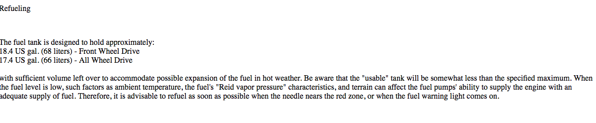

I think I would go to the online manual or stop my and read mine on the way home. It's open, don't wake me up.

Posts: 35272
Has thanked: 1497 times
Been thanked: 3810 times
Screen Shot 2018-03-13 at 11.00.32 AM.png (59.55 KiB) Viewed 3310 times
