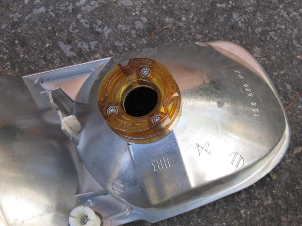

I have a couple reflectors that I believe are OEM and probably pulled from a 2004 C70. Bulb sockets are labelled HB3 and H11. The HB3 has a plastic collar that appears to be held in place by 3 screws. It will accept a HB3.

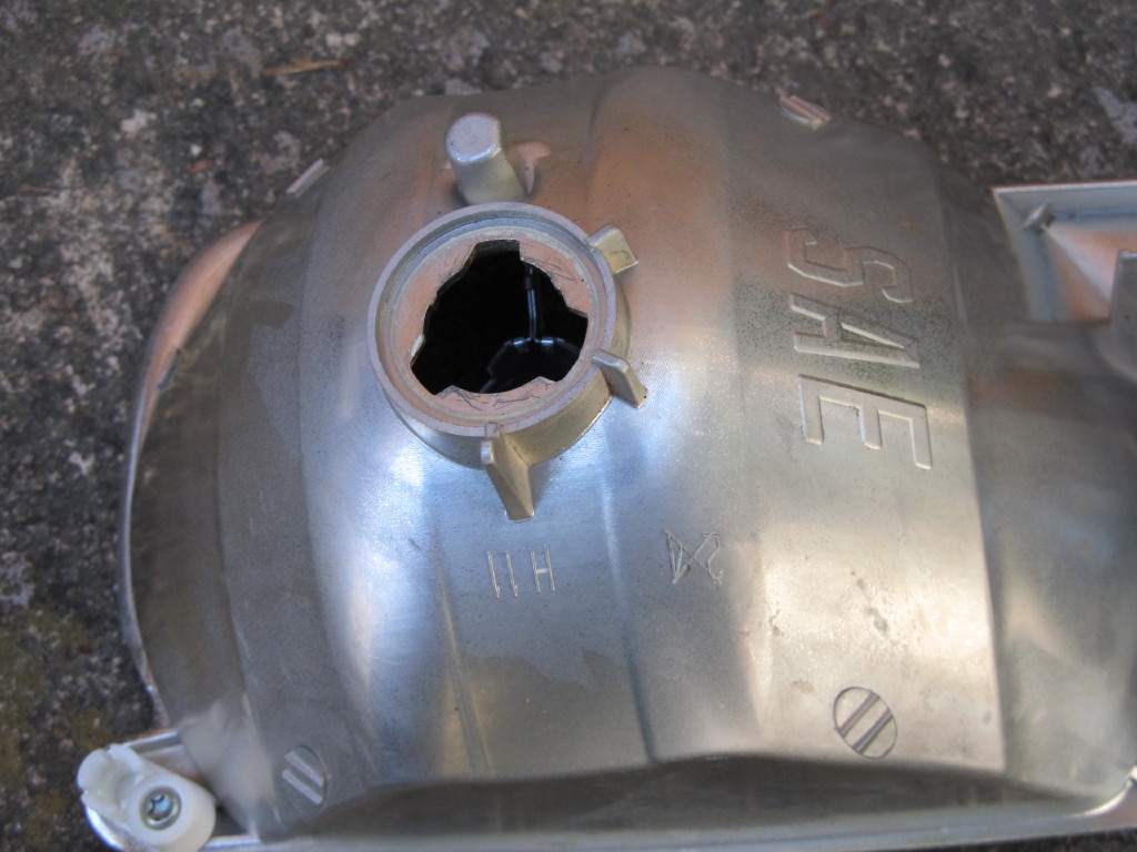

That H11 reflector looks like the others I've seen. I have yet to see another housing like this one.

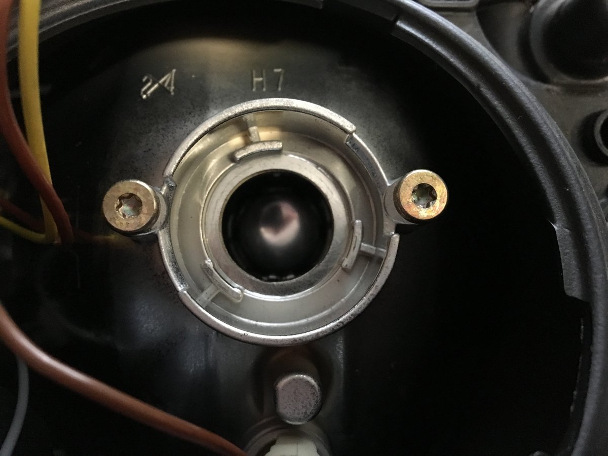

I wonder if someone modified the bulb holders for HID's or LED bulbs so there is something like the plastic ring missing that is held in by the 2 set screws in your picture?

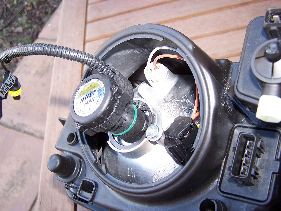

I found this picture in post #12 on this thread... http://forums.swedespeed.com/showthread ... t-upgrades
It appears there is a snap ring securing the bulb. Now to figure out what is between the snap ring and the base of the bulb.

Look at the front of the reflector, might they be early reflectors "retrofitted" to the later housing, or Jewel lenses added to early lights? Note where it says SAE on the reflector in Kranz' photos. That is visible on mine through the access door on the unit. Could yours be a non-US model?
Edit- just looked at one of my OEM 98s. It doesn't look like they ground away material in your photo. Could they be aftermarket projector kits?
Second edit. Yes it looks like the one in the VS post. Snap ring would provide a friction stop to hold bulb in lamp, no groove to hold, just fits. You could possibly do this with an H7 bulb also, just put a phenolic washer between the snap ring and bulb base.

Maybe a trip to the hardware store and some creativity. I can't find any evidence of anything being cut/ground off. No groove for a snap ring, but like you said, I might just fit in there.
