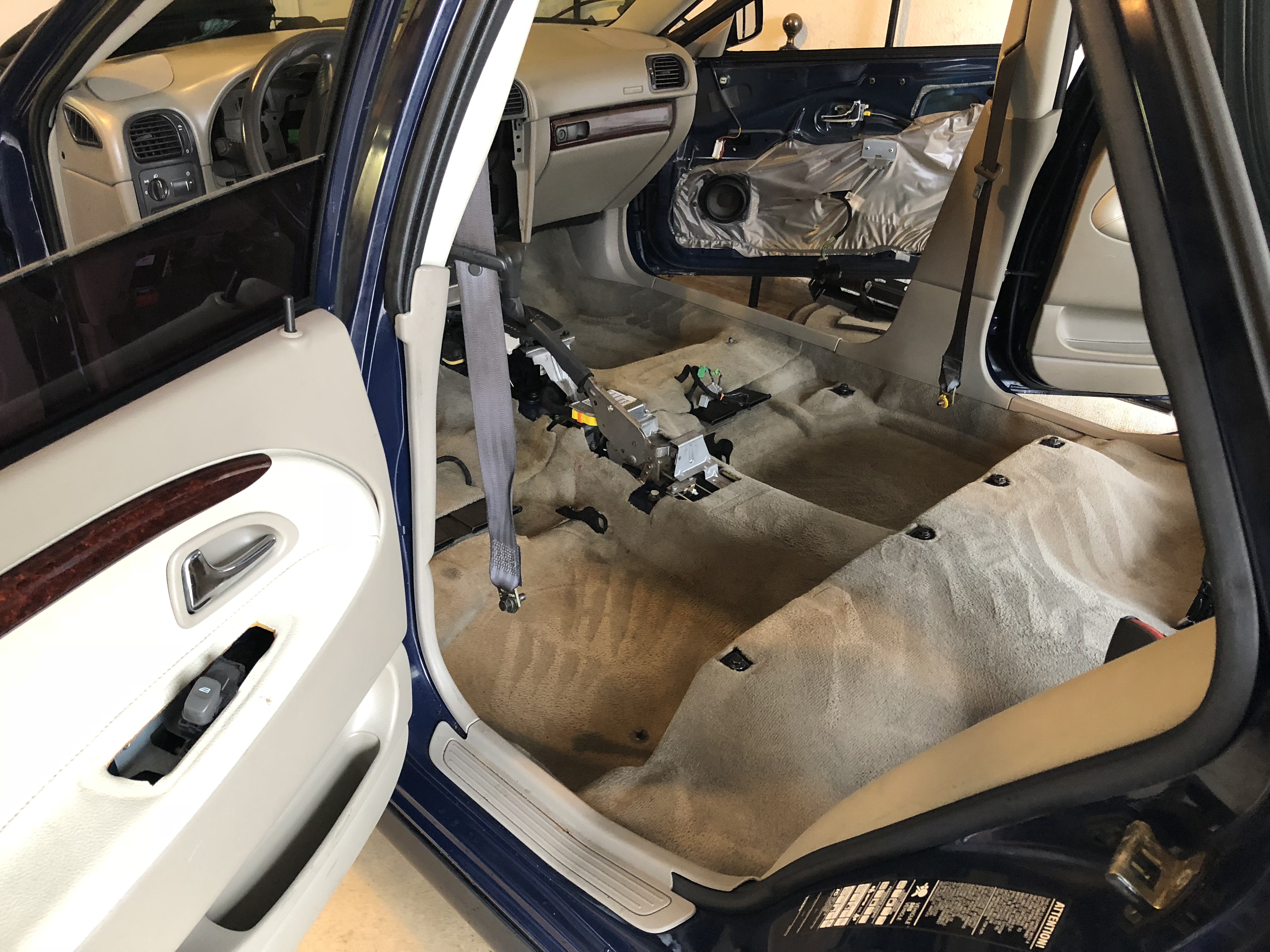

Hey guys, just wanted to share a project I’ve been working on. First off, this is my first Volvo and I recently bought it. My goal is to make the interior luxurious with high quality audio.

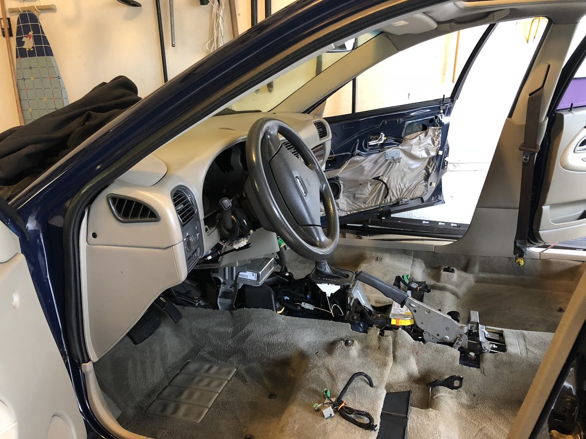

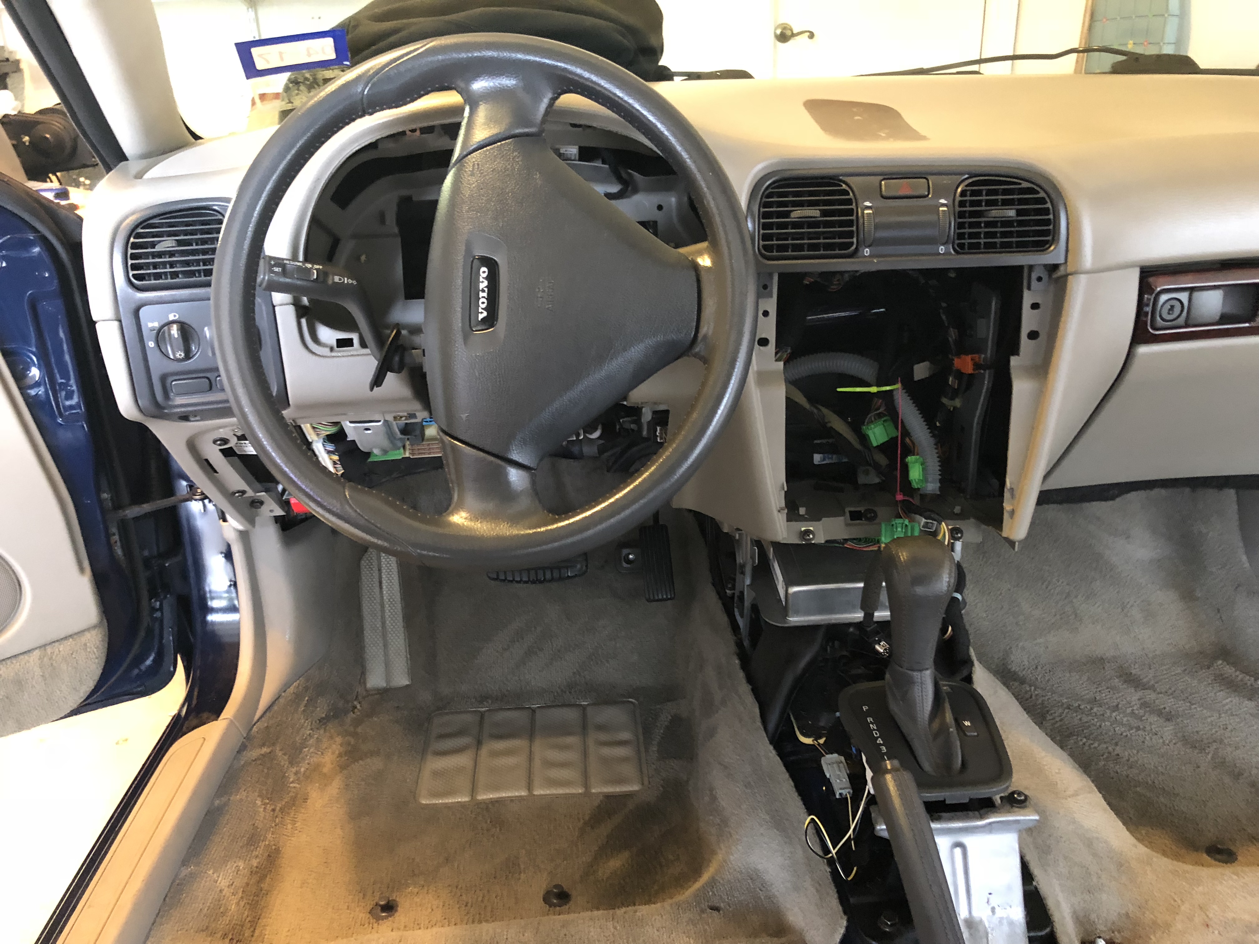

I have had a few mechanical issues I have fixed/replaced, I will touch on those later. First thing I did was take all the seats out and give it a good cleaning and look for things to be fixed.

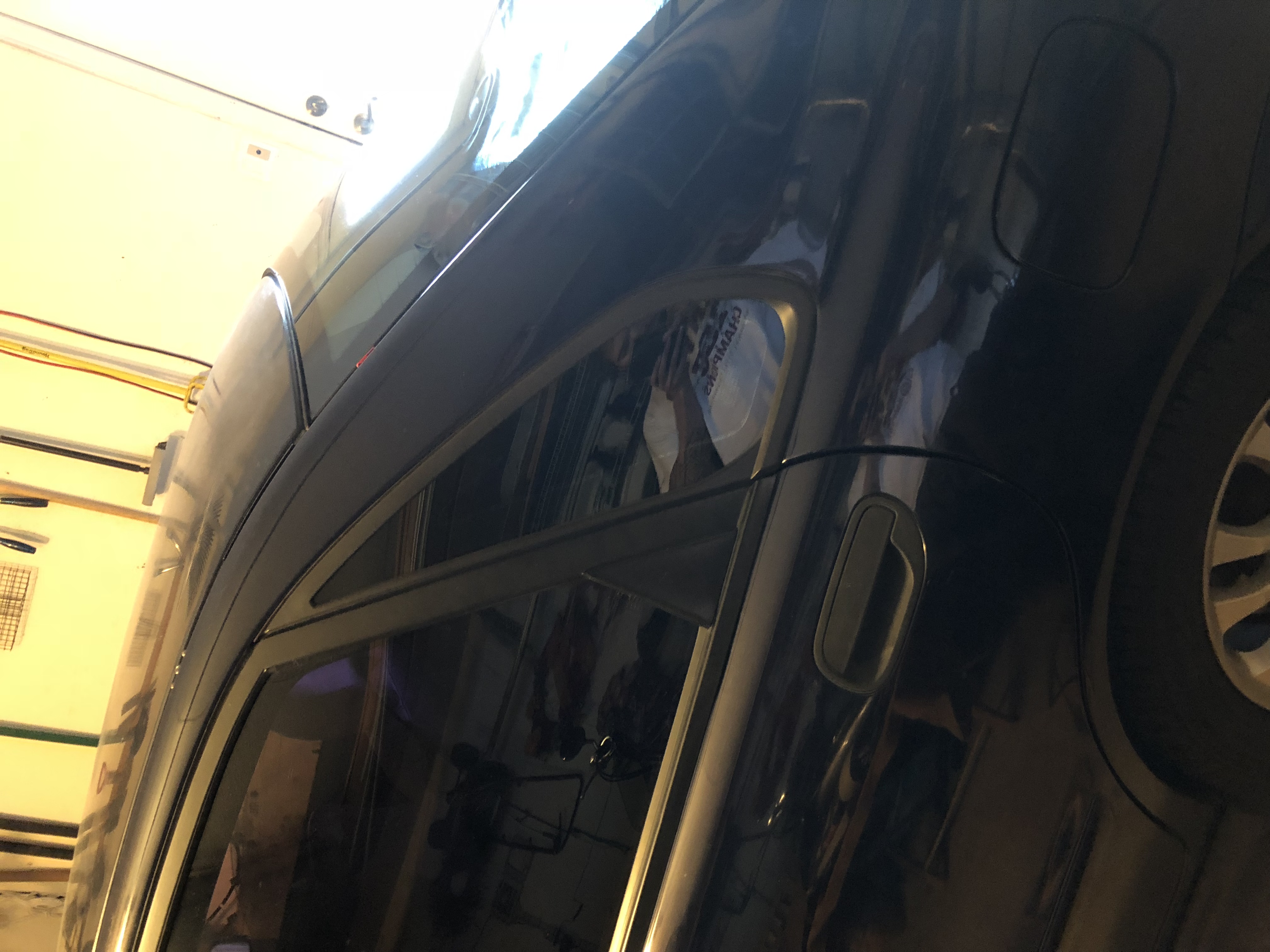

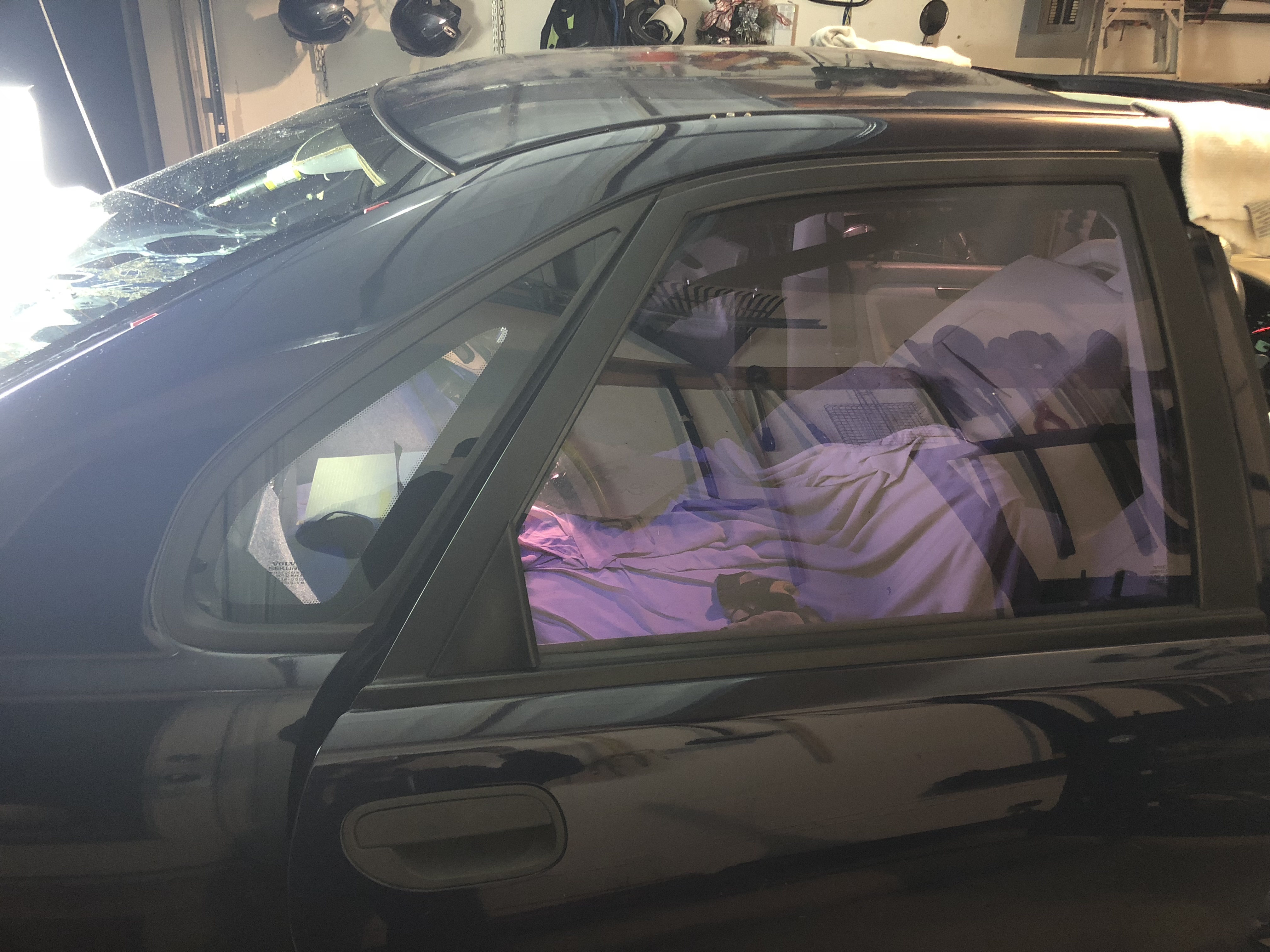

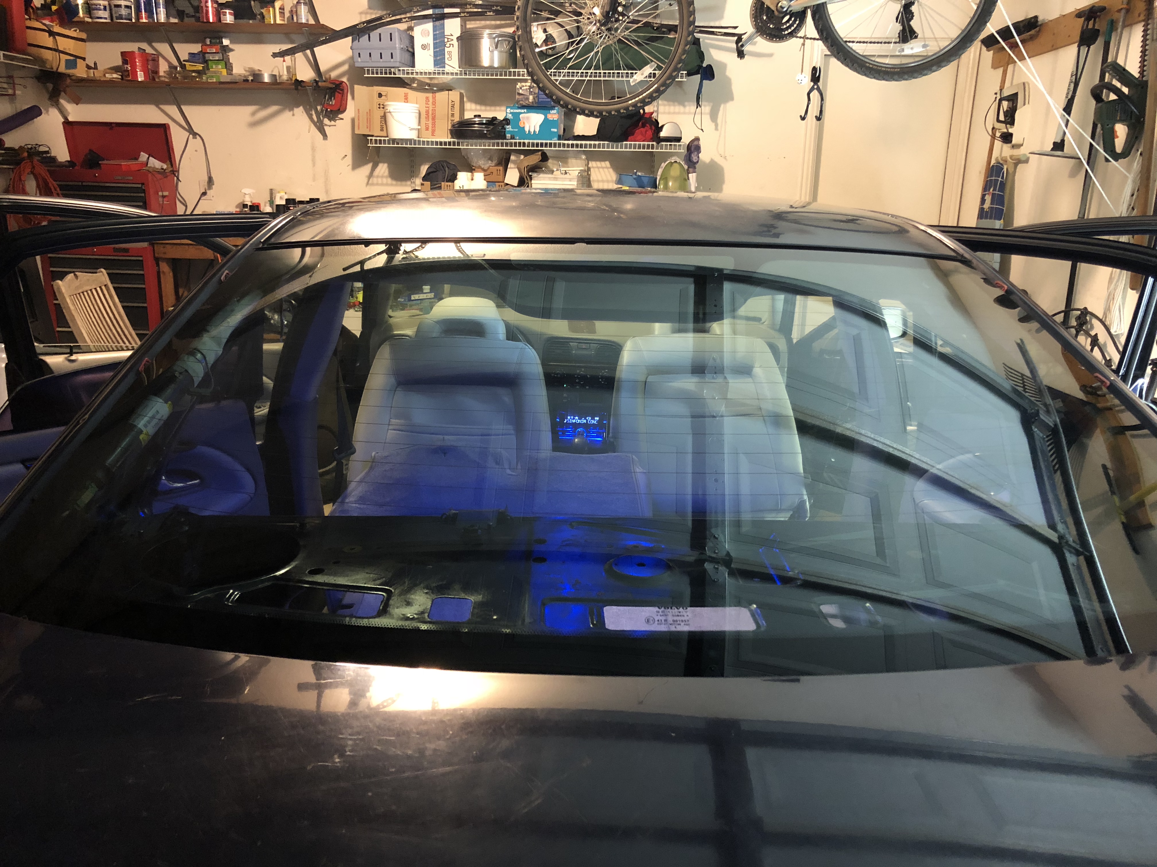

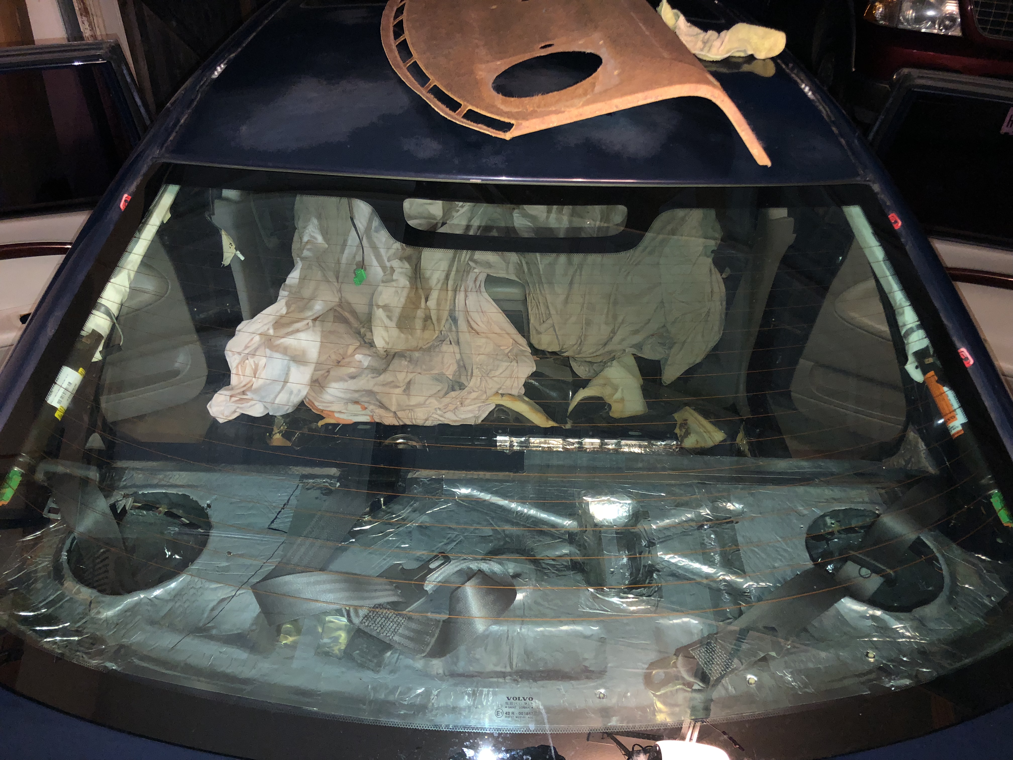

The car had some nasty purple tint that I wanted off. It was so bad a few shops told me not to even try and they would charge me out the ass if I made them do it. So I did it myself and it turned out badass. Currently playing with tinting, I put new tin on the quarter glass a few nights ago, seen in pic. Wish I had a pic of the rear glass but I don’t.

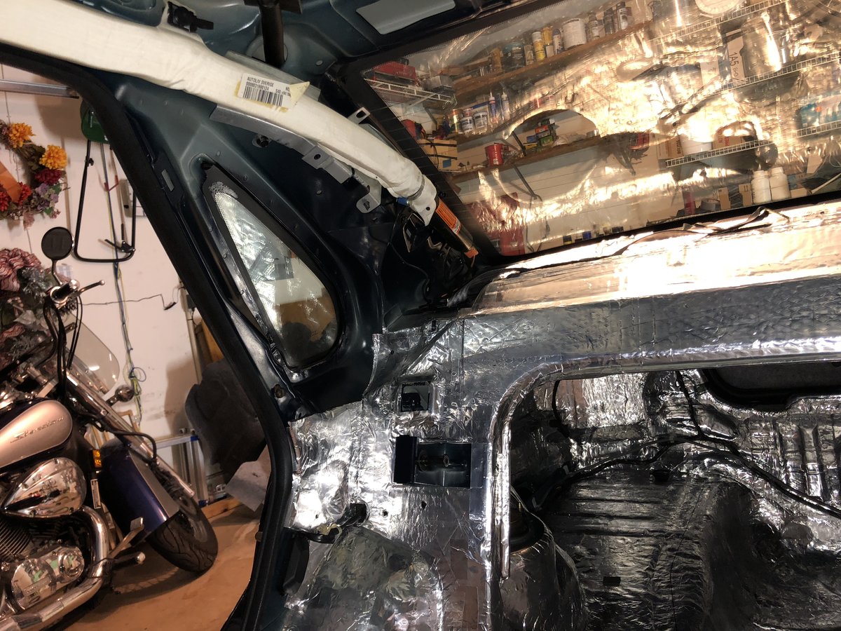

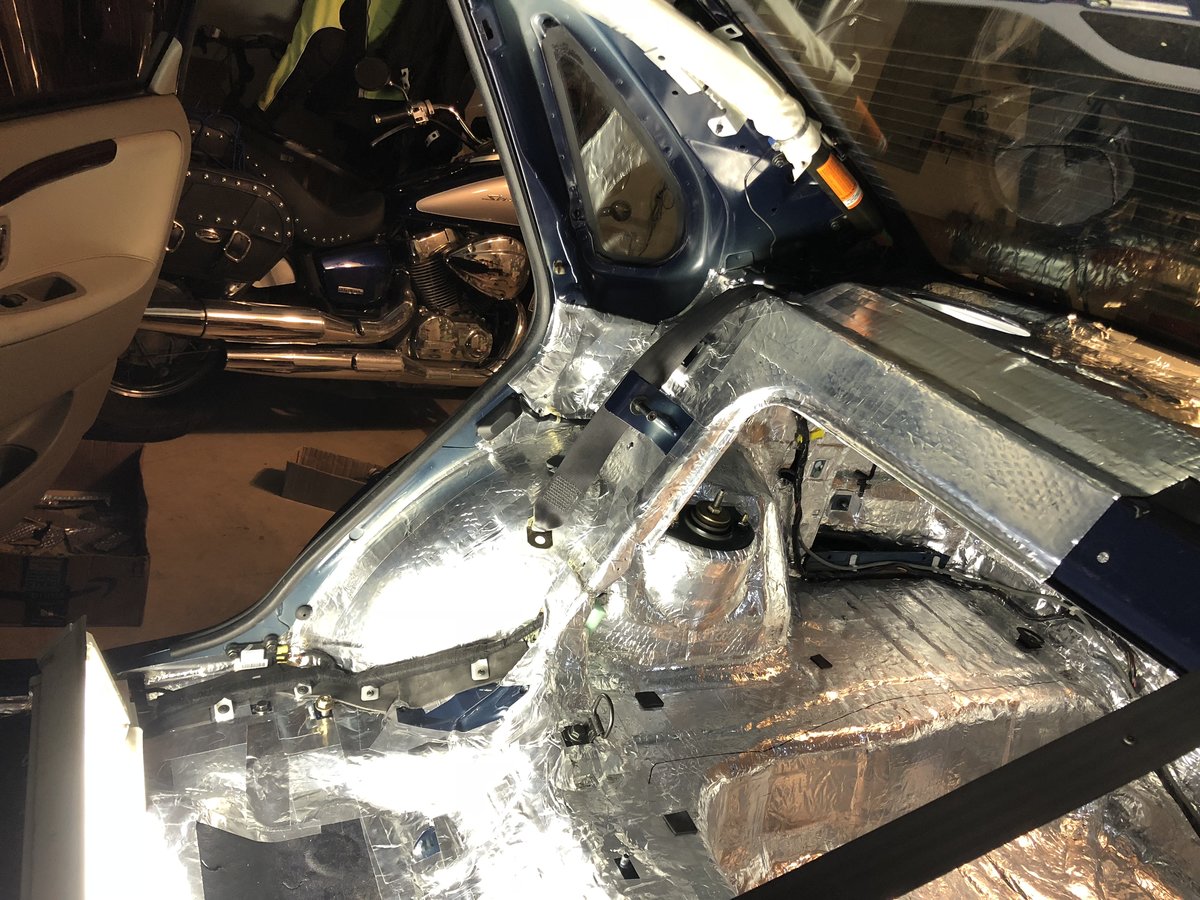

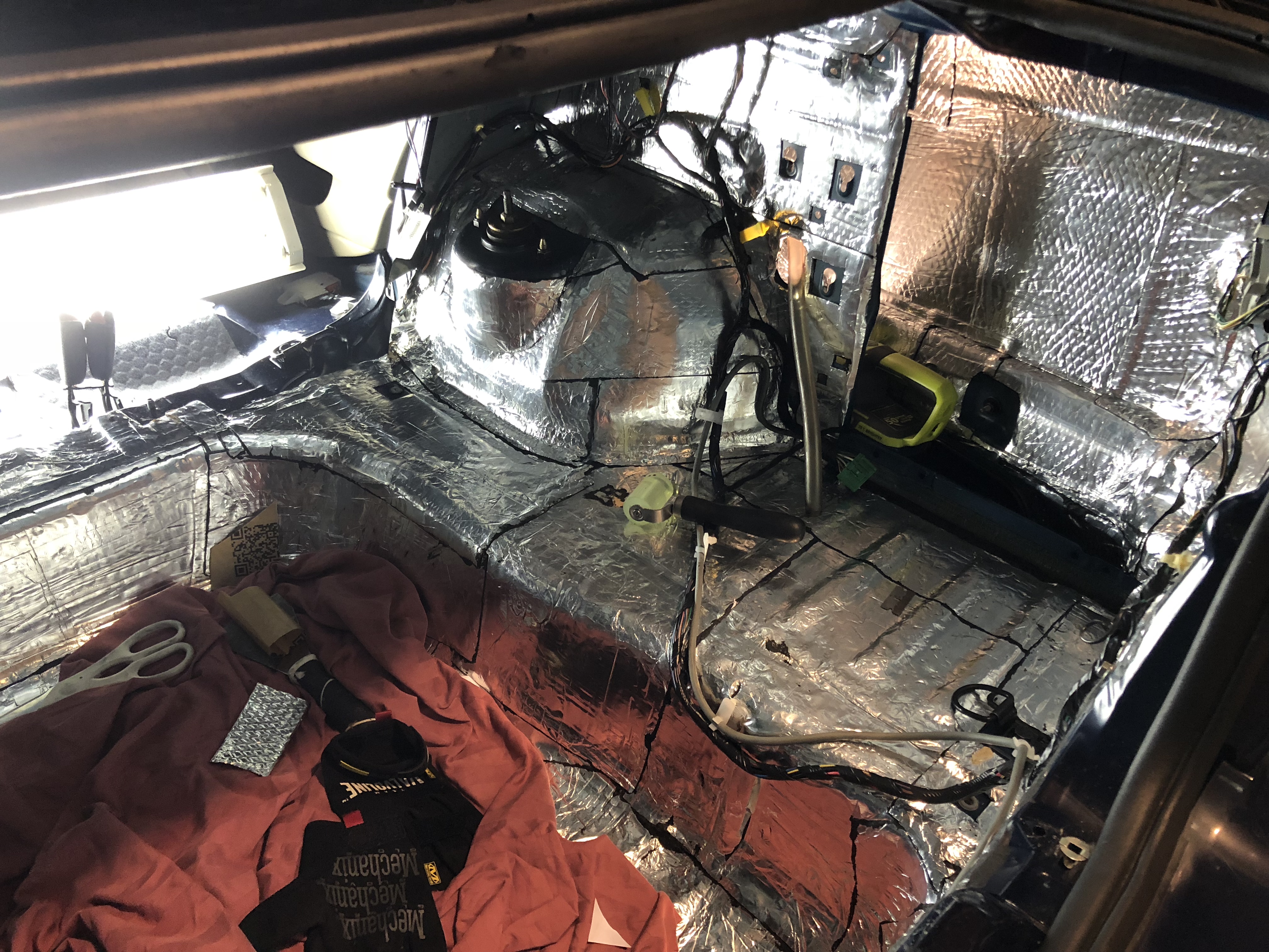

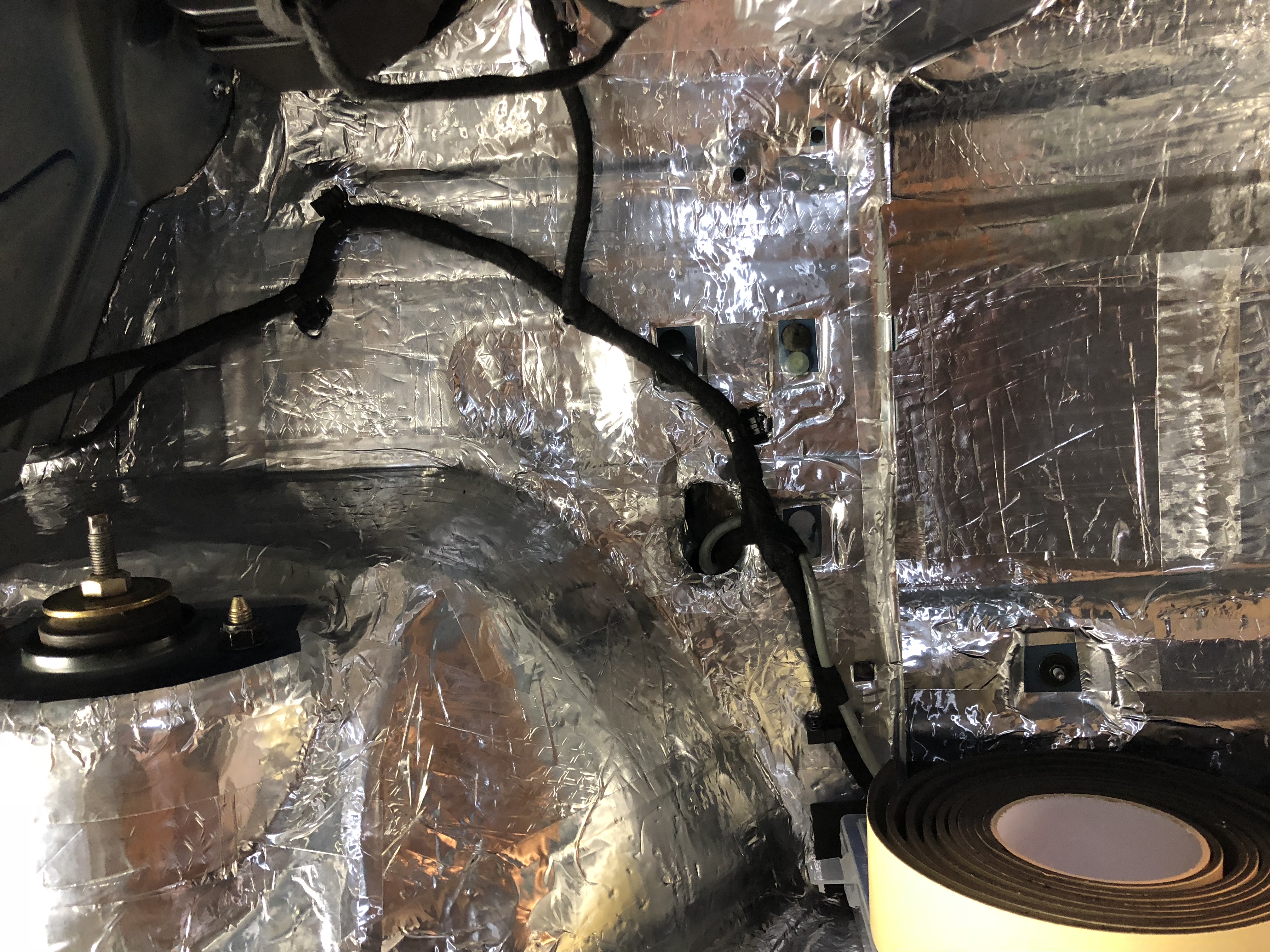

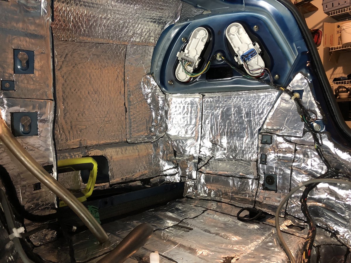

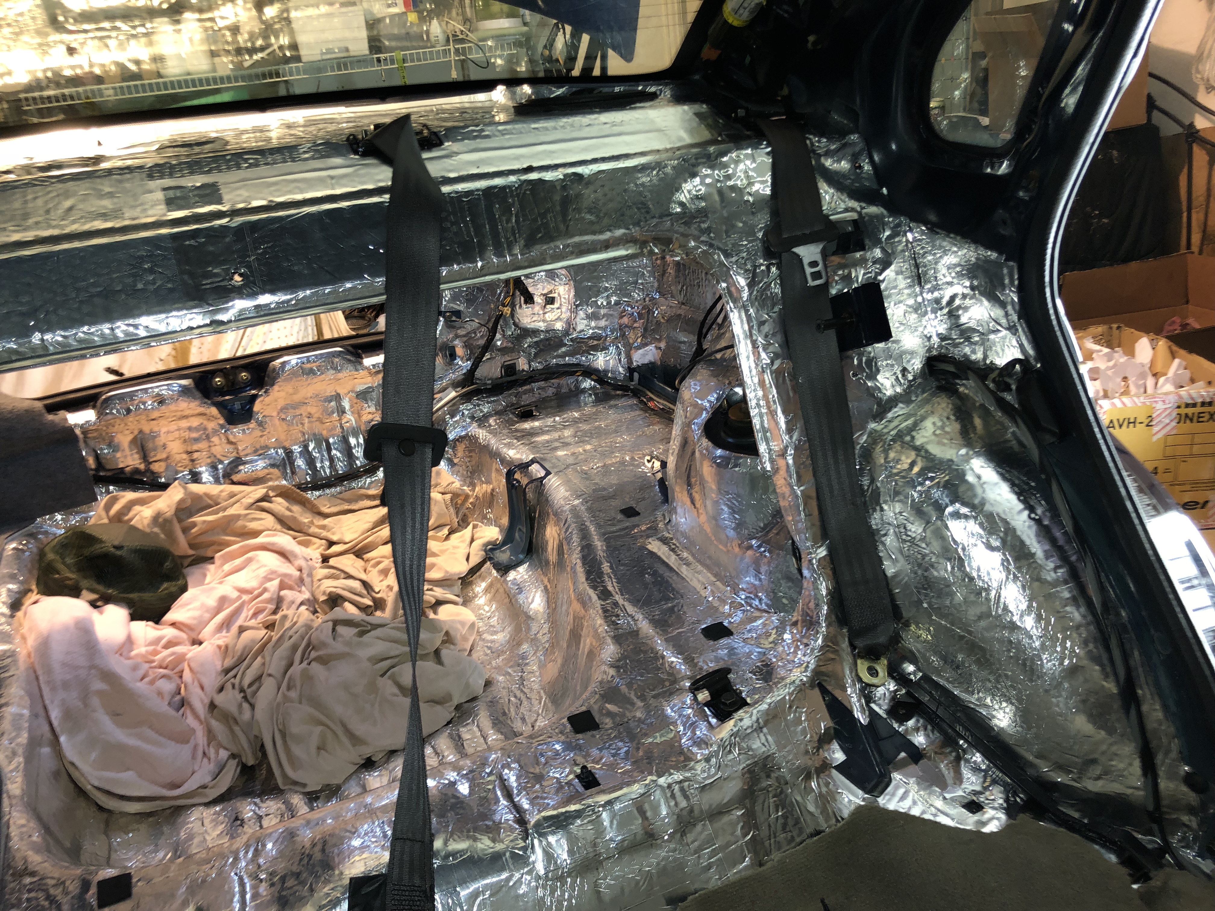

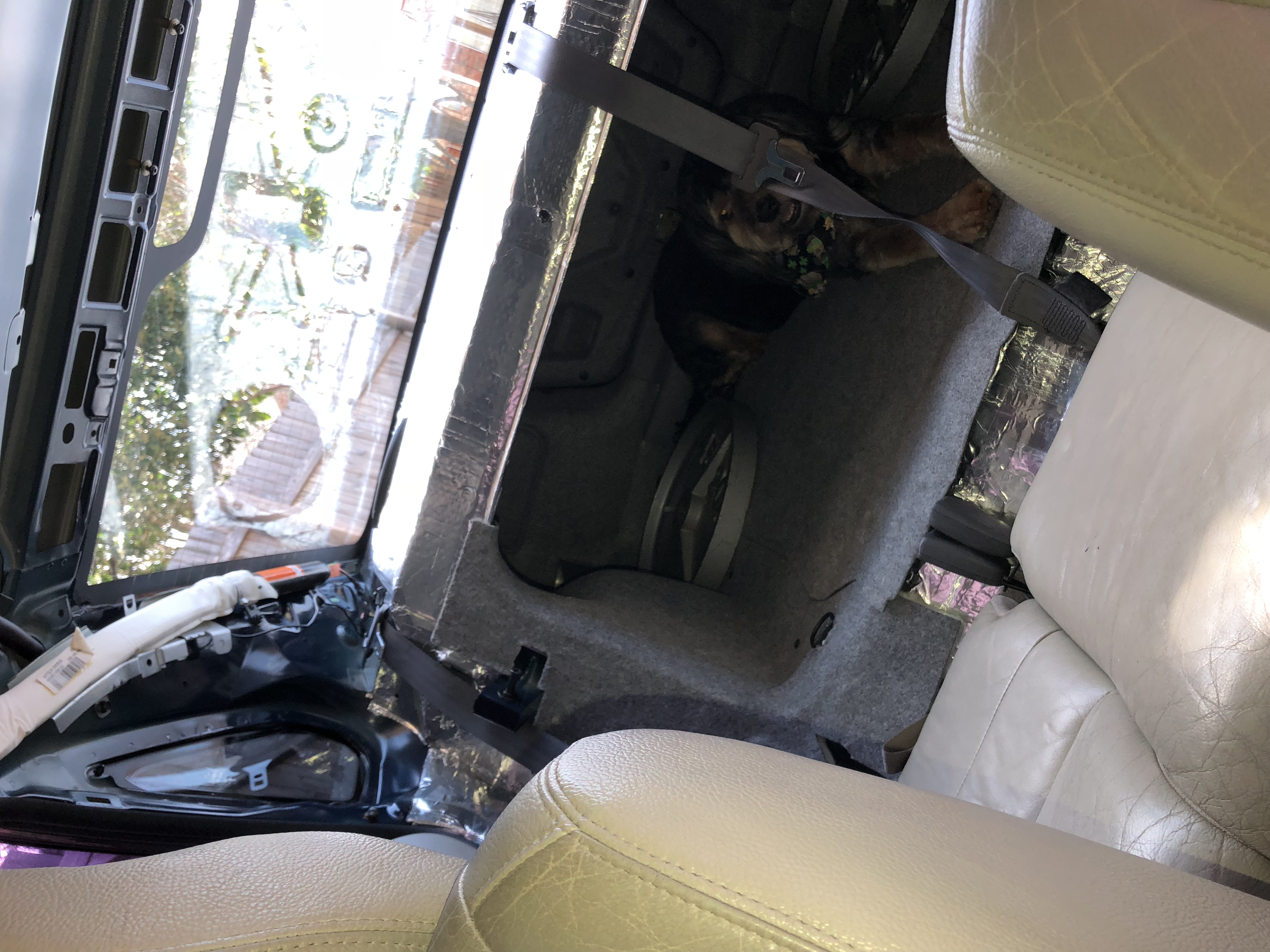

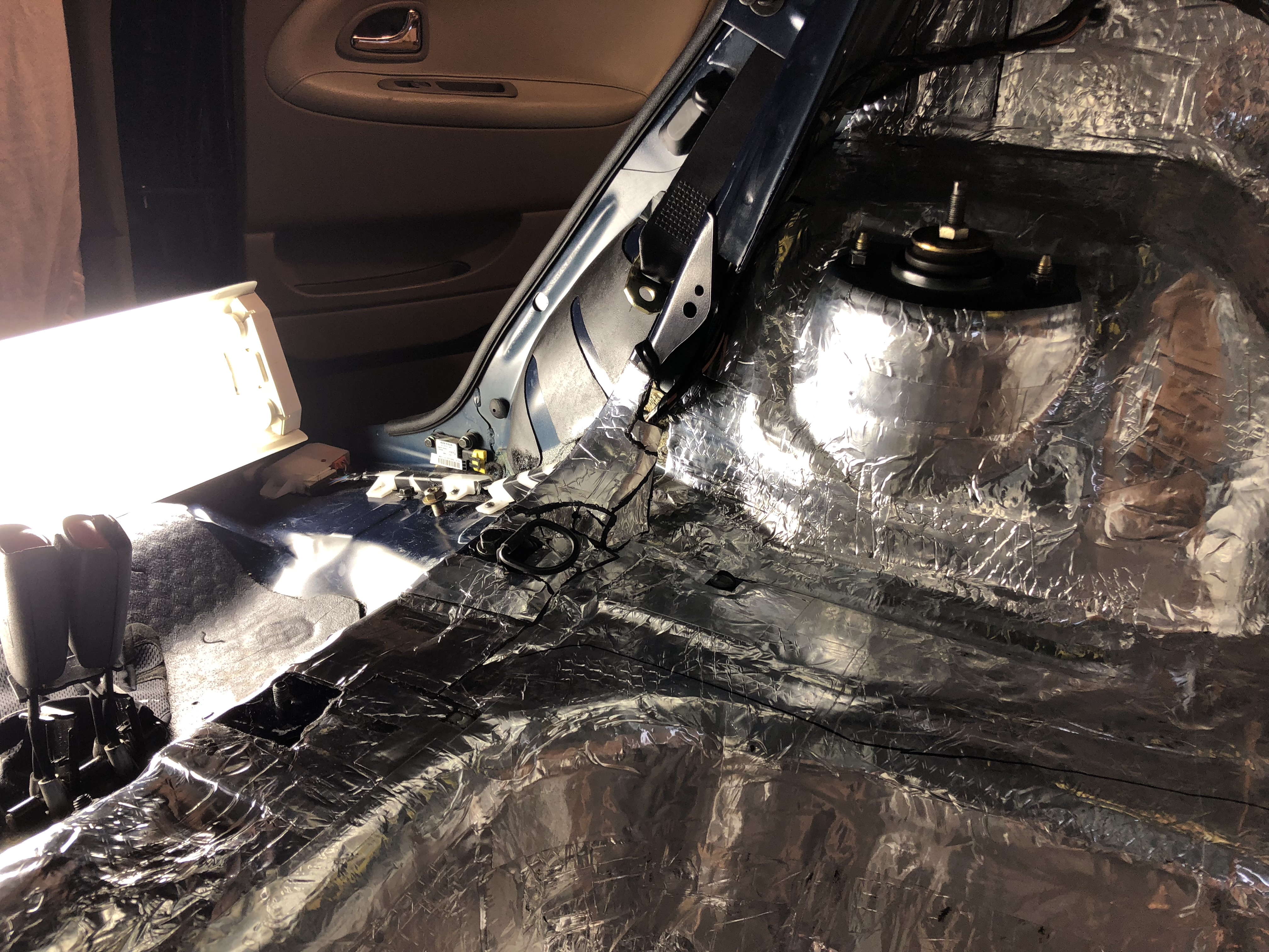

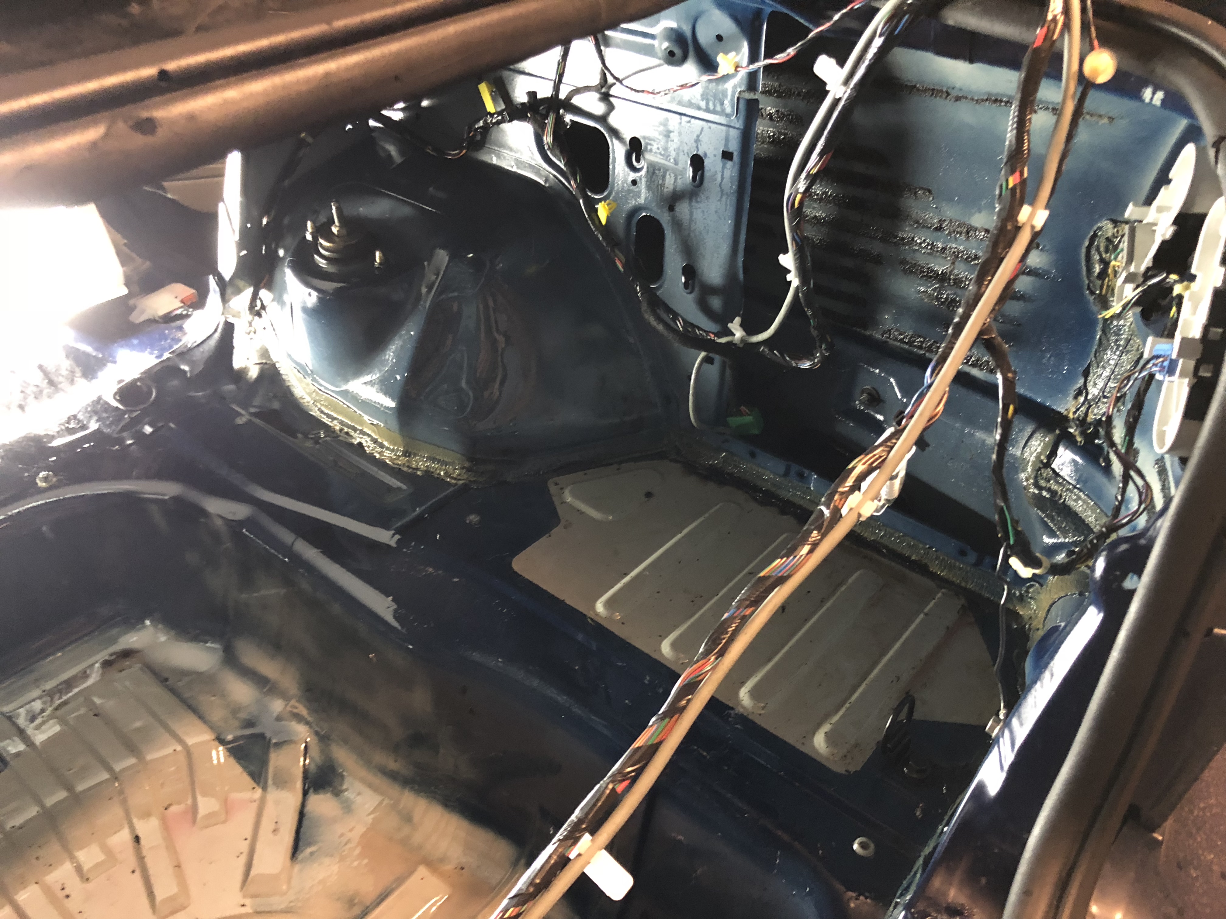

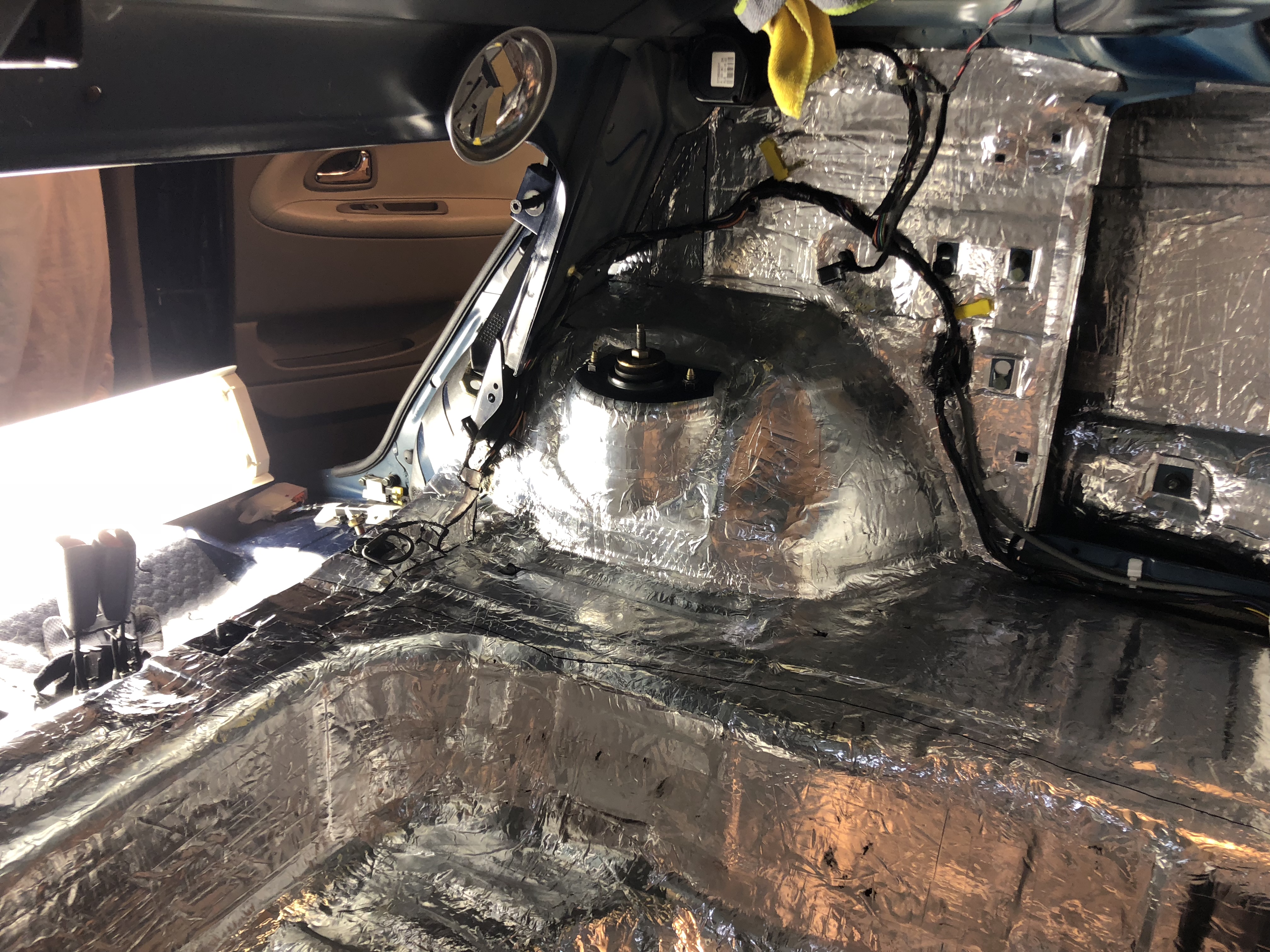

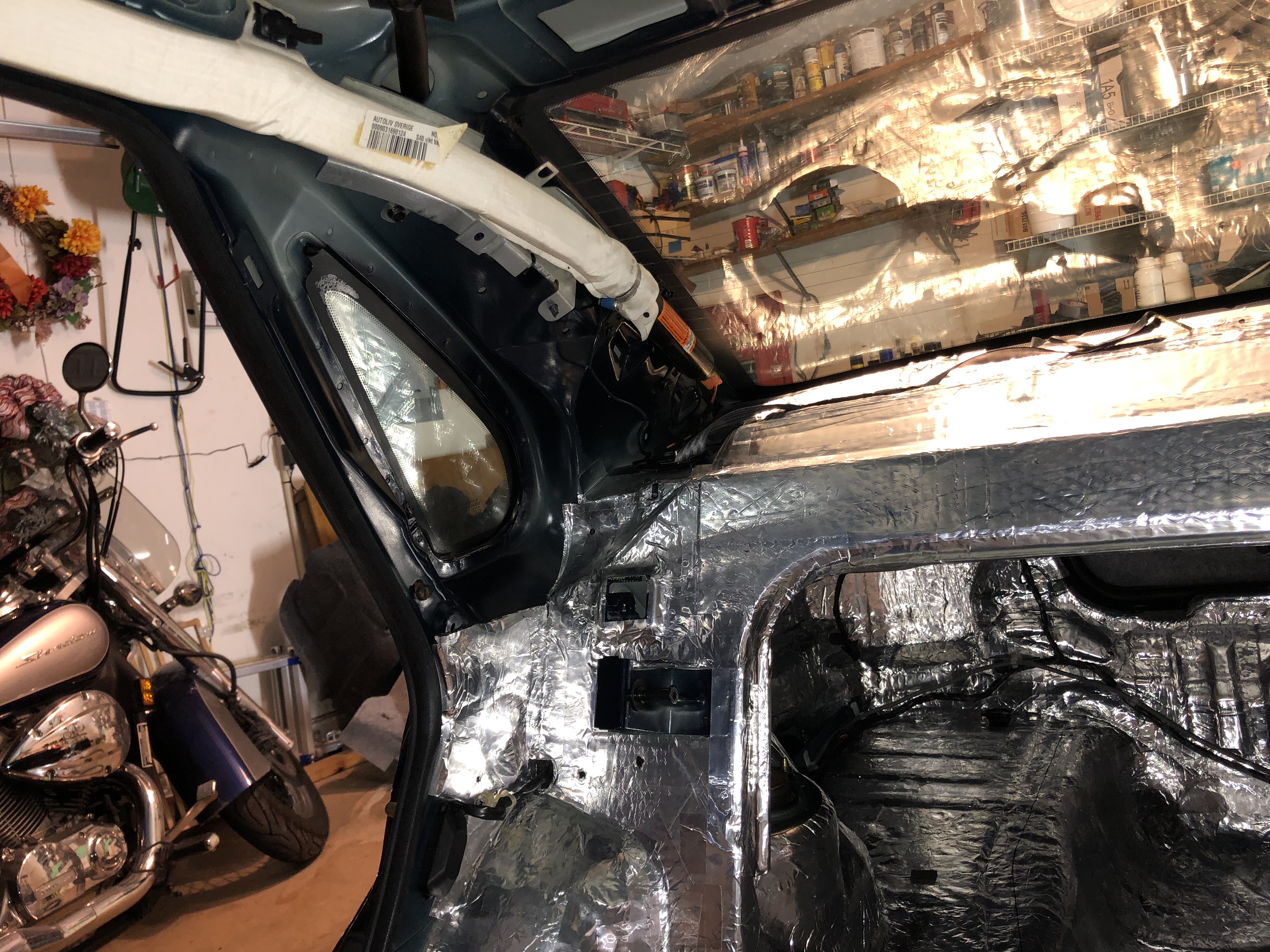

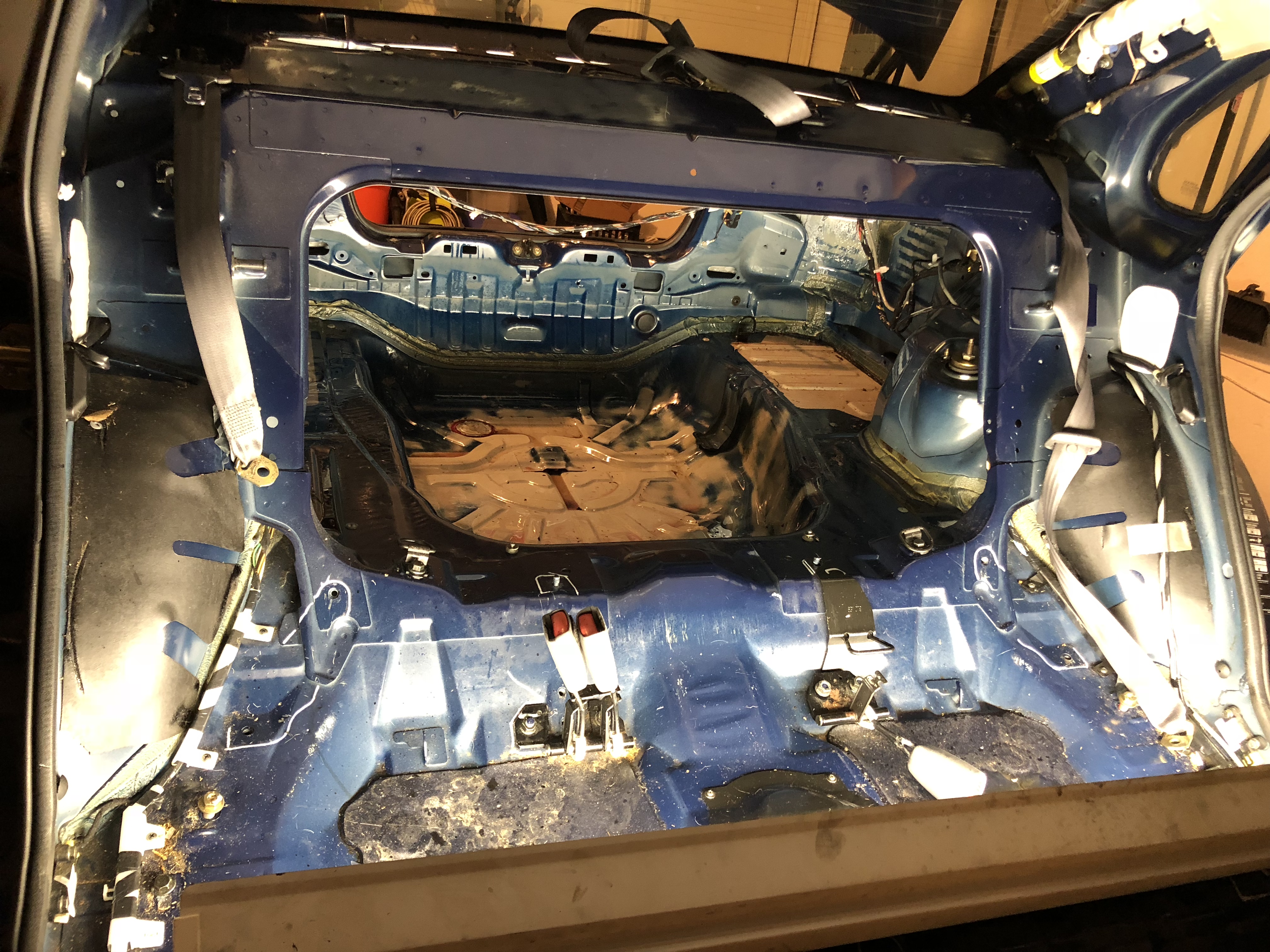

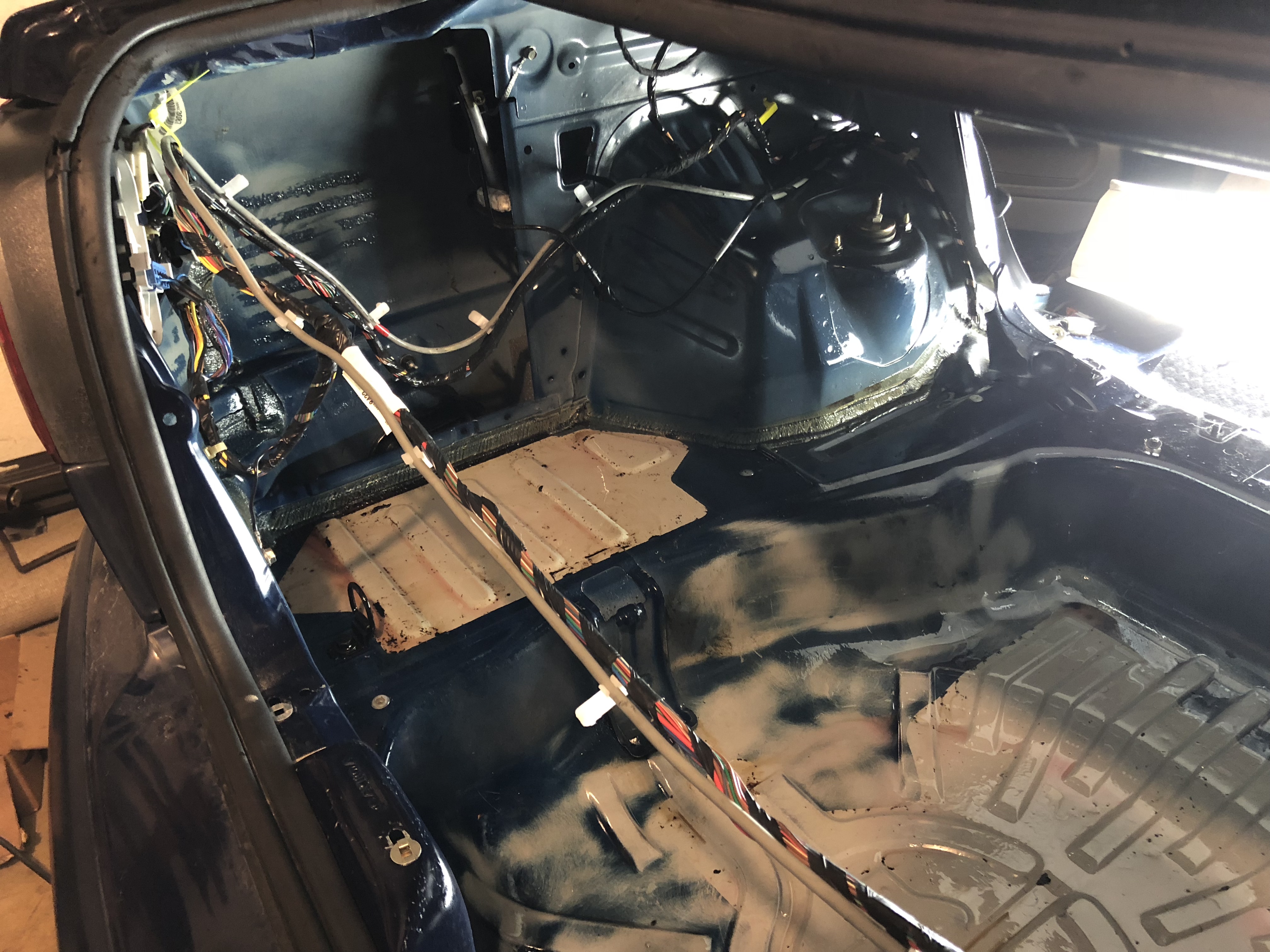

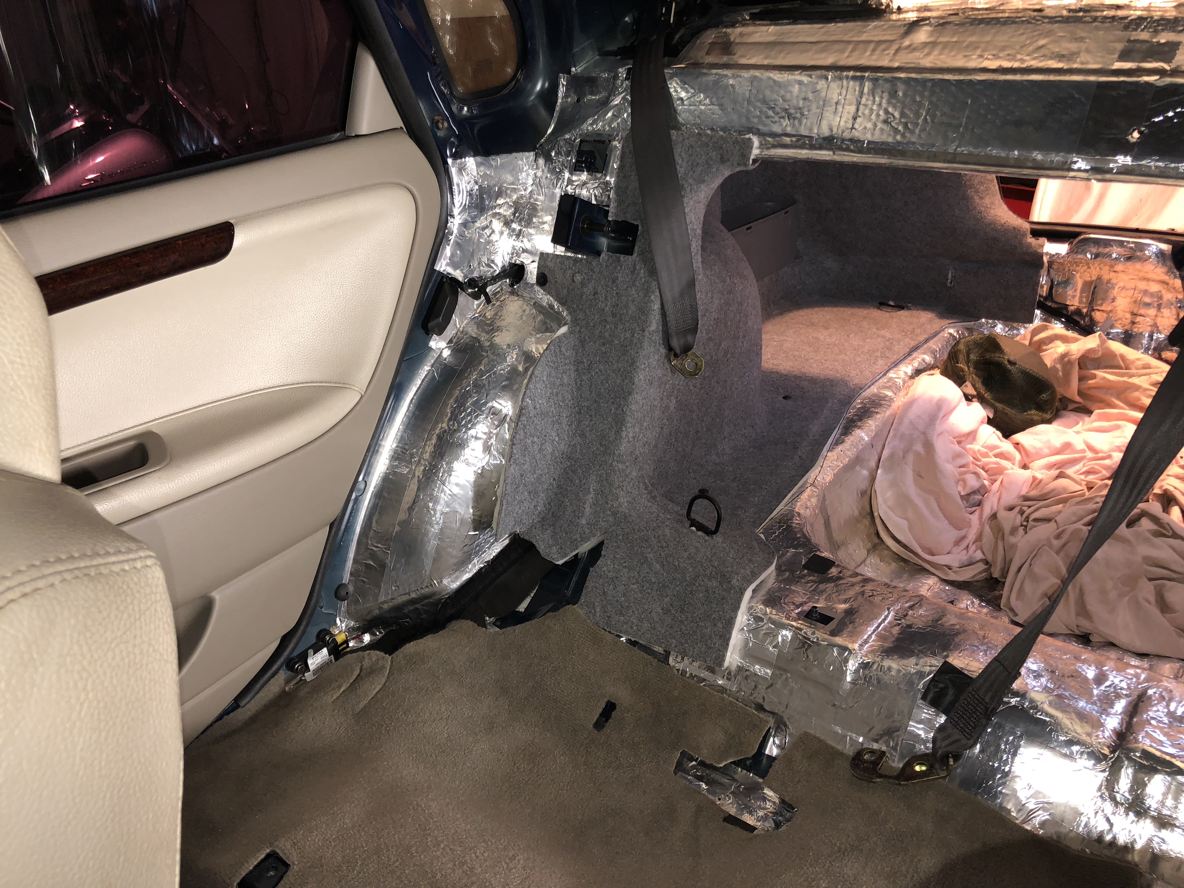

Next thing was to strip the entire rear end and deck to reupholster. I lined the panels with sound deadening material starting from the back to front. FYI this is by far the worst part of the build so far.

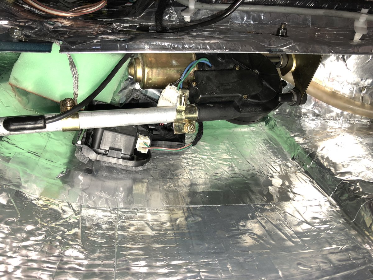

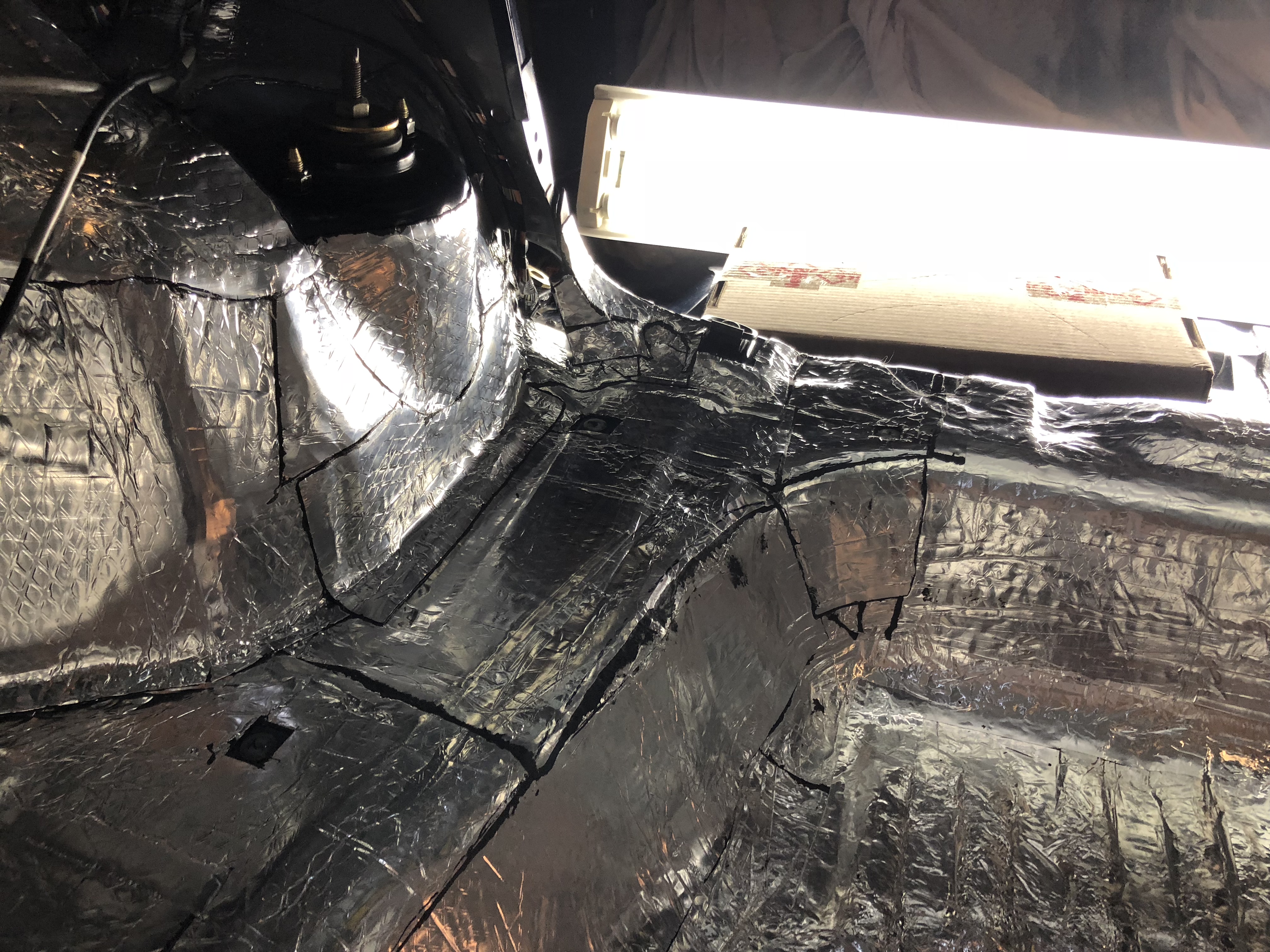

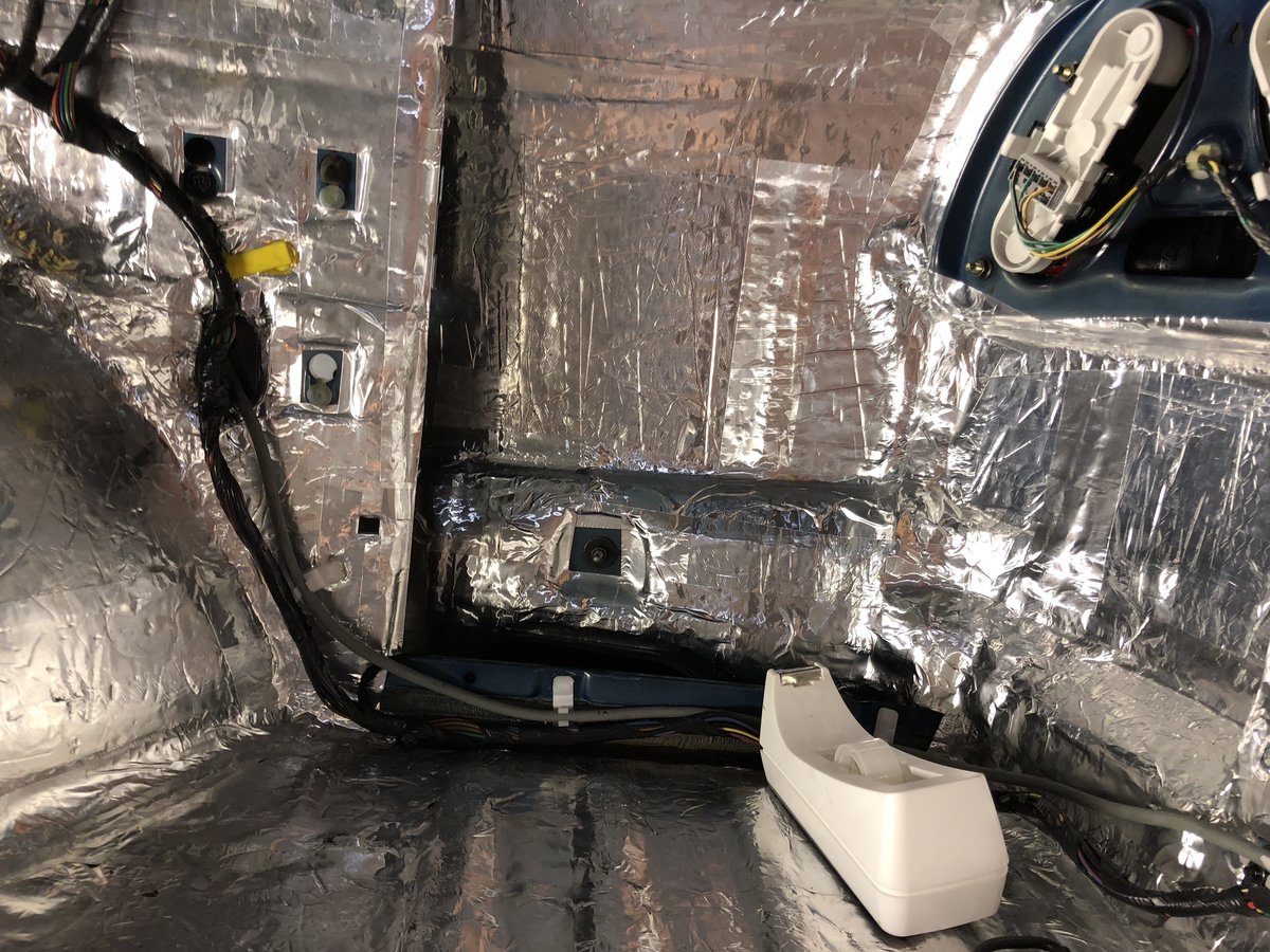

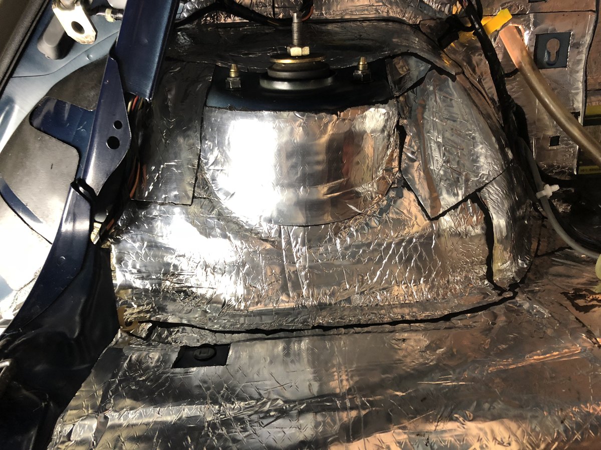

Lining the material is extremely time consuming, the cleaning process needs to be pretty perfect. HVAC tape is used over the edges to make everything nice and pretty. I got as much of the exterior panels as I could and also added foam to insulate more.
Cleaned up all the wiring with felt tape, replaced all harness clips, backed the trunk trim in 1/4” foam. Took the deadening rubber all the way up to the rear seats.

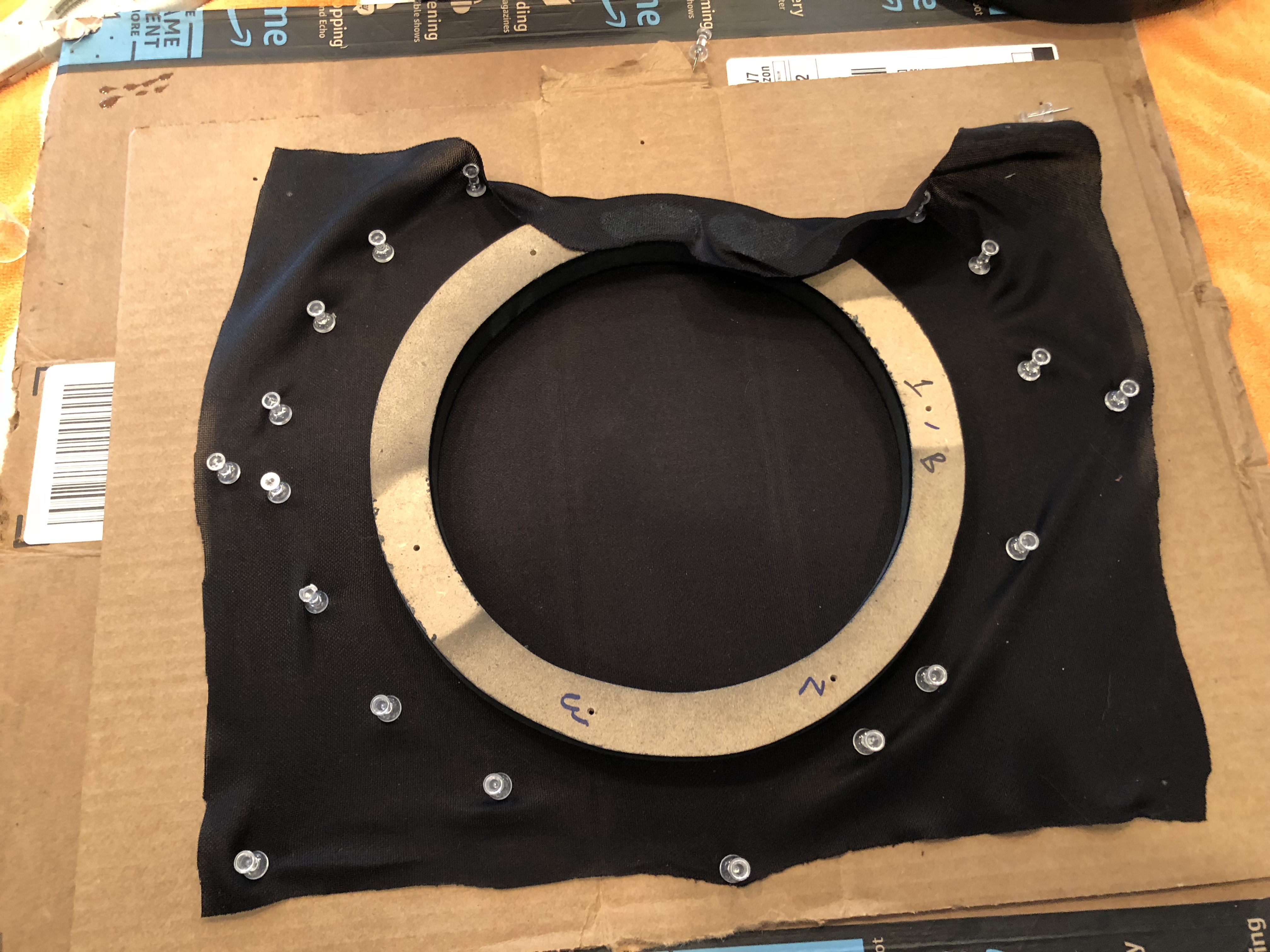

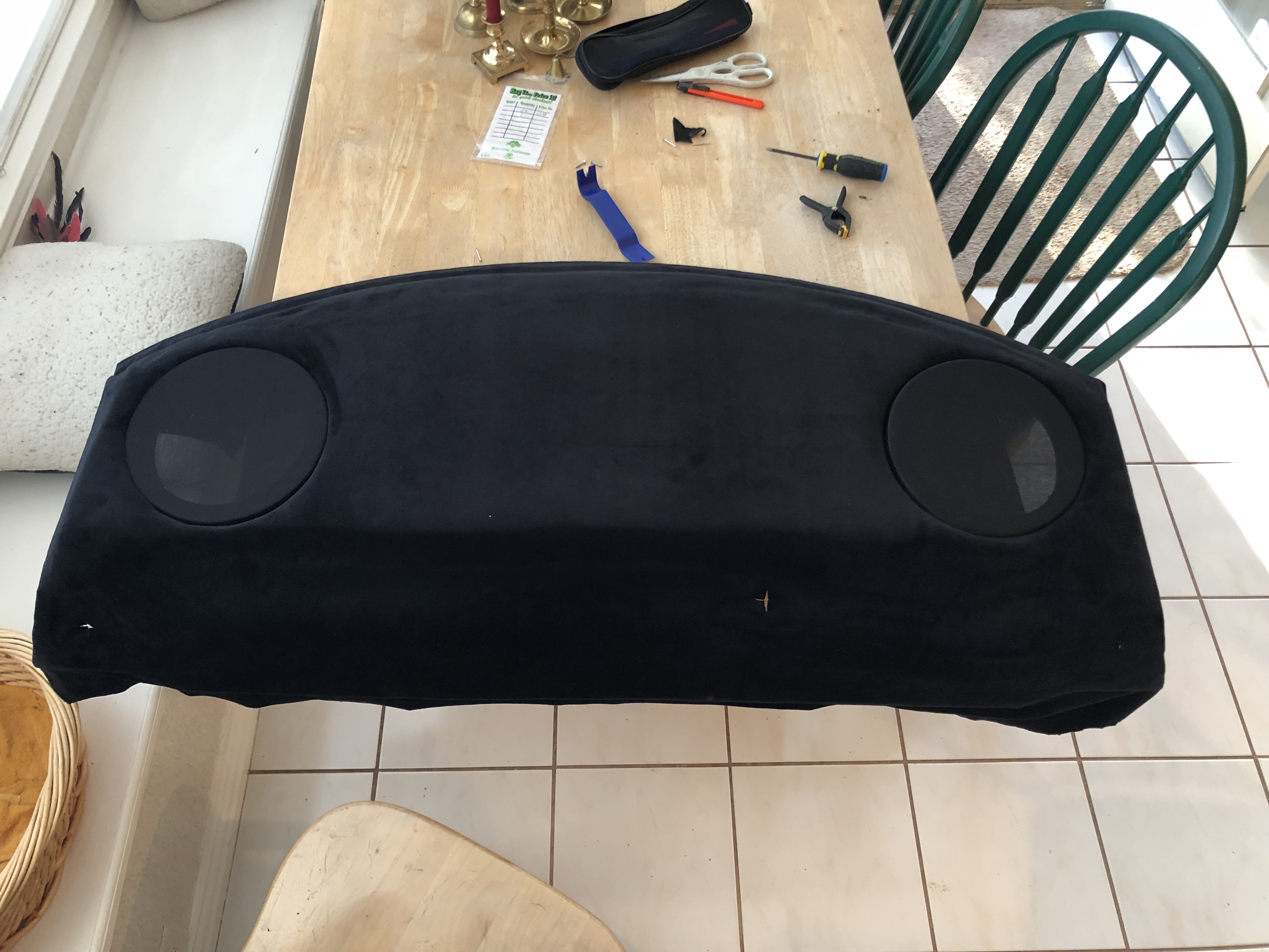

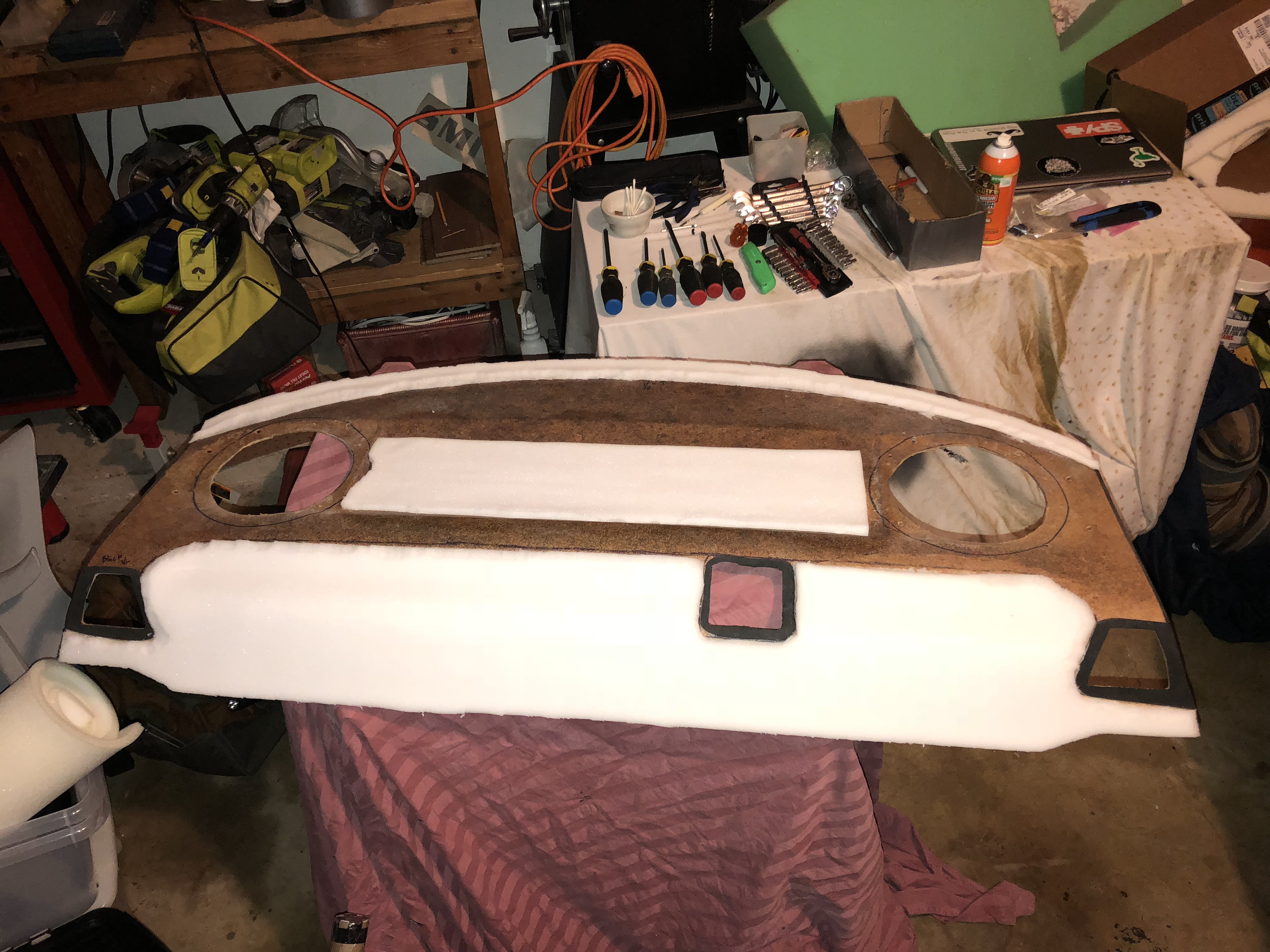

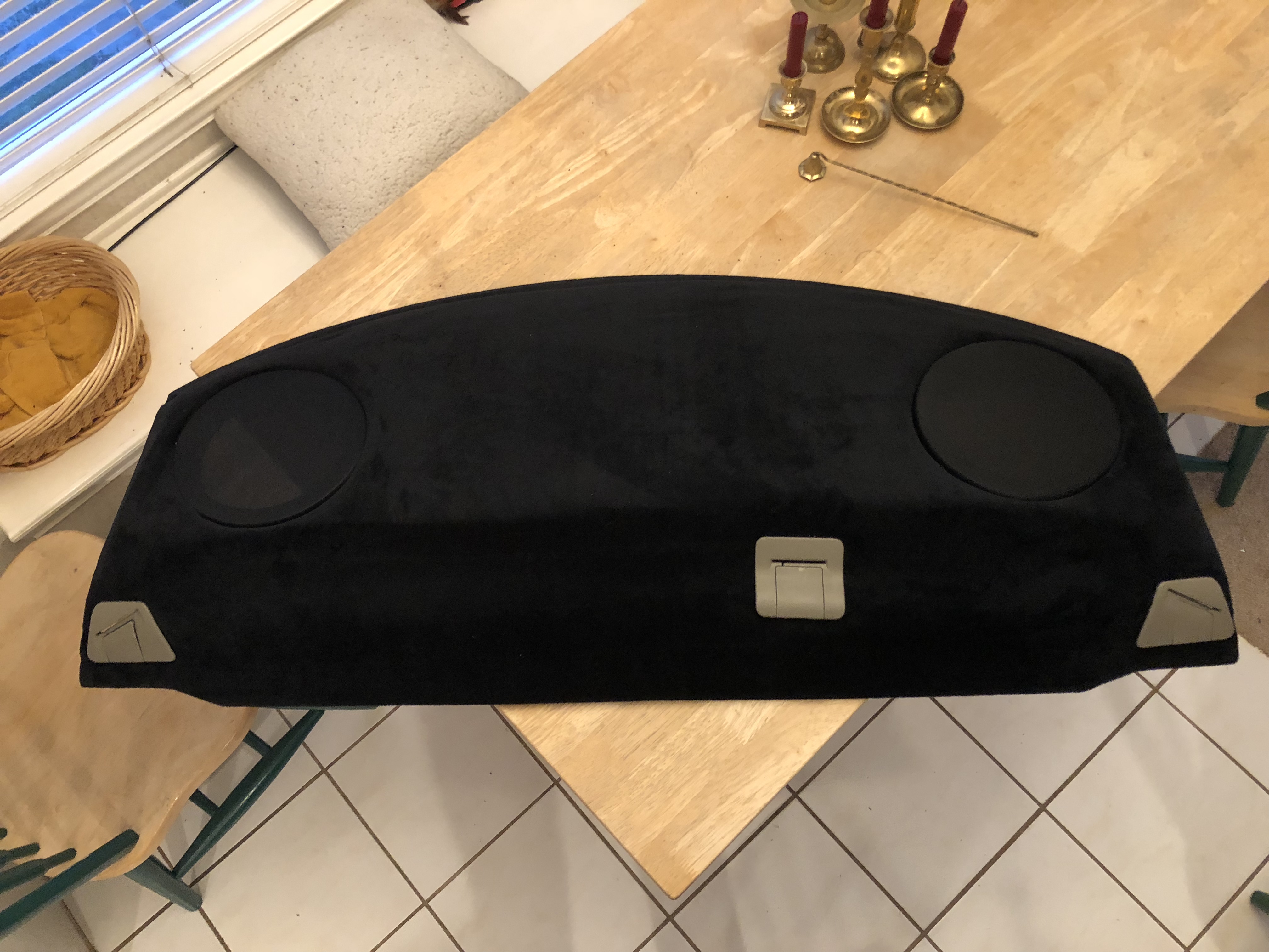

Will update more tomorrow. Currently almost finished with the rear deck upholstery and have installed the rear deck speakers. Had to mount the speakers pretty tricked out because the factory ones are very unique.

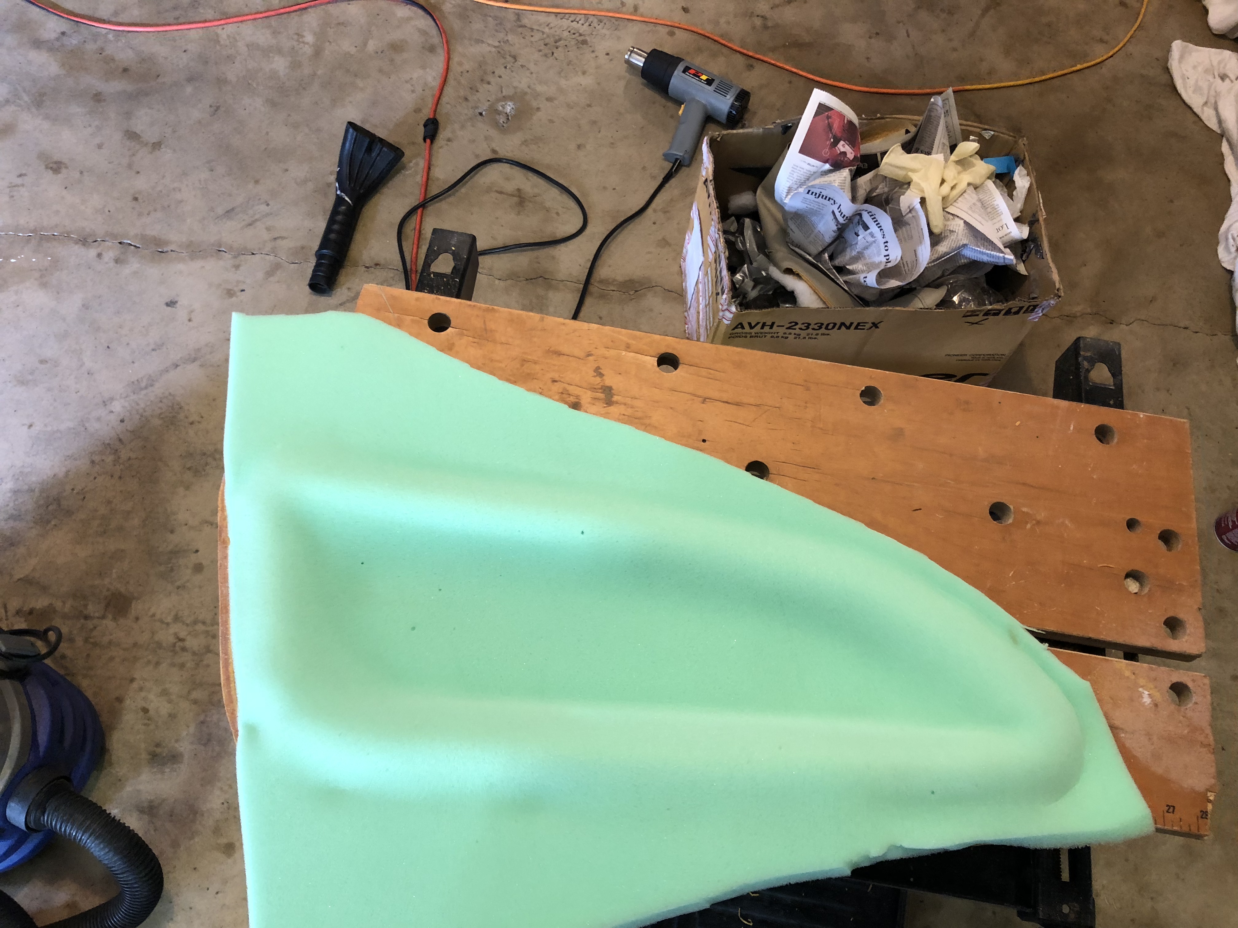

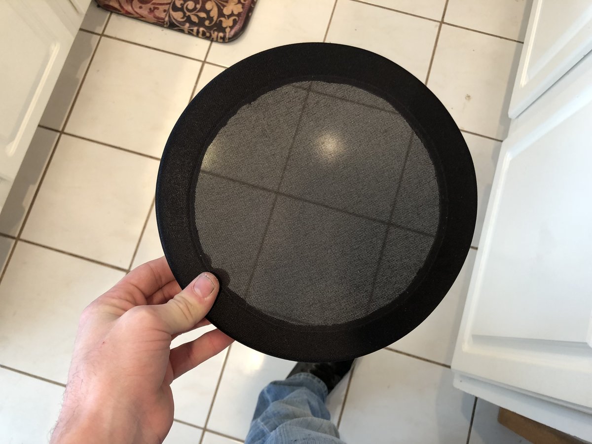

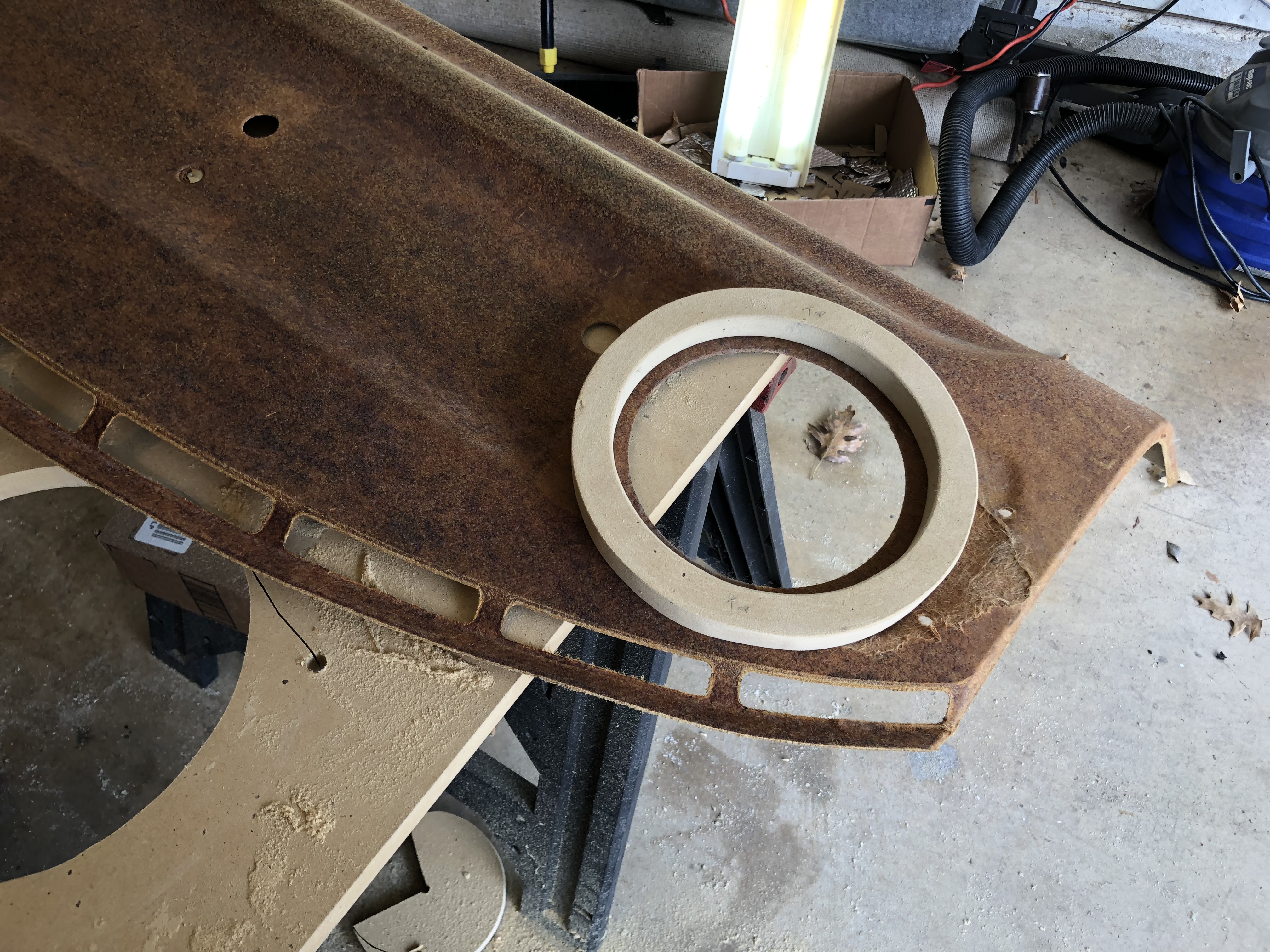

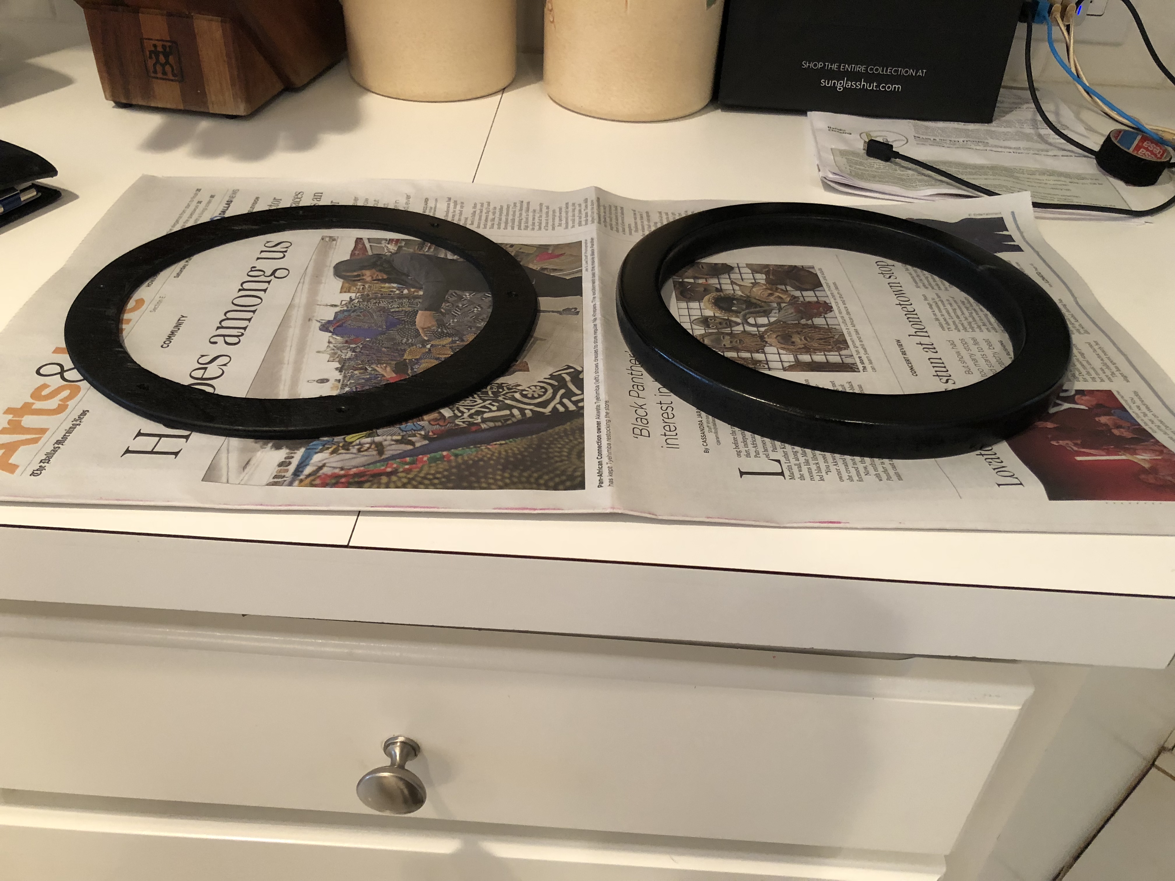

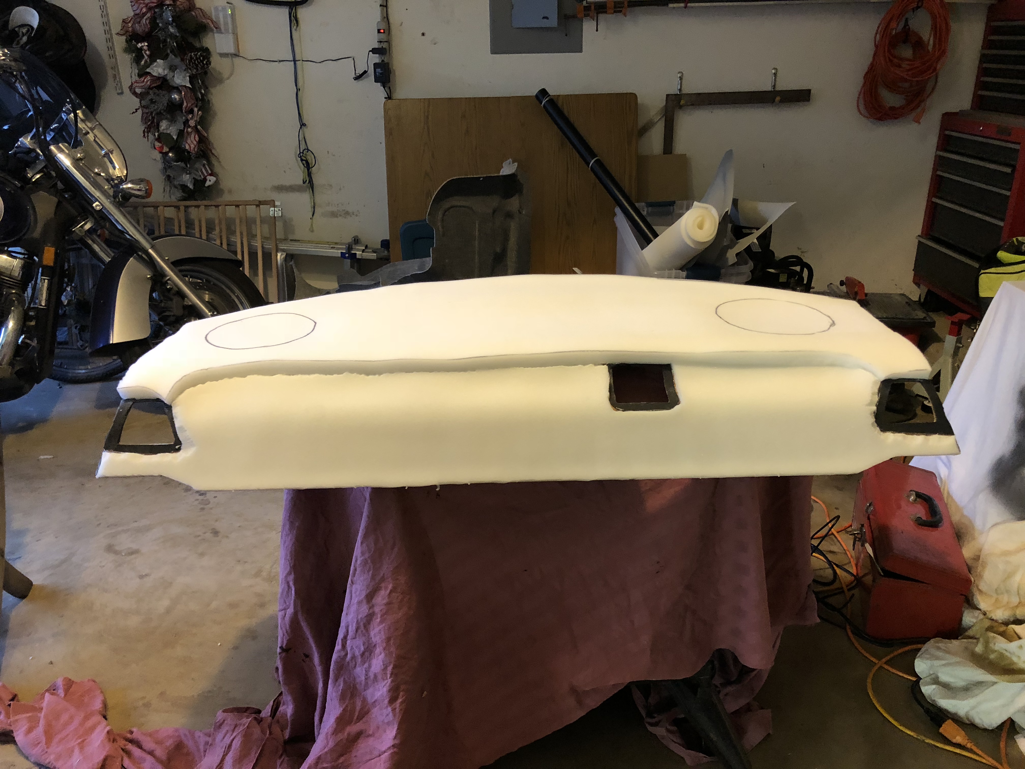

Finished lining the entire trunk and rear seating area and adding foam to the trunk covers. I’ll add more photos of that later, nothing too special. Here’s the fun stuff, I already have the headliner out waiting to upholster it. Here is what I did to the rear deck cover and custom speaker grills: Right now I am working on tinting the windows and installing the speakers/lining to the doors. More fun to come!

Nice work on the rear deck, my compliments. Just a thought. The rear seat armrest/cup holder can be turned into a nice speaker cabinet for a small sub or pair of small subs. Something on the DL. Think a pair of Focal 13WS or a pair of Kicker CWRT671. Bassbox pro can give you the right dimensions for the enclosure and port sizes - or go infinite baffle.
Quality sound doesn't need to be high decibel. And the way you have the car insulated, 100W/ch should be more than sufficient.
Something else to keep in mind: Alternators for these Volvos don't come in high current capacity. I know, I've looked. Adding 1 Farad capacitors can help augment the power grid, but charging them will take a toll on the battery/alternator.
What speakers are you using in the rear deck?
What material is covering the rear deck?

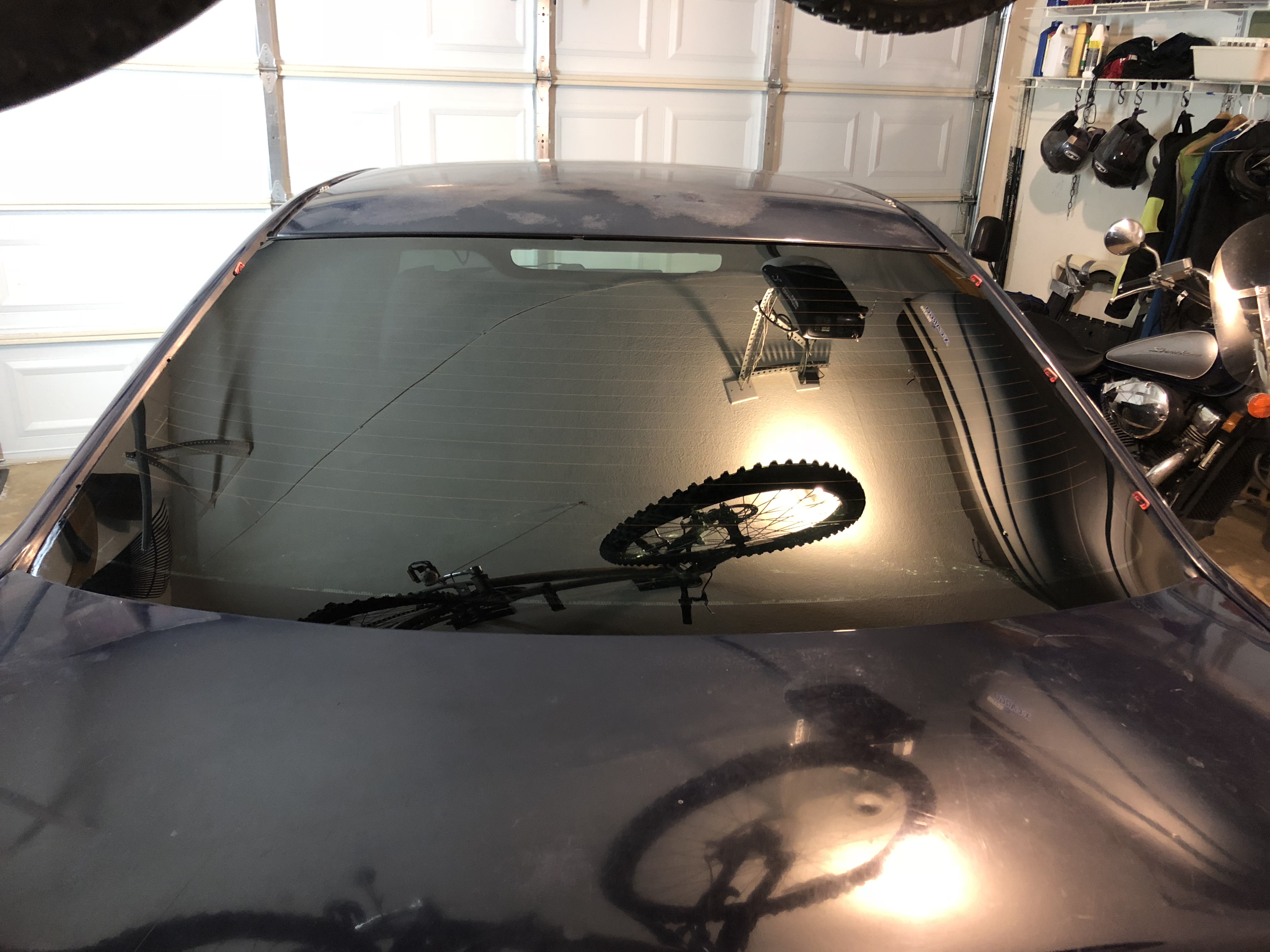

15% tint on rear - I ordered this with lexen and didn’t realize their tint comes with a blue (I say green) tint to it so they gave me a half refund and I will redo the rear this weekend.

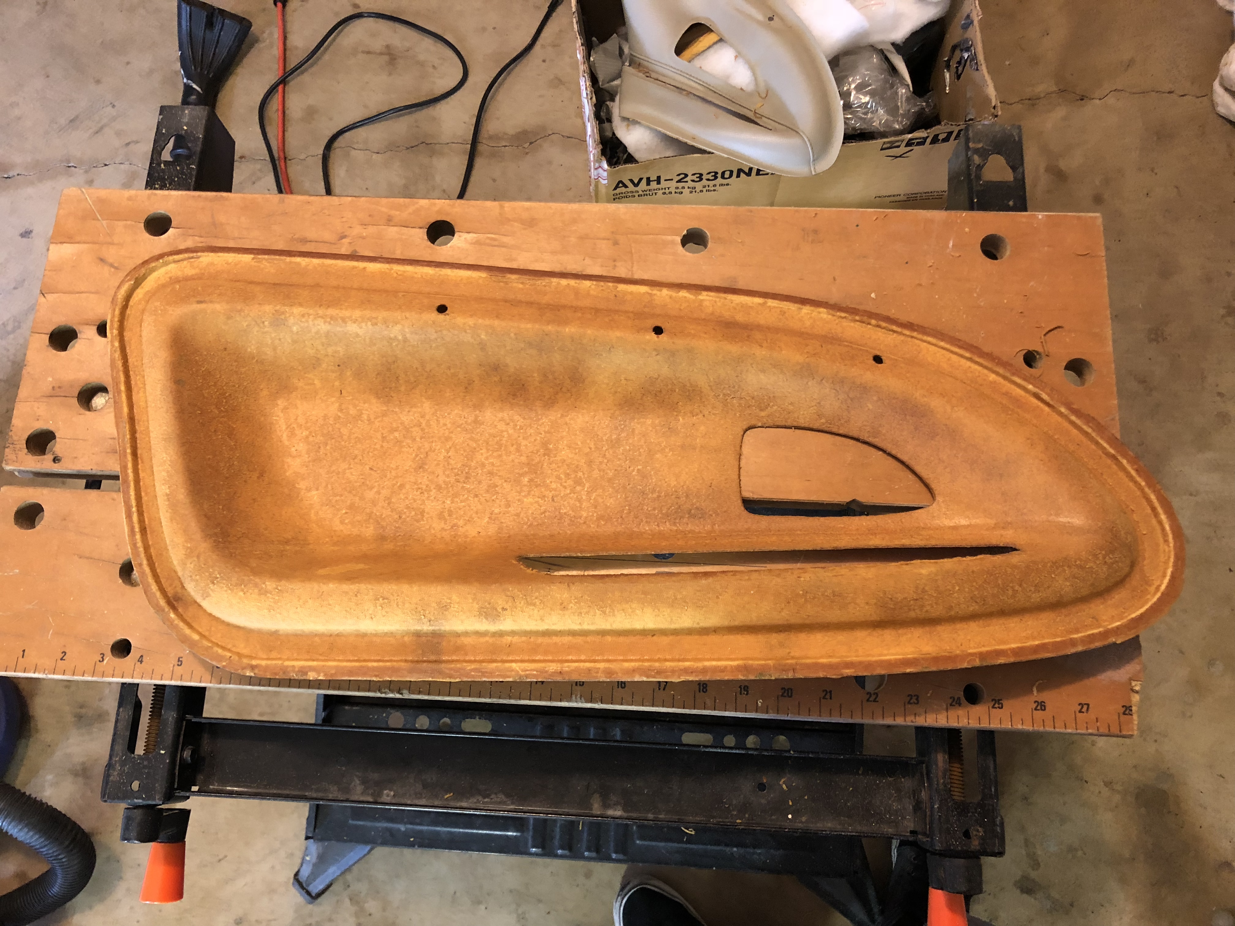

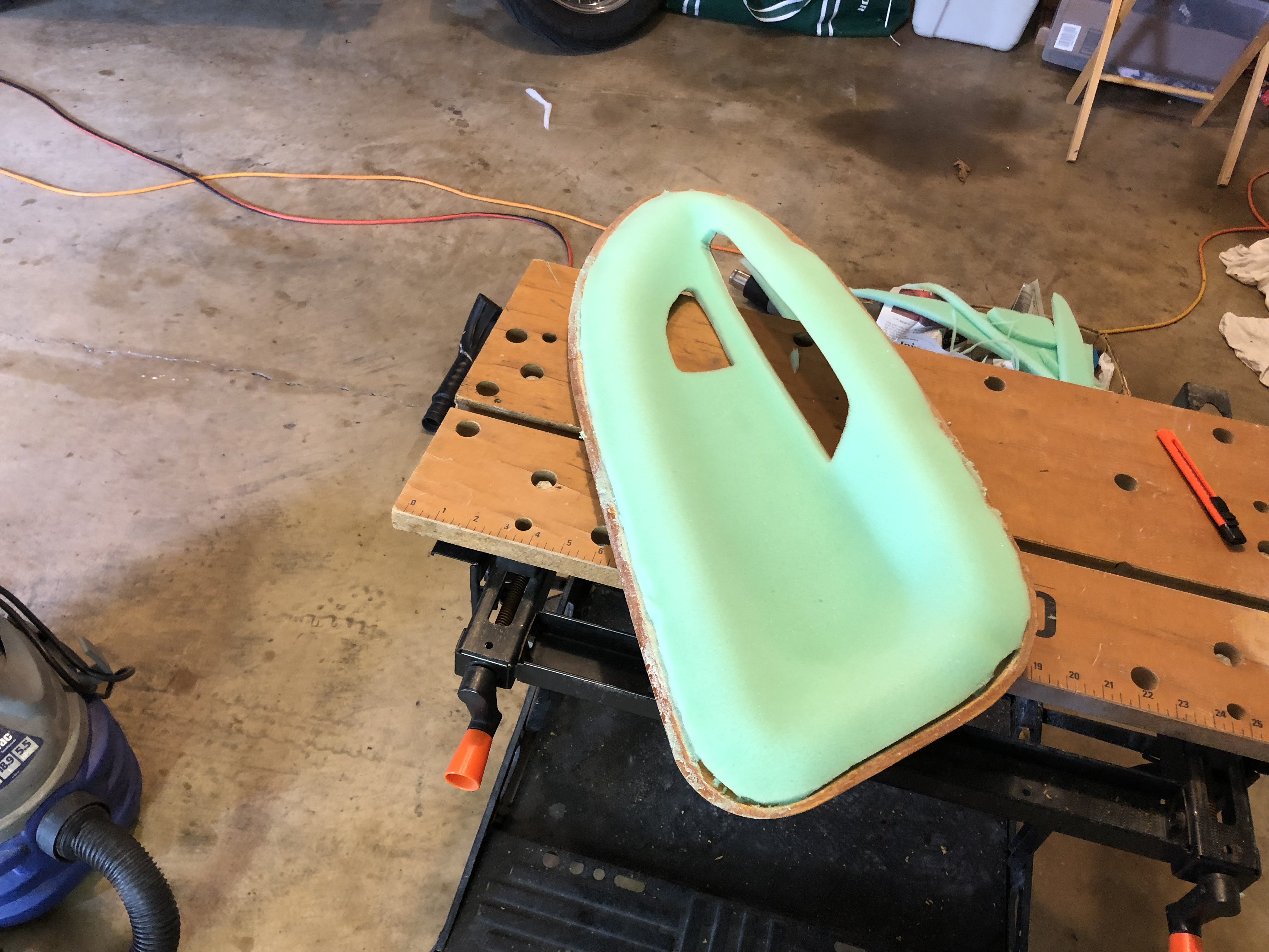

I have finished the front of the car and the rear deck but I’ll have to post pics later. I reupholstered the small door panel inserts with a brown suede fabric and painted my speaker covers back. Lined the exterior/interior door panels with more sound mat, gotta day I’m super impressed with how much this stuff can quiet your car from road noise.

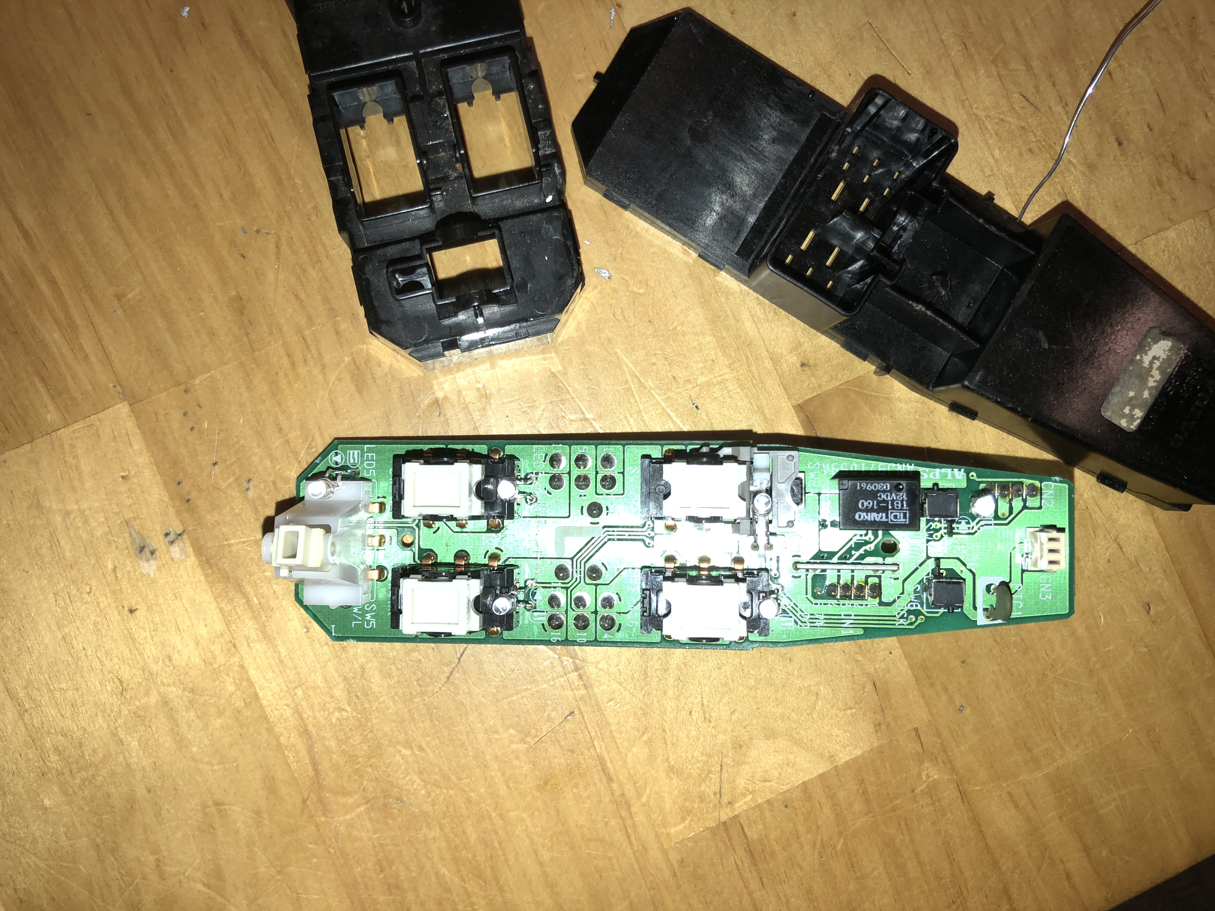

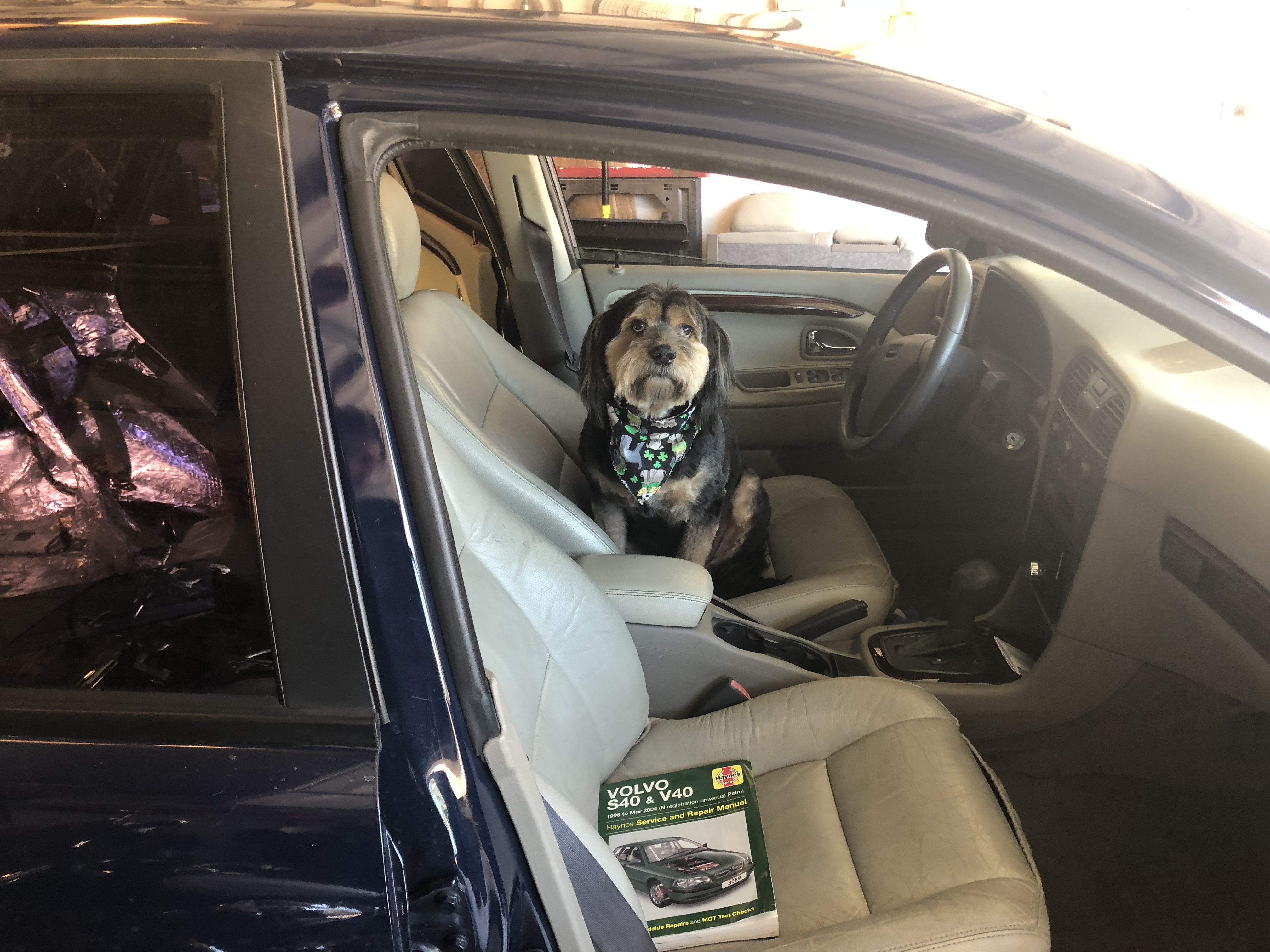

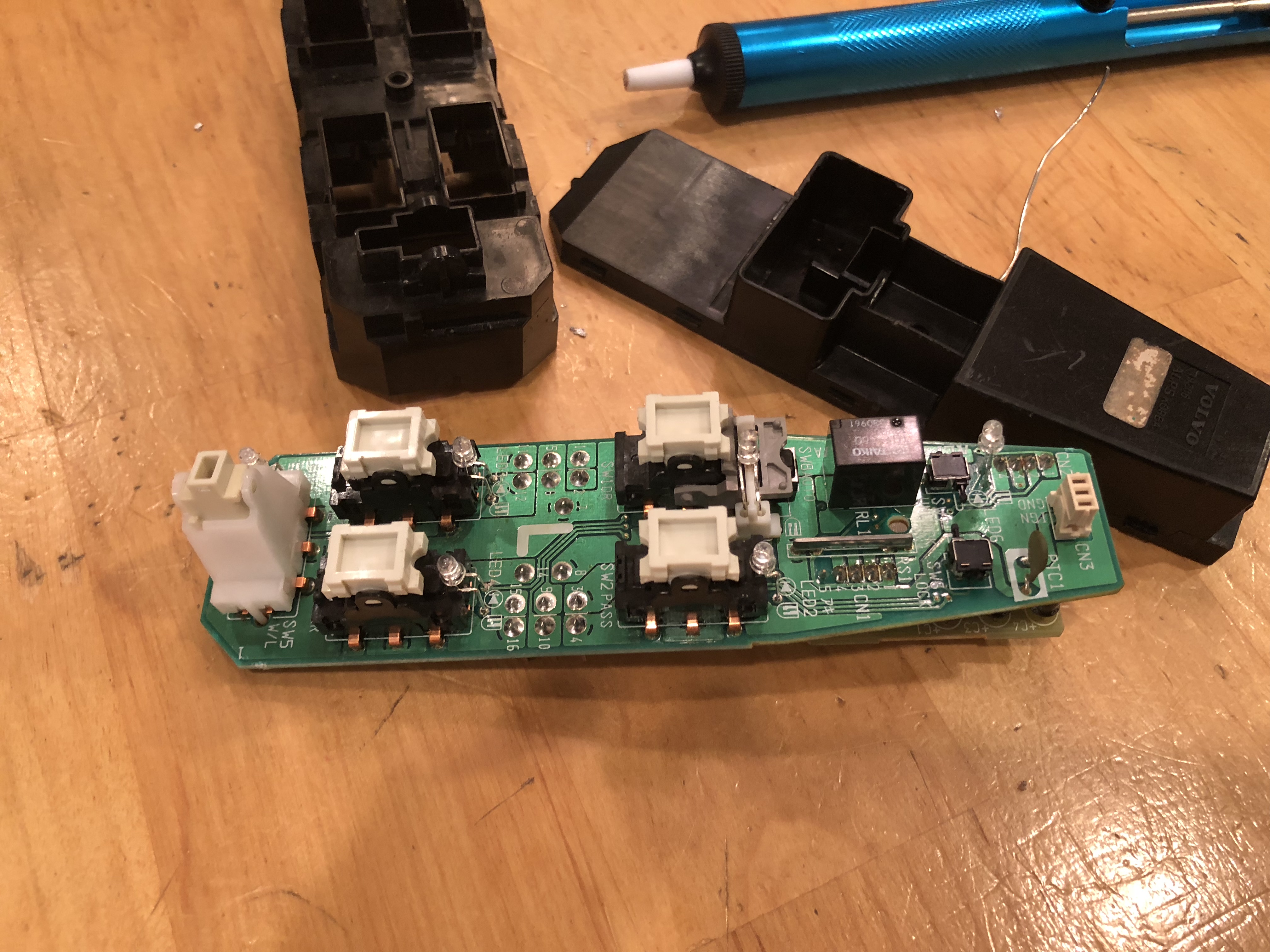

This is my “helper” I’ll take more pics but I replaced all of the door control LEDS, tedious but worth it. I promise to take more updated pics, here is the rear window tint I installed, and half of the progress of a door panel. JL Audio XD400 4x2 amp to be installed this weekend!
