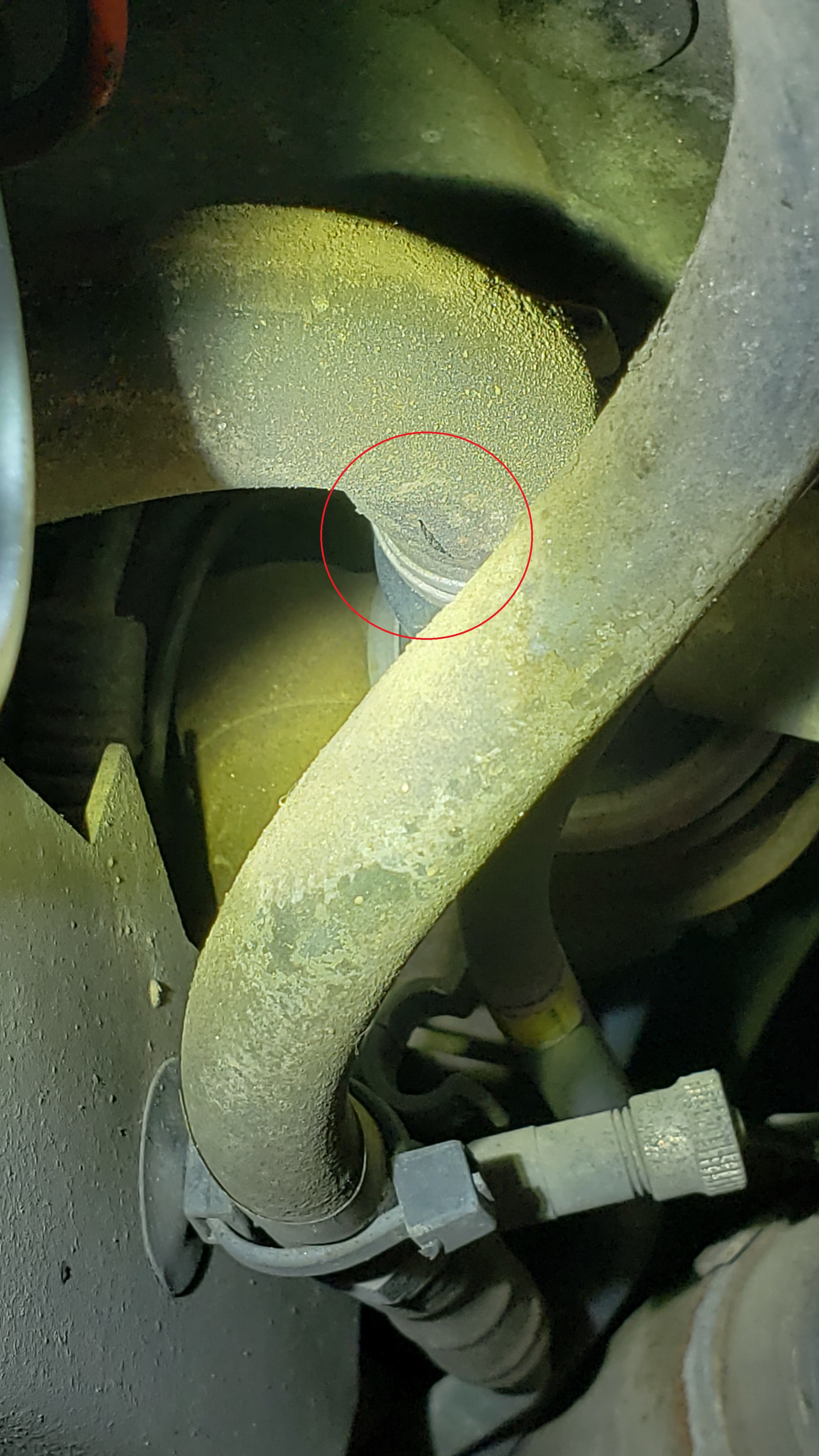

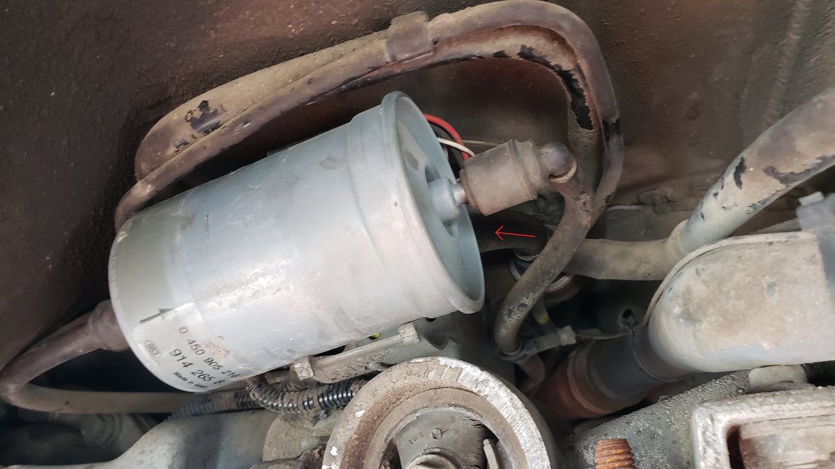

So I think I found the source of my P0442 "Evap Leak (Small)". Cracked hose going to charcoal canister... my only question for anyone who's done this on a 98-2000 V70XC is... how the **** do you get to this thing?
The one side pictured shouldn't be too bad, but the other side seems impossible. If I removed the fuel filter, there's still the big filter bracket in the way and I don't see a way to remove it. I felt one bolt at the top (very difficult to reach) but can't tell if there are more buried back there.
Halp? :(

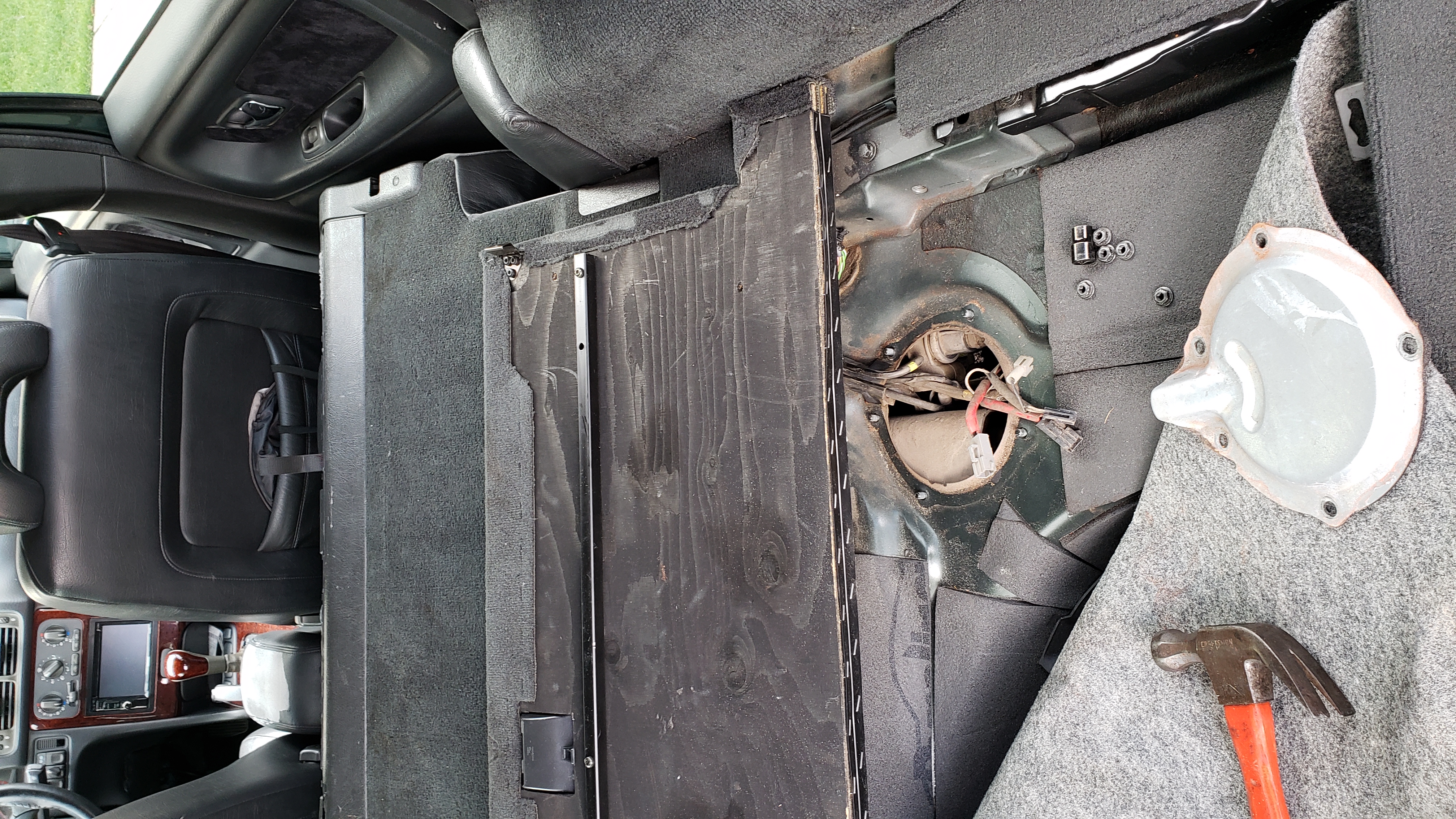

Once you remove the fuel filter you can access that pipe. You can also get some access if you open the cover plate for the wiring from above. To get to that you have to remove the panels on the floor in the trunk. Pull out the 2 small side panels either side, then lift out the rear section, and then you have to undo 4 (?) 10mm headed bolts (2 each side) and then the front portion slides out rearwards. There is then a metal cover behind the rear seat on the RHS and remove that. I think that will give you a better view and may give some access from above.

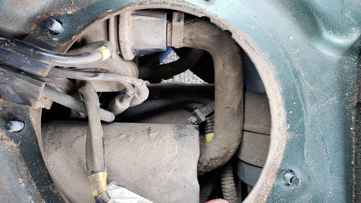

Well, turns out when you're really determined to find something, you dig around long enough and surprise yourself! I took off a random panel in the rear trunk area, and surprise... It revealed exactly what I needed.
So I'll consider this half-solved. So does anyone know if there's also a J-hose on this car somewhere?

Thanks as always Neil. In that picture, I had already removed the support bracket for my investigating.

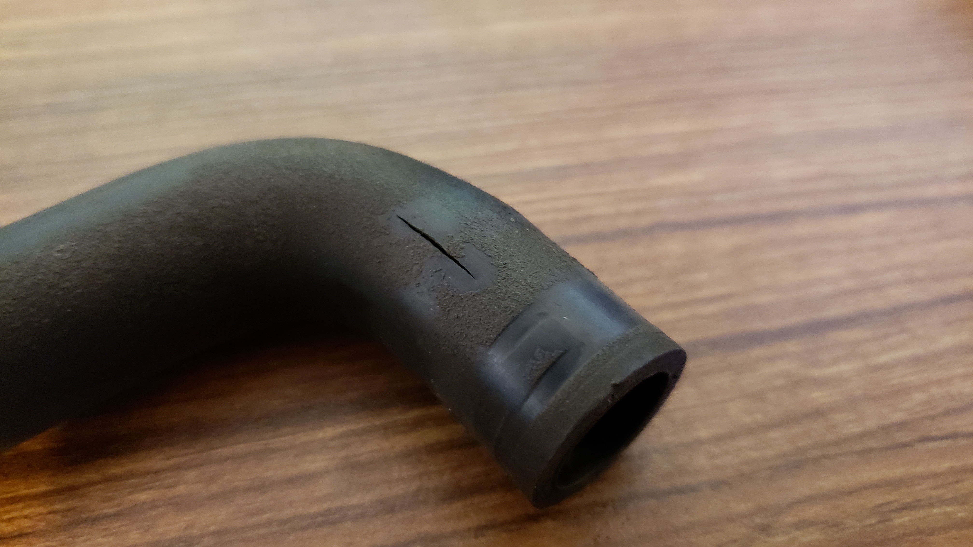

That's a pretty excellent and very detailed thread you got there! Can't believe I didn't find that one. So I was able to successfully replace the canister to roll-over valve hose through the top access point (old one pictured below, hoping that was the one and only cause for my CEL code). Looking through your pics, am I safe to assume there is no standard "J-Hose" on this model?

Correct. You only get that on the FWD versions. That is the AWD equivalent. On my V70, the hose from the roll over valve to the filter outlet on the top of the filler pipe was also cracked but it has no play in the AWD other than if you get a fuel leak.
