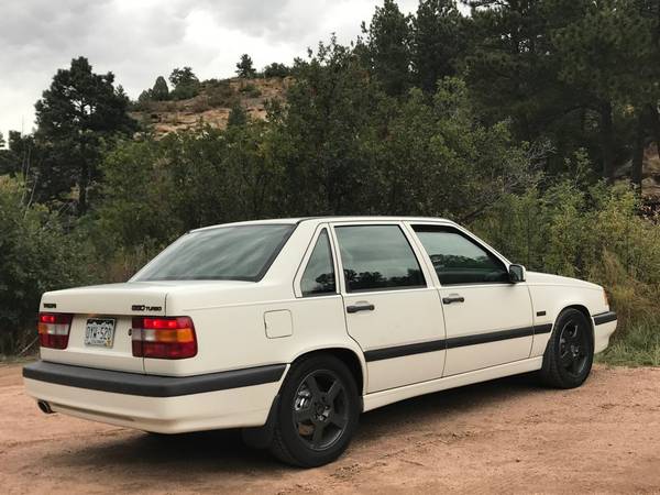

It is white with a tan interior. I'm not really looking forward to pulling the engine to replace the rear main seal but I look at it as an opportunity to seal everything up and give it a real good once over and fix everything that the last 20 some years has done to it.
