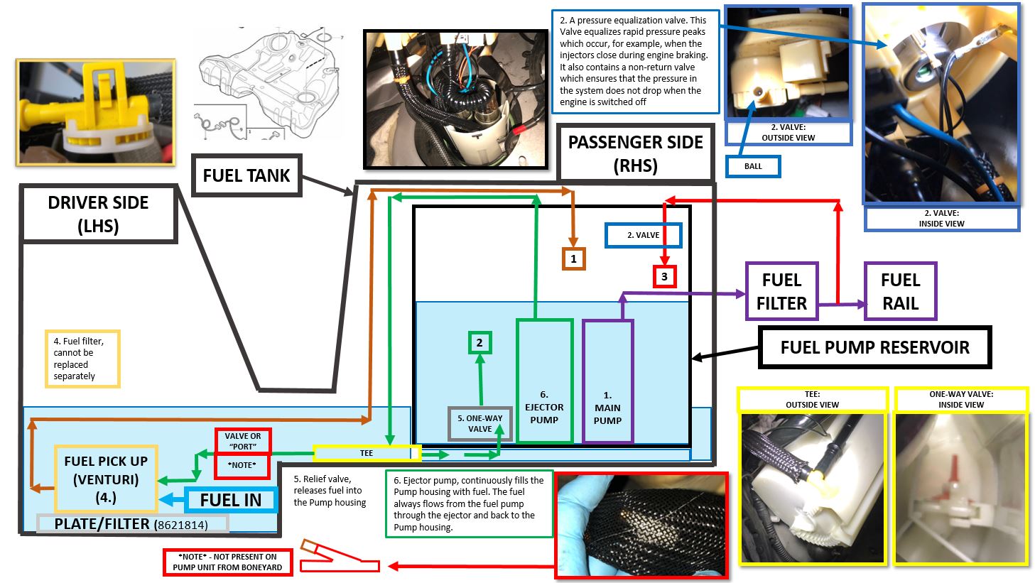

HERE'S A SUMMARY OF HOW TO DIAGNOSE THE DECOS P2 FUEL DELIVERY SYSTEM (Air supply and delivery at the rail are assumed to be good). There are other methods, but this is what I would do. I assume no liability and perform at your own risk.
MANY THANKS TO EVERYONE FOR THEIR CONTRIBUTIONS/ADVICE/HELP/THOUGHTS!!!
VOLVO would not proceed unless I had them replace the sensor ($120). I conceded in order to get the car back. They tried to charge me for the diagnostic, but I reminded them that the agreement was that if the fuel pump was faulty, the diagnostic would be waived. So it cost $120, versus me having to replace the pump myself @ $300+. They were nice and friendly, but they took 9 days to get the car back to me. That is not very good service. I was also kept in the dark most of that time despite various inquiries. However, they did replace it under warranty. Volvo website indicates part warranties are non-transferable. No indication of that on the original receipt so I thought it was worth a try. Maybe it's a law in CA or something...At any rate, one reason to avoid the dealer at all costs if you can. The final resolution was acceptable, but it was a stressful 9 days. I was tempted to tell them to button it up and forget it because I could fix it in an hour or less...enough on that.
Software was up to date already.
I picked up some parts at a boneyard while my car was in the shop: Fuel Pump ($31), Foam under seats ($10/both), PEM ($10), Fuel Hose to filter ($3), turn signal stalk ($12). Mainly I wanted the fuel pump in case I decided to fix the kink hose. I've updated my schematic accordingly, as a few things were incorrect. See below.
- Check codes:
Follow the codes to get the particular error resolved- typically this just requires replacing the FPS. See below for more info on the FPS. - Check fuel pressure:
- Manually checking a fuel gauge is better as a first step but the Schrader valves are not in the best positions. I had a coolant hose clamp in the way of the one on the rail. If a known good FPS is installed, VIDA or OBD scanner can be used to check the value
- Fuel Pressure Values:
- Gage pressure should be 380 kpa (55psi)
- FPS value in VIDA (and typically OBD tools) report as absolute pressure: gage + atm = 380kpa + 101kpa = 480 kpa
- ECM value in VIDA does the same. Atmospheric sensor is on top of the ECM which is on top of the air box
- It is normal for fuel pressure to vary with engine load. Fuel pressure should hold after the key is cycled off.
- Check FPS (7/156) Electrial: Note values have not been completely verified as the calibration of the FPS is unknown (proprietary to BOSCH)
- Signal to ECM is the Blue Wire (0-5V): (#A71 at ECM), 2.4V at startup, then 1.8V to 2.1V at idle
- Supply Power is Violet Wire (5V): (#A47 at ECM)
- Ground is the Brown Wire: (#A14 at ECM)
- [Fuel Temperature Signal is the Green Wire: (#A46 at ECM)]
- Check PEM (4/83):
- Power Supply - CEM to PEM (#A16 at CEM)- (Blue Wire into PEM): ~14.0 V
- Command Voltage from ECM to PEM (#B20 at ECM) ((Yellow Wire into PEM): varies depending on the ECM command. Mine was around 7-8V. PWM signal so there must be a PWM circuit in the ECM for this.
- Pump Control - Amperage from PEM to Pump (6/33) (Black w/ White Wire out from PEM): 2.0 amps (idle) to 8.0 amps (full load)
- Note: Ejector Pump (6/31) runs off Blue Wire from ECM at full voltage (14.0). Branched off of the wire that supplies power to the PEM.
- Check Pump
- Check Venturi Pickup For Obstructions (Yellow with White Guard on Bottom; Connects to Level Sender which is spring loaded to keep it on the floor of the fuel tank
- Check Fuel Pump Lines for Kinks
- Replace Pump Assembly- Anything else wrong with it would be very difficult to diagnose. This is why it is sold as an assembly.
- Plastic Tank- Magnets won't help with debris. Some models have metal tanks. You'll have to research that for the application.
- Component designations: (xx/xx) - First component is the system, second is the serial. e.g.- 6/33 is the pump. 6 represents an electric motor and 33 is just the number of the component.
- Accessing the fuel pump is much easier than you'd think.
- Remove driver and passenger seats. Remove the covers by popping them free (up in rear and forward in front). You can remove the center seat, but make sure to disconnect the battery first. Wait for 10+minutes, and then disconnect the orange connector under the seat. Each seat has 4 screws. Tie up each side of the floor to the center seat using a bungee.
- Break the foam pieces under the seats. (Not necessary if you remove the center seat. Just take them out). Remove the smaller foam piece running behind.
- Remove passenger side duct
- Cut an access flap in the pump side floor lining the size of the cover.
- The rest should be easy enough other than the lock rings. Those require a special tool (Schley 69800) which I recommend buying ($35). You can make one, but I don't think it is worth it and you need to torque them back correctly (@ 60 Nm).
- Make sure to tie a line on the level sender side hose before pulling the pump out. You use this line to pull the new one back through to the driver side.
- I don't think it is necessary to completely remove the fuel, but this makes the operation more risky. Keep yourself grounded and don't make any sparks. 1/4 tank is fine. I siphoned the fuel once there was access, but when I replaced my E46 fuel pump last week, the tank was full. You just have to be smart and careful!!

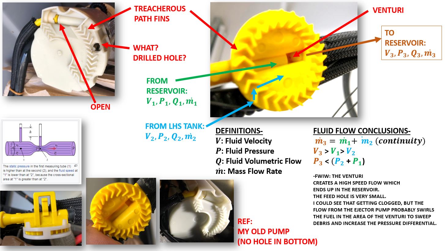

Sorry I didn't see this one earlier. I applaud all the hard work and methodical troubleshooting and documentation.
This issue is not too uncommon when FP is replaced. Dirt gets into tank and the dirt/silt plugs the membrane filter on bottom of pumps in the fuel pump cup. Letting the car sit lets the dirt fall off when suction is gone.
Multiple fuel pump replacements fixes it. Removing tank and washing it out and then replacing pump or disassembling the existing one and cleaning the membrane filter will fix it. I have seen the pump moved to another car and have no issues like you reported. The dirt in the tank is cumulative with some getting through membrane. When there is still dirt in tank then it takes time for it collect enough to starve pumps and the PEM current to ramp up at command of ECM. PEM can get hot and shut down and kill the car sometimes. This is a KILLER problem the first time you have it. It is spotty as some areas have no dirt roads or the car is not driven on dirt roads. It is not a sign of a less than clean tech doing the work. It is a result of the sender and sender/pump unit being low spots and the retainer rings having a great place to hold dirt that is hard to blow out prior to pump removal. air blower and at the same time using a shop vac seems to gt the area clean.

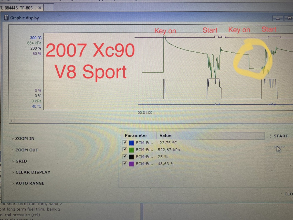

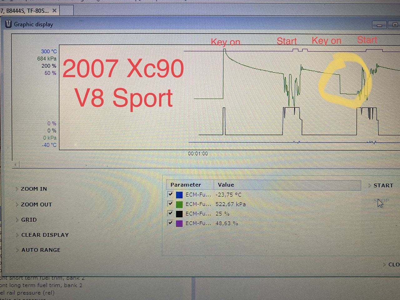

Wow! What a methodical post. I have the same car with a similar issue. Mine have no fuel pressure intermittently. Most of the time when it is cold (-10F and bellow). Since you are now probably one the world’s expert of volvo fuel pump! Do you have a vida graph of fuel pressure vs duty cycle when everything is running fine after your repair? I also have a 2007 V70R so I took the PEM and try it on the xc90 without succes. But when I compare the graphs I see different relationships behaviour.
Thanks
On my 2007 XC90 V8 when the key is on, the pressure raise and then drop slowly. While I am cranking it, the pressure drop by half. It is not what is happening on my V70R, as soon as I turn the key the pressure raise and stabilize. Also there is a strange (fake) pressure drop in yellow. It would be interesting to compare with a working V8.
Thanks
- Posts: 35267
- Has thanked: 1497 times
- Been thanked: 3809 times

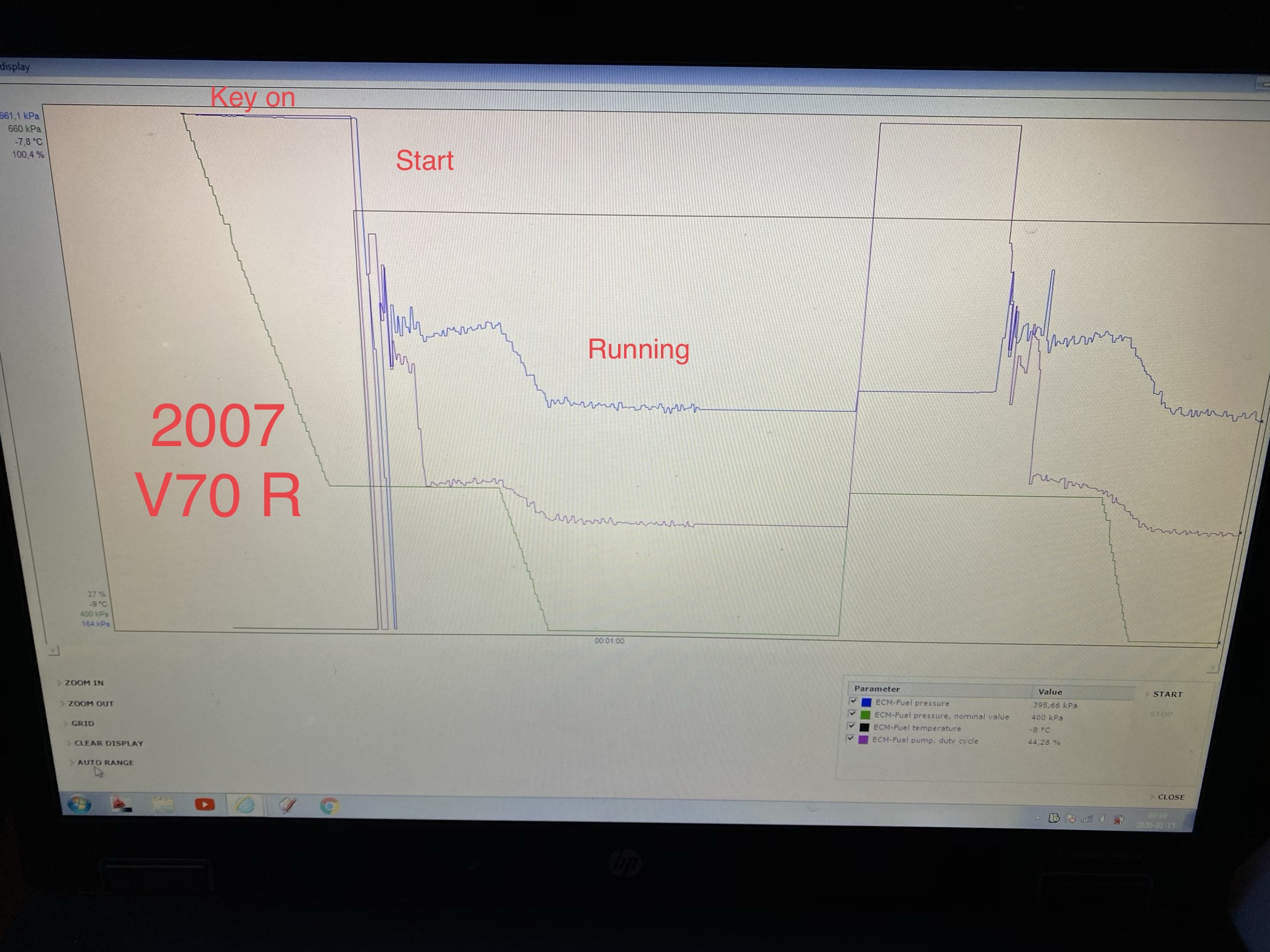

There is a link to some data up thread that we found during this saga - something like pico.com?
They had waveforms taken from the PEM and the CEM driver waveforms.

Sorry to hear you are having trouble. I’m by no means an expert, but you should be able to do some diagnosis on your own or take it to an indie Volvo dealer and they could figure it out fairly quick.
It sounds like your pump is on its last leg. Cold weather = no start? Lots of details missing... The pump should be delivering the correct pressure without much change in pressure (the PWM will vary this on demand) always (closed loop system will react to changes and correct). doesn’t look like it’s delivering enough to start. Could be a blockage of some sort but details are all in this thread.
See the beginning posts for plots showing a working system. I don’t have them for startup I think, but it shouldn’t be much different (need fuel, air, and spark so it’s 1,2,3 or all). The steps in my last posts should show how to attempt diagnosis on your own.
