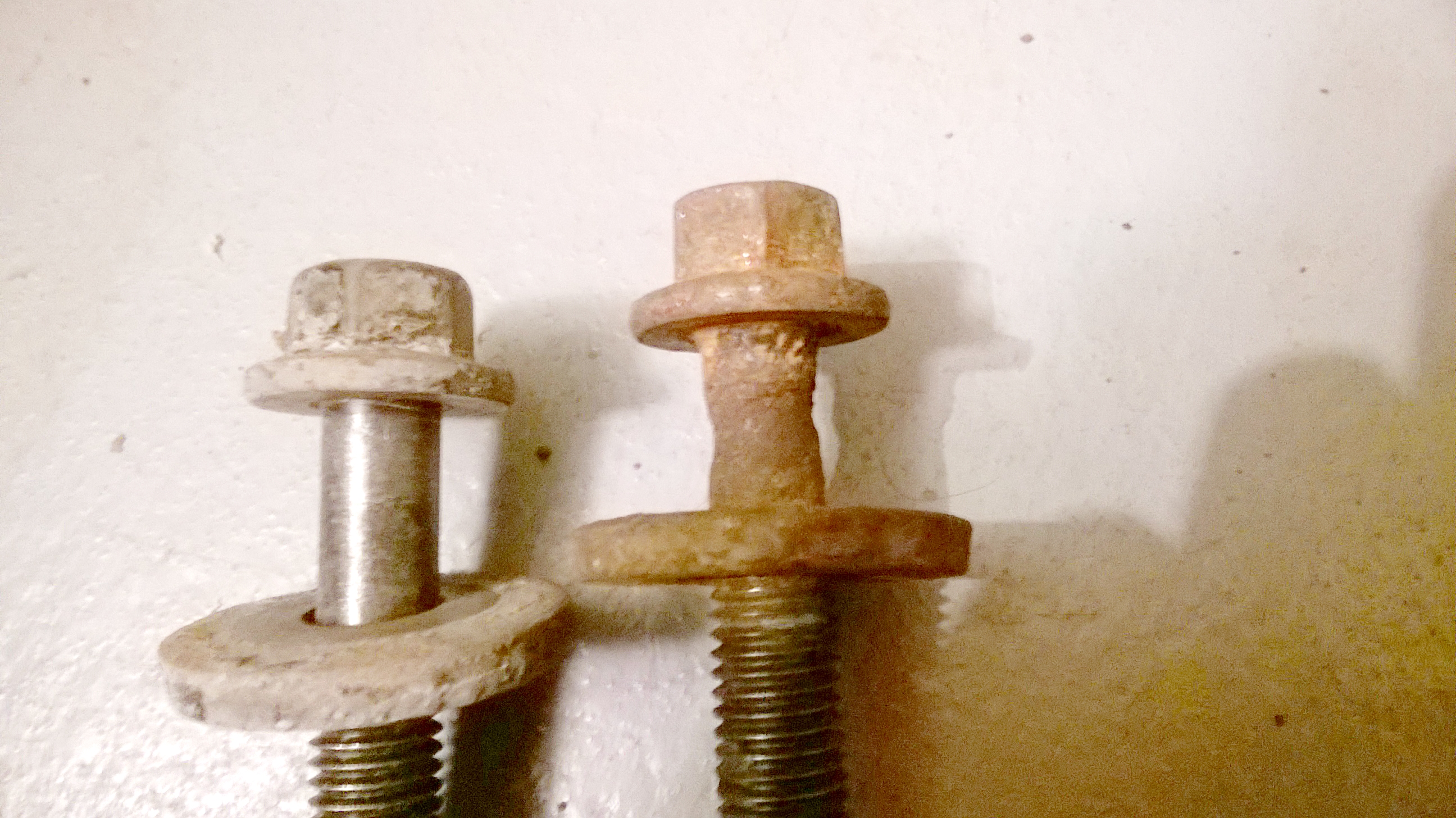

Small warning on those 18mm subframe bolts
Good to give them a check

Wow! That's scary! It so happens my S80 has been in the shop for nearly two weeks for a rear main seal leak and I insisted the bushings, washers, and bolts be replaced among a list of other things. Volvo insisted they never replaced any on a S80 before. Turns out two of the four bushings were bad. June

Worth noting on these - if you remove them to check them, you have to replace them anyway. They are torque plus angle to a point where they are stretched, if I recall correctly.
To be confirmed here.
This is for my P80
This is for my P80
Install new screws in the sub-frame with the washers and brackets.
Install the retaining screws holding the sub-frame brackets in the bodywork.
Tighten the sub-frame screws to 105 Nm (77.4 ft. lbs.) and angle-tighten to 120°.
Tighten the bracket screws to 50 Nm (36.9 ft. lbs.)

That right bolt almost looks like a manufacturing defect then. Looks like plastic deformation during a tensile test. Way over torqued.
77 ft lbs plus an additional 120* rotation right?

All data entry for P2 (my 2005) - note caution on doing Left Side first!
Lift the sub-frame up completely.
At the same time locate the mounting screws for the steering gear the sub-frame and, on right-hand drive cars, the screw for the collision protection system.
Install the sub-frame brackets loosely together with the washers.
Install the four screws for the sub-frame. Use new screws. Do not tighten yet.
First tighten the screws on the left side of the sub-frame. Tighten to 105 Nm . Angle tighten 120 degrees . Then tighten the right-hand side to the same values as the left side.
Finally tighten the screws for the brackets on both sides. Tighten to 50 Nm .
Install the engine block heater (if applicable) on the left front mounting for the subframe.
CAUTION: Tighten the left-hand side first. The sub-frame guides are on the left-hand side.
