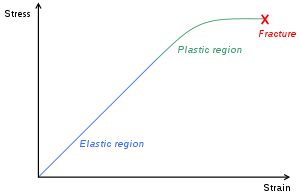

Most bolts on these cars are stretch type. When you read on the specs "torque to xxlbs then turn xxdeg", it means it's a stretch bolt.
What is important to remember is that you will not be able to torque a used bolt to the original specs. This is what stretch means. The moment the bolt is turned xxdeg the metal goes from elastic deformation to plastic deformation and remains permanently into the plastic deformation behavior. When the metal is in plastic deformation mode, if the maximum torque is applied the metal will elongate and the torque applied will diminish until the metal snaps. In the graph, notice how the possible stress (call it torque) cannot be increased anymore once in the plastic region. Basically, when the bolt goes into the plastic region, if you keep torquing it will feel like it takes less and less force to torque until the bolt will snap. In other words, once a stretch bolt has been turned the xxdeg, it cannot be tightened again to the maximum torque or with the rotation of xxdeg.
You will need to torque the bolt somehow below the specified torque, and even forget about the rotation. How much below? Impossible to tell without the graph for that specific metal/thickness. And the other question is, is it safe to torque the bolt below the specified torque?
- 300px-Stress-strain1.svg.png (6.29 KiB) Viewed 1607 times
