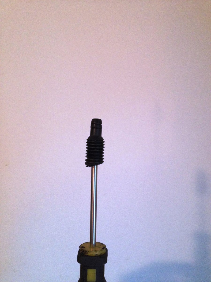

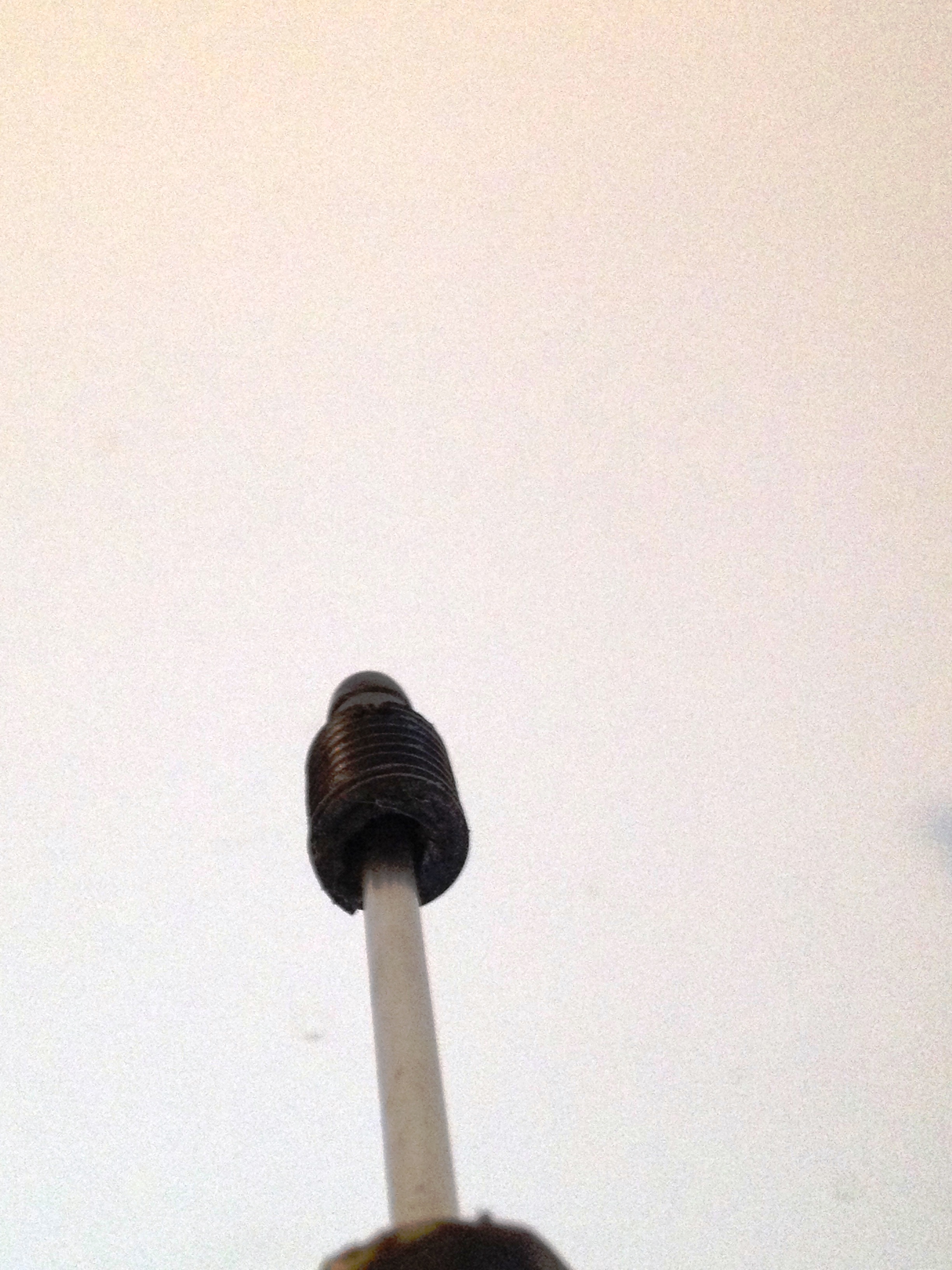

Well, I know this topic has been around for a while but I don't think these plastic drain valve problems will ever go away. It happened to me a few days ago and I would like to share my remedy and one that was successful. I do have to give credit to "the someone" on youtube who has a short video about this.
First off, never try to loosen the valve until the radiator has completely cooled down.
If you over tighten cold, and the rad gets hot, it might create a fault/weakness exactly where the overtightened valve seats? It will twist off like a well chewed piece off Bazooka?
As far as removing the broken piece that has broken off flush, you can carefully start either a self tapping screw to give you a center point and/or, use that as a starting point for your drill tip. Use a 3/16" to 7/32" drill bit and drill up carefully no more than one half inch.
Then take a small 7-8" flat head screwdriver with a tip 1/4" wide, and heat the top 1" of the screwdriver blade with a propane bernzomatic until cherry red, about 30 seconds. After that push the screwdriver up into the hole that you drilled noting that the screwdriver tip will melt up slightly beyond your drill hole and "you don't have to kill it?" Press firmly up and hold for approximately one minute while trying to keep it still. After that, leave it for about one half hour (could be less) so the melted plastic bonds to your screwdriver. Make sure it stays up there by itself before you walk away.
When I came back to mine, it unscrewed like butter, success!....And saved a pile of money and time.
If your not comfortable with a drill bit, you can use a shorter self tapping/drilling sheet metal hex screw to make your center.

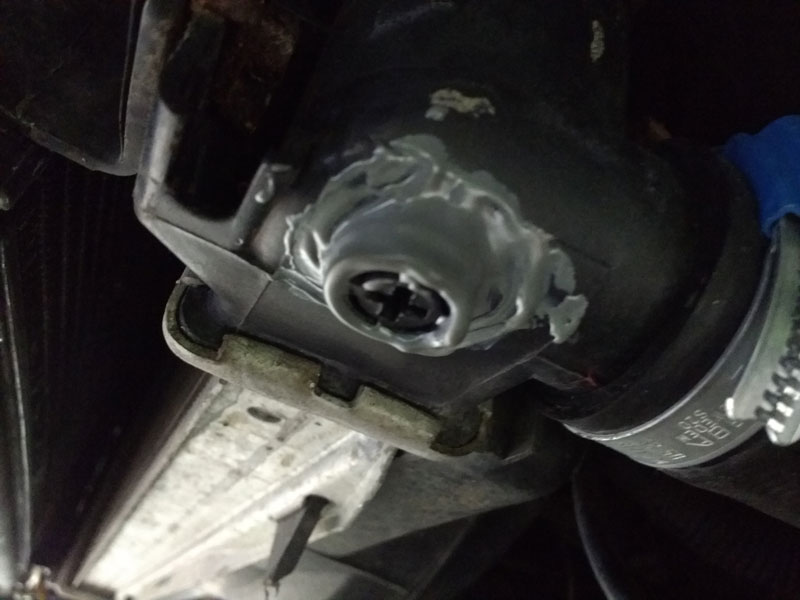

Finally got around to doing something about my weeping petcock... Only took me two years to fix... Sheesh...

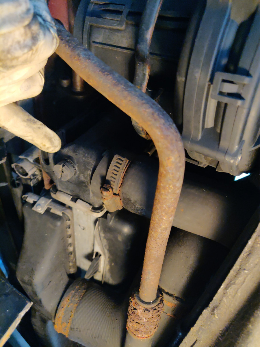

Ok, so you mean don't touch this little drain plug on the radiator of my v70 1998 fwd GLT?
I'm in NC and driving to FLA as soon as I'm done with a TB replacement, so I don't want a whole bunch of new monkeys!
I guess I will wait till I get safe and settled to do a coolant flush.
What happened to your drain plug, and why did it self destruct?
I think this is the drain plug in the following pic. Correct?

Where is the clamp on the intercooler pipe?
May be easier to remove the lower hose is you want to drain as possibly less likely to break anything!
Why doe the pipe lower radiator pipe looks damp under it? Is it residue from something or the pipe getting porous?
