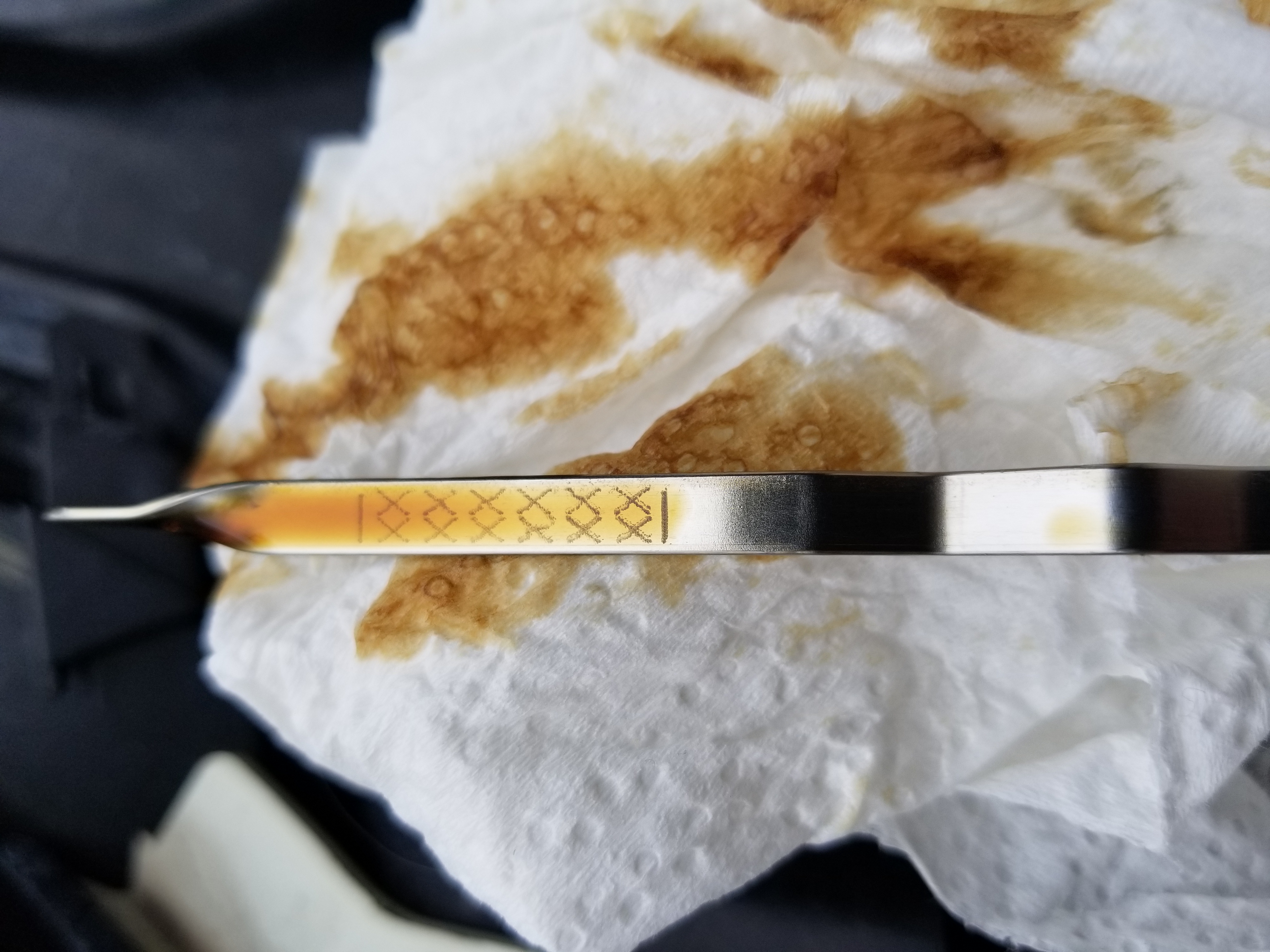

When I discovered the darkness under the cap on my car with synthetic its whole life made me question. On MVS I kept reading about German Castrol. So I did internet searches about synthetic oils. To my surprise my 04s whole life I had been sold Castrol synthetic from the dealer to learn all the usual name brands sell modified crude oil as "full synthetic" called group 3 oil. Where as Mobil 1 and initially Castrol Syntec were group 4 until 1999/ 2000 era. If you want a synthetic product here in the USA there is Amsoil group 4 still and other products like Redline group 5. Only group 4 and 5 oils are NOT made from crude oil.
I switched my car to Redline 5W30 initially as it was last fall when I switched. Now for summer 10W30. Look in your maintenance and owners manual under oil requirements and you will find our engines require 10W30 with the stable ambient temperature above 86°. Anyway using Redline my engine has become extremely quiet as well as the turbochargers are also much quieter as well. I read in many places online Redline is known as a side effect to make engines quieter
On the dealer Castrol the upper engine was somewhat noisy at idle. Also the oil no longer turns murky/ nearly black in 3K miles. In fact stays transparent and slightly darkens to look like maple syrup in 3K miles.
I'll add photos of dealer full synthetic oil at 3K darker oil photo and Redline 100% synthetic at 3K miles lighter oil photo to show you the difference. Both are 5W30 run in the same engine for 3K. Looking at the group 3 oil at 3K it is no wonder these engines are cruddy since most seem to like to run 7.5 to 10K oil changes. June
