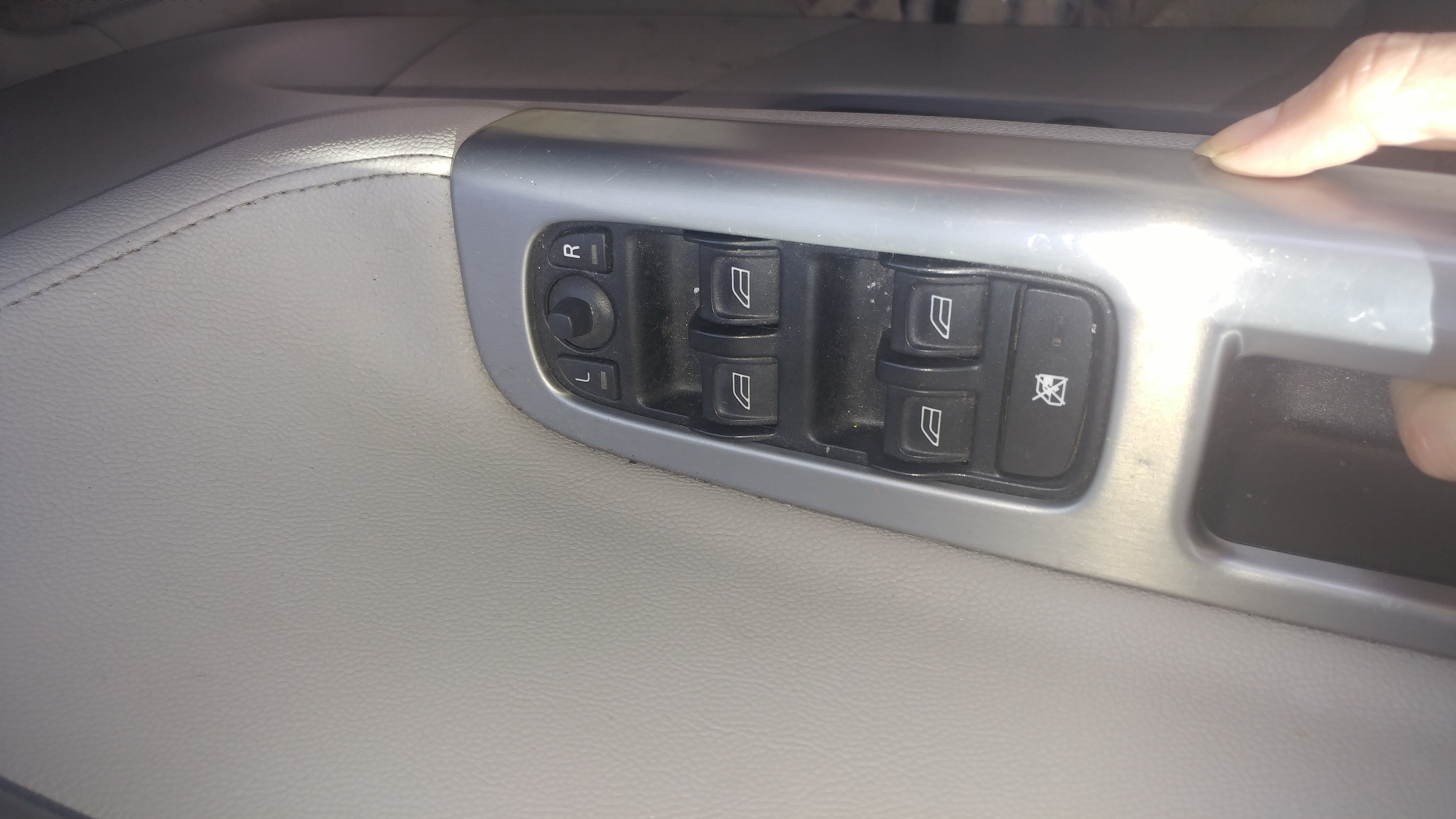

Hi there :)
My drivers side window panel and my sunroof motor appears to have completely died on me just in time for the warm weather! Yippee skippee!
The drivers side lock/unlock switch works which is located just above the windows switches. The window and/or lock/unlock switches also work throughout the rest of the vehicle.
The problem is only with the sunroof and the drivers side window not opening. The green indicator light on the window panel is not lit up either. The mirror adjuster knob doesn't work either. It's on the same panel as the window so I assume they're related...
Any advise is very much appreciated!
Thank you!
- J
Photo of drivers side window panel

Find where the fuses are...could be simple as moisture or corrosion. I'm thinking the fuse panel under the glove box.
