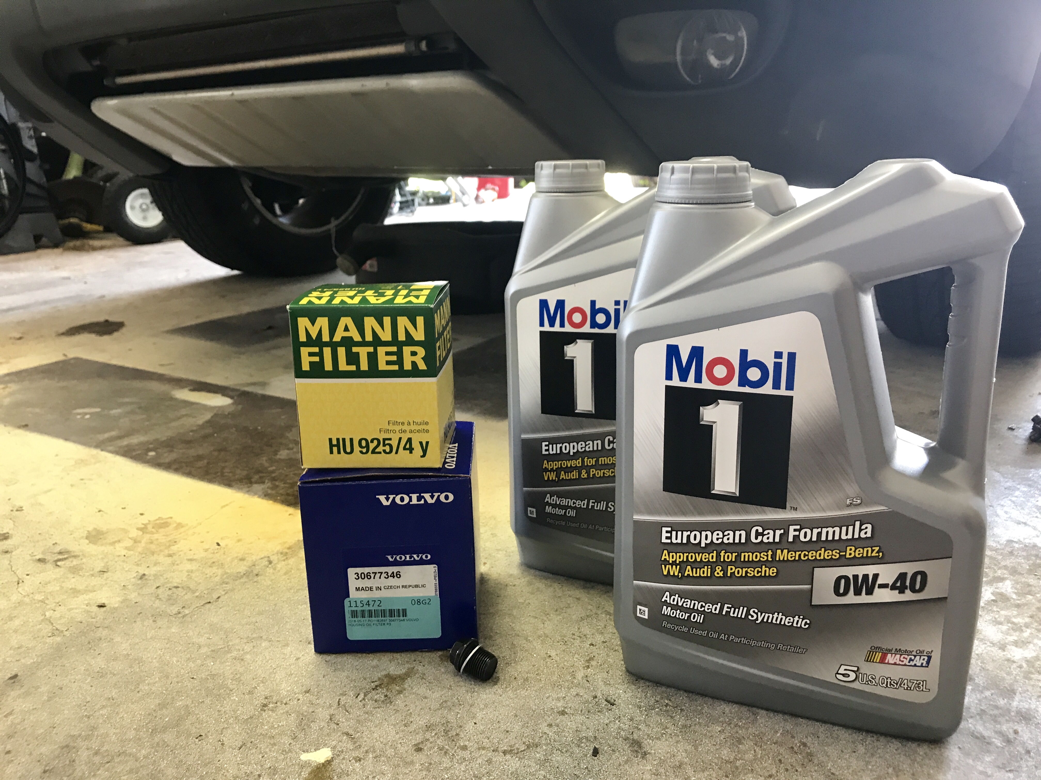

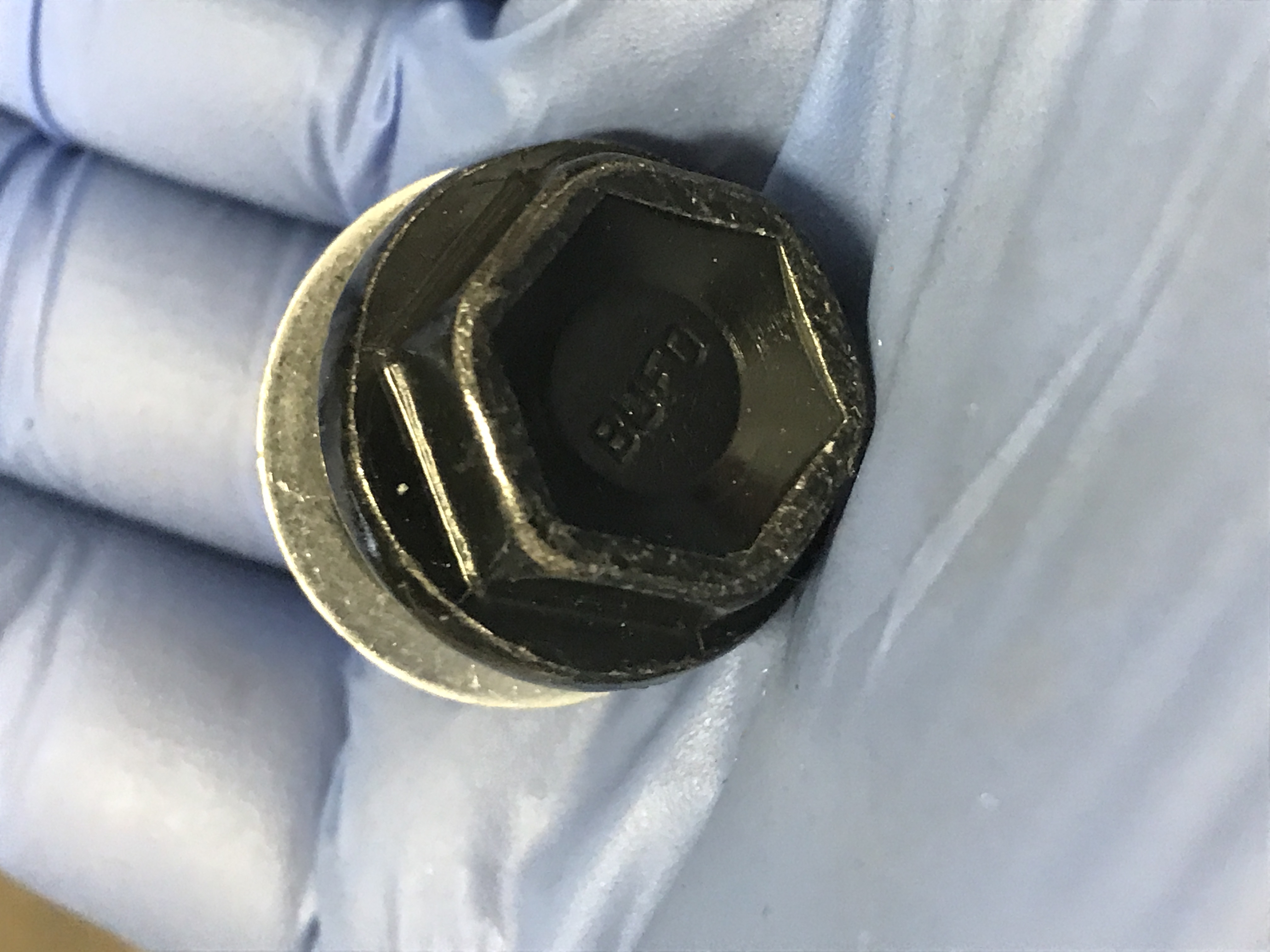

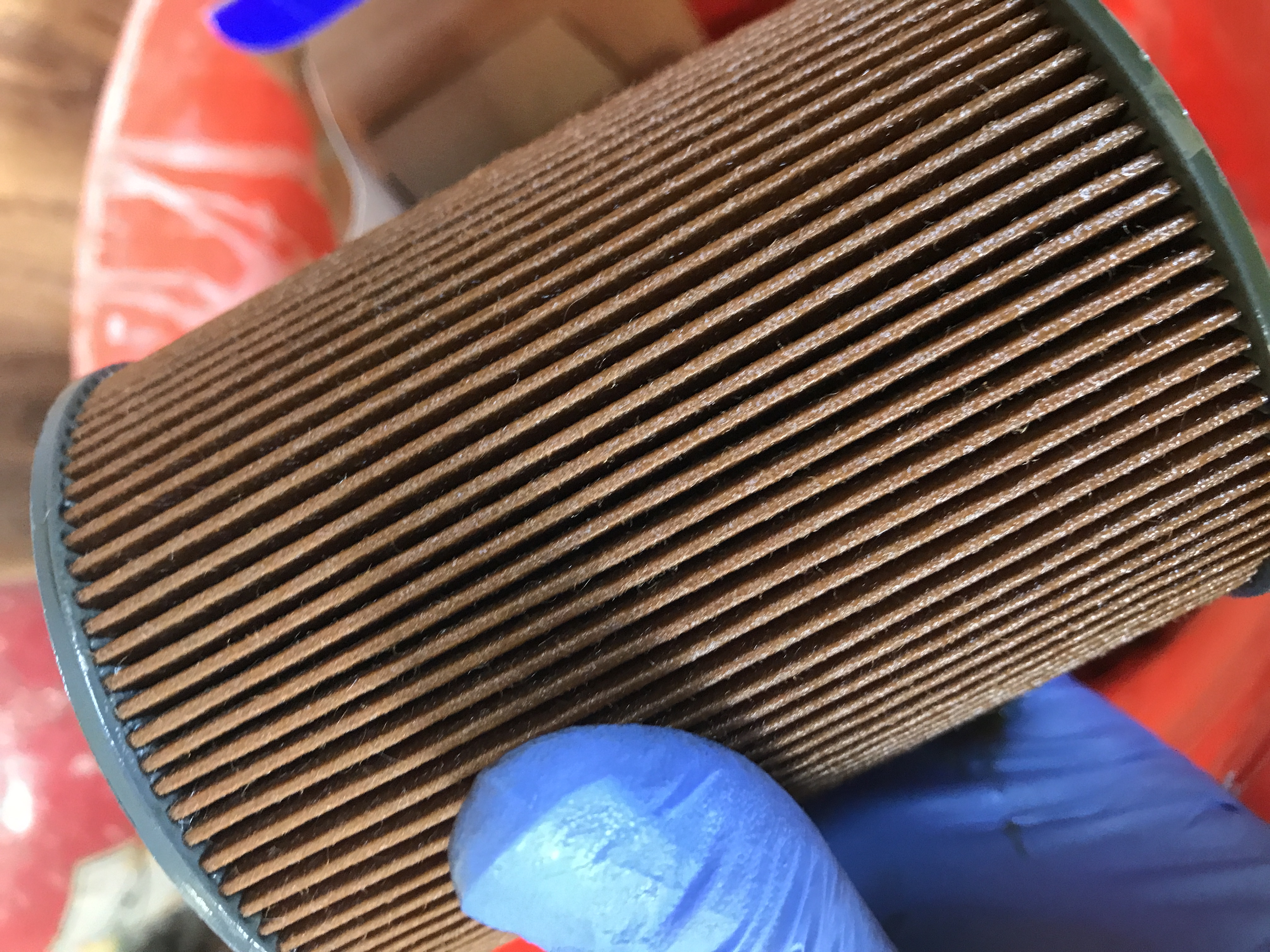

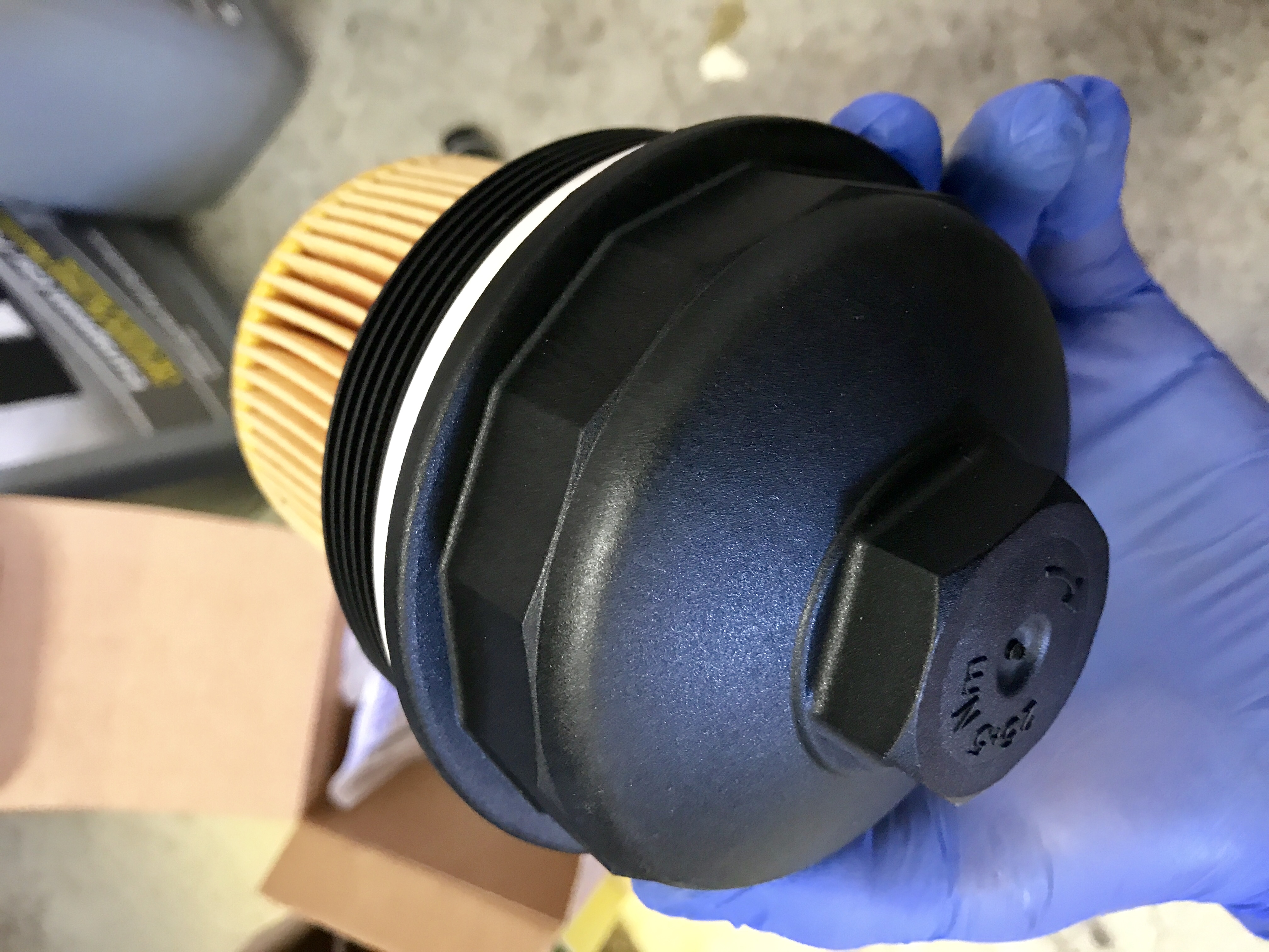

Last week I went ahead and change the oil with Mobil 1 0w40. the oil in the vehicle had about 500+ miles on it and came out strong coffee black. I also changed out the drain plug and the oil filter housing.

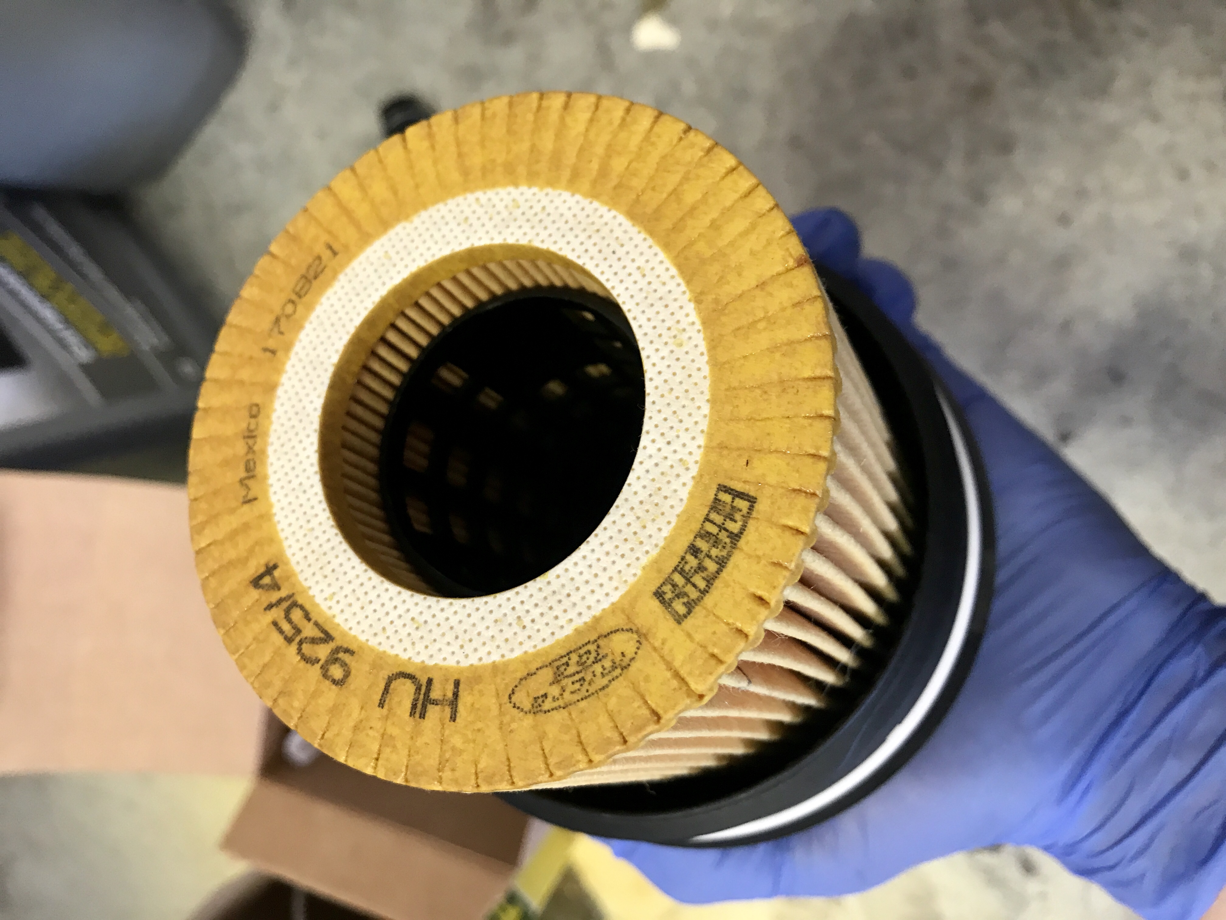

The old oil filter looked decent, but replaced it with a mann filter. I'll drive it about 1000 miles and replace the filter and top off with fresh oil, then keep the oil maintenance steady from here on out. I'm not sure if i'll go to the 7,500 mile service or just change it everything 3,500-4k miles.

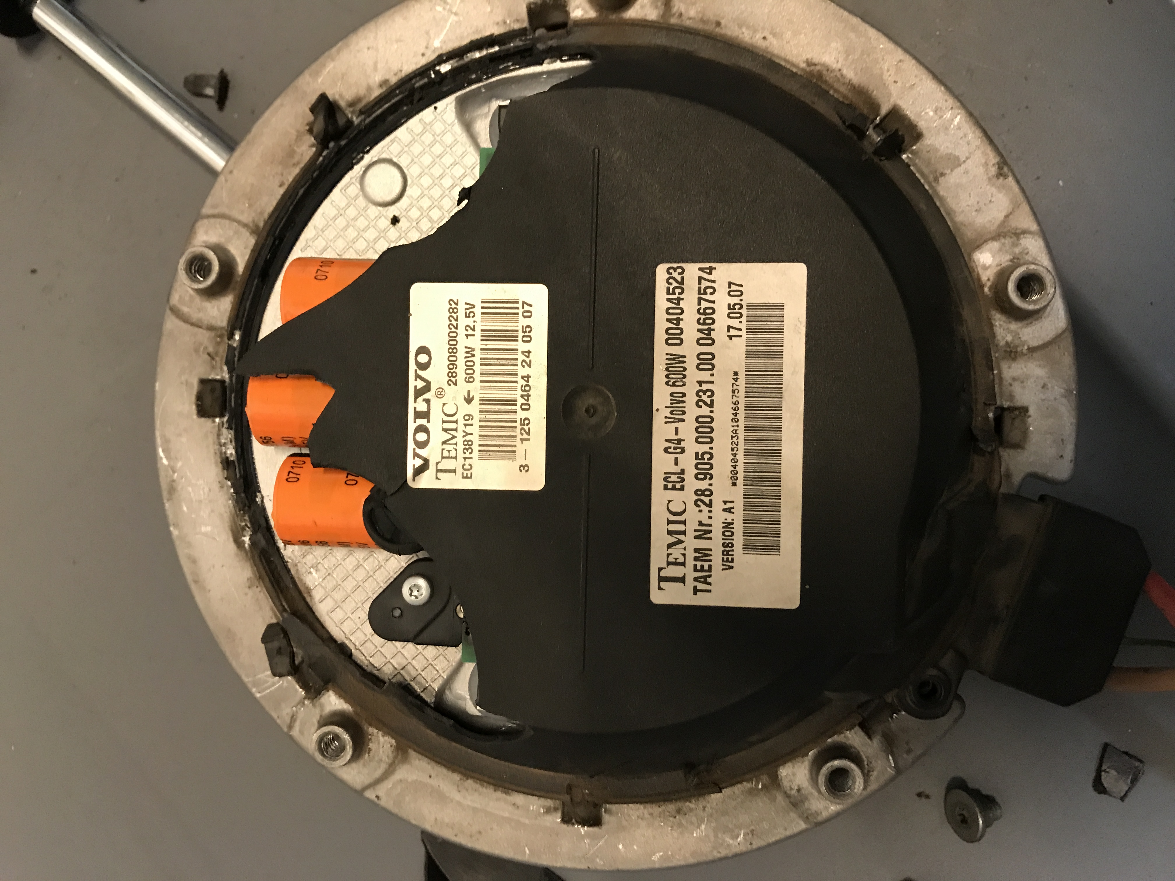

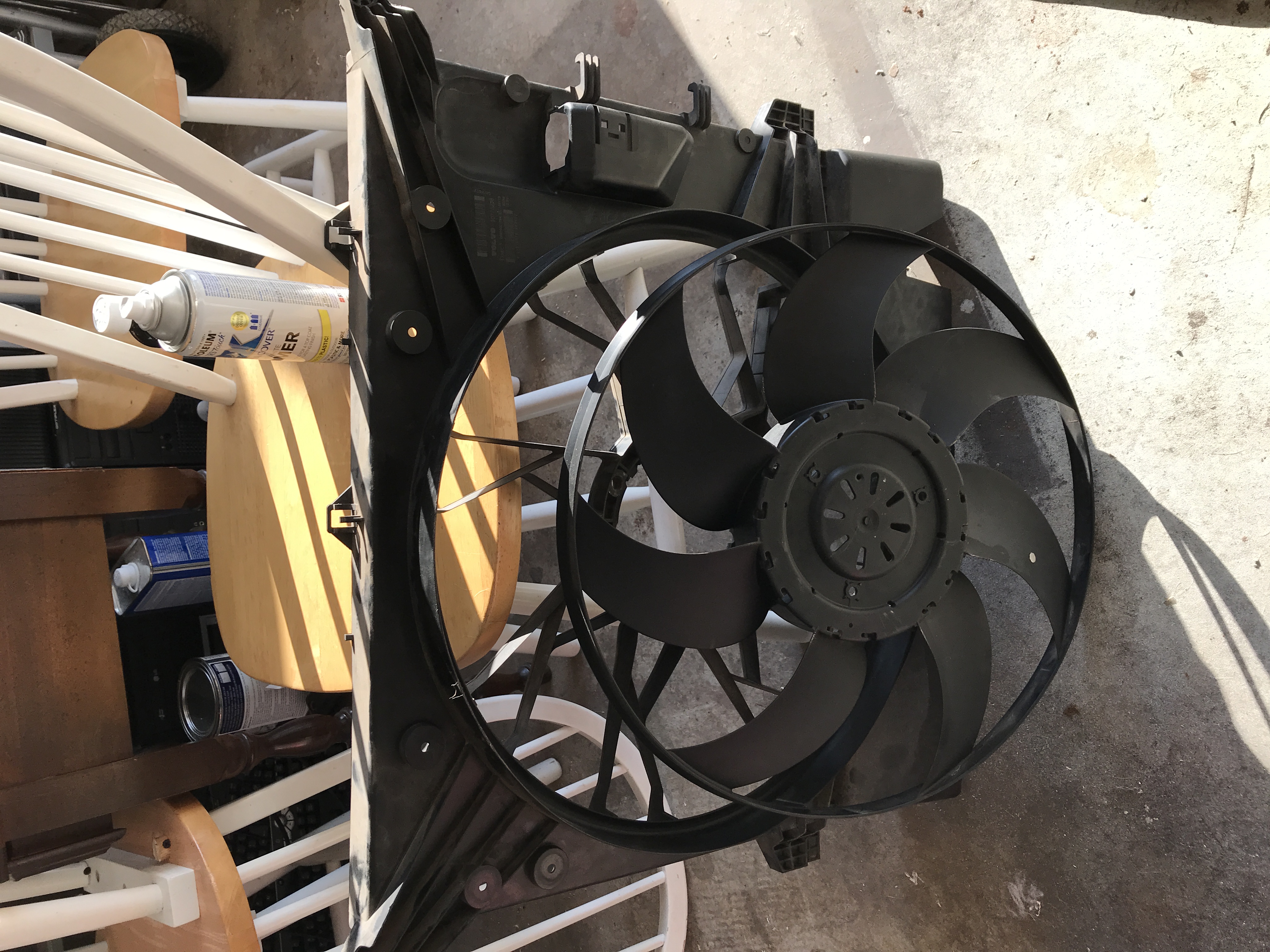

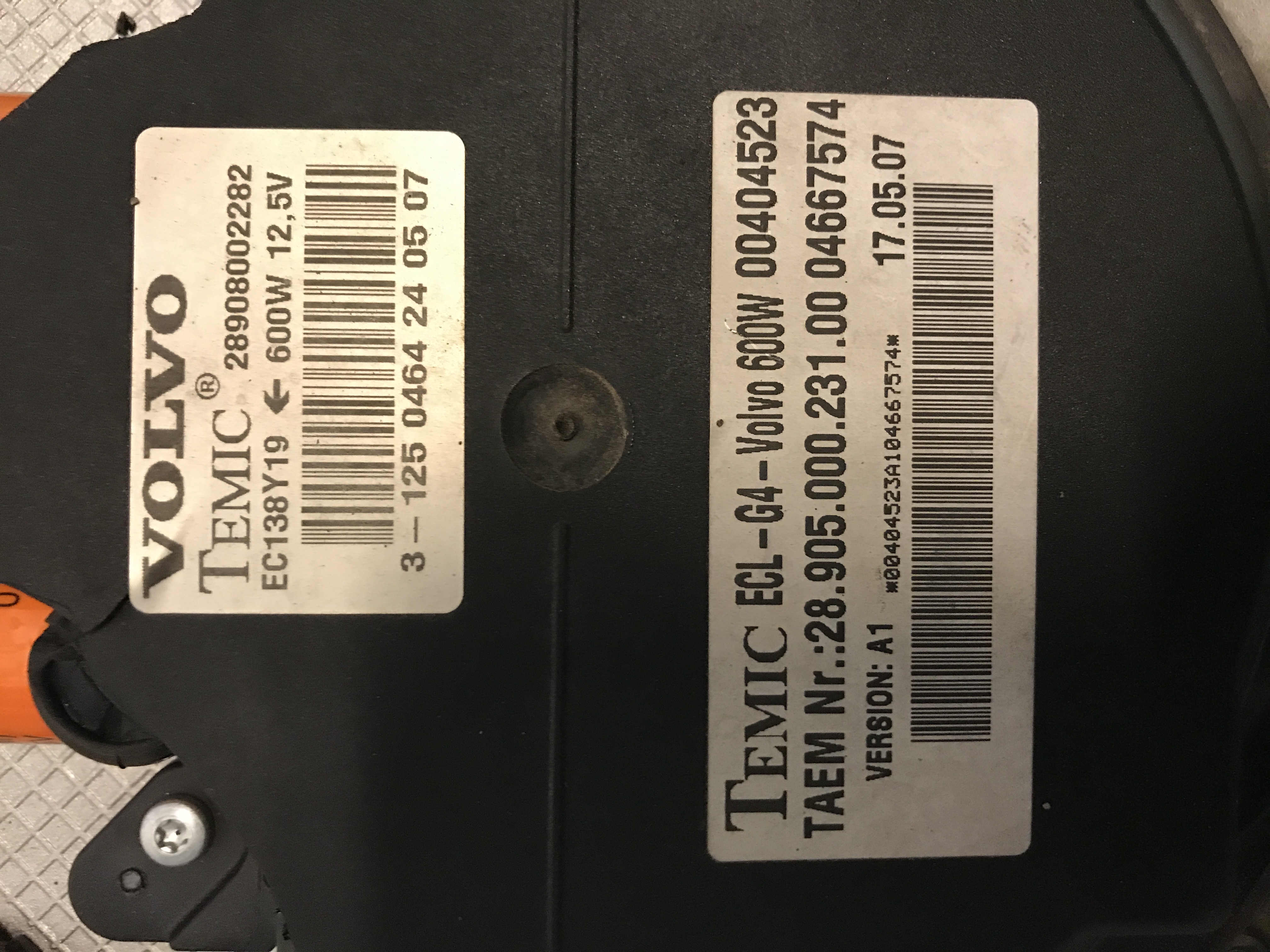

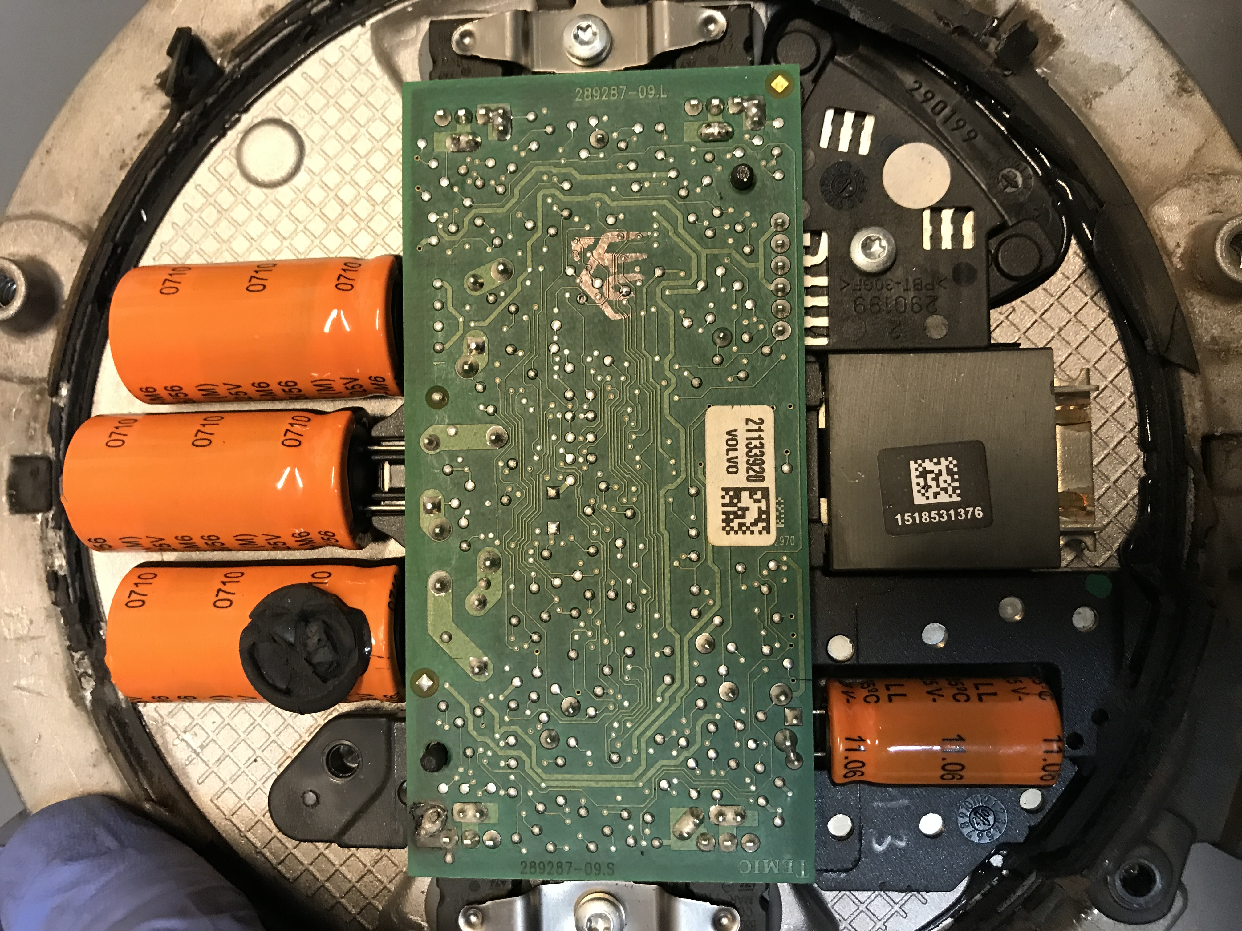

I also had an overheating issue a couple weeks ago and changed out the cooling fan..
I also tried to gut the old fan motor to see if I could replace components as its kind of what i do for a living. but this motor is built to tear apart but not service...
I looks as if a few cold solder points are there but I didn't even bother to repair as I had to rip the shroud apart to get to anything.

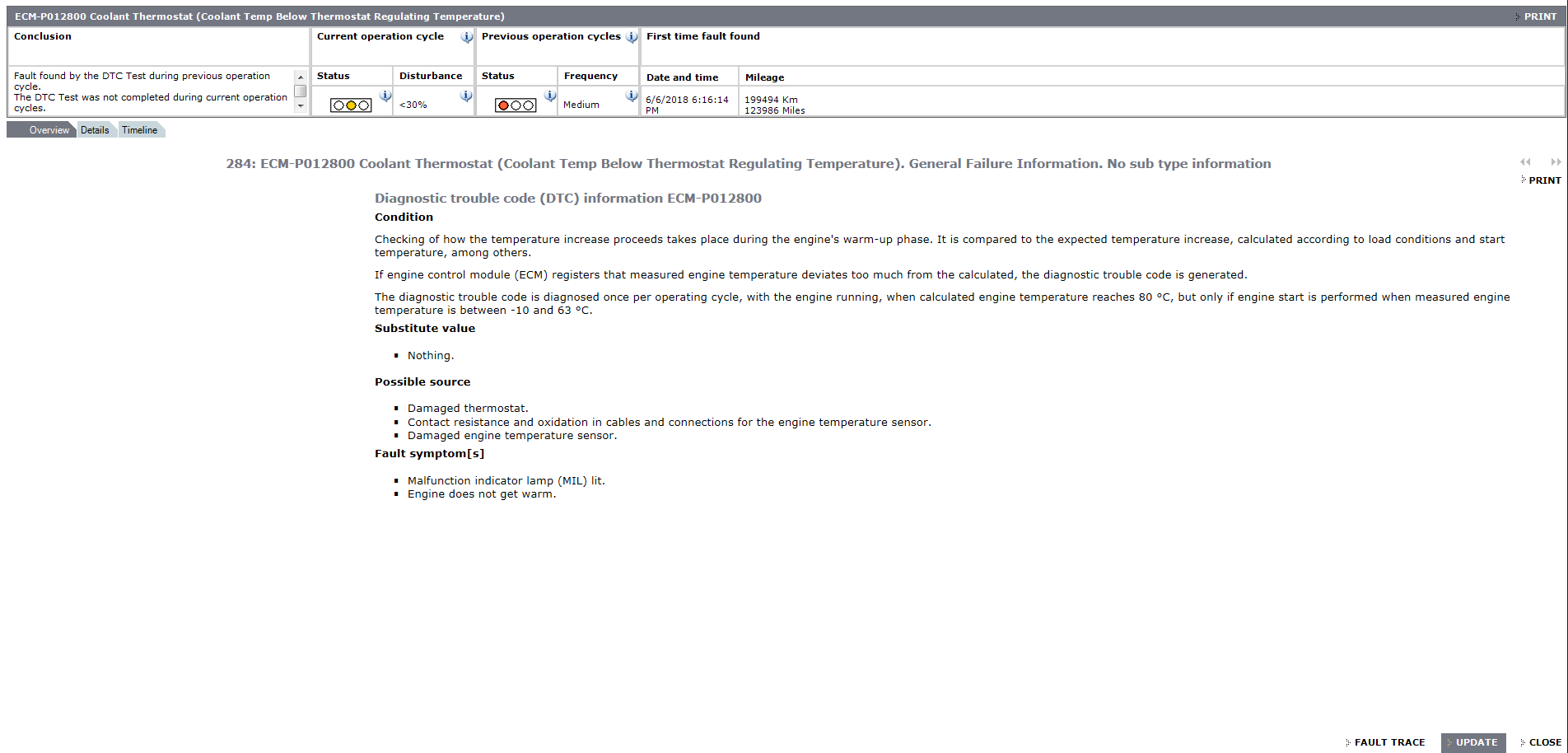

Also getting this in vida, not sure how to approach it, one user did mention to go ahead and change the thermostat. This is a good indicator for this? Or should i tinker with the coolant temp sensor first?

Maybe look at the temp gauge needle, as the car is warming up, does the needle climb at a steady rate? Also inspect the wires to the coolant temp sensor, in particular right where they go into the electrical connector, sometimes they can crack at that point
The old oil filter looks really clean. Perhaps the car was already running on synthetic oil before. Maybe just keep an weekly eye on the oil level just to be safe

That filter & oil had about 500 or so miles on it before I changed it. I had the dealership do an oil change, they forgot the rock guard and did not have a proper tool to get the oil filter housing off. They didn't tear it up too bad so I am keeping it as a backup. then they couldn't even tell me what oil they even put in the vehicle :shock: . (the tech was off when I had to fight to get my rock guard back)
This dealership was run-of-mill crap fest. Sales guy was awesome, but once we hit financing the experience turned from good to bad pretty fast. the week after I bought the car it when into full overheating mode. I took all the proper steps not to damage it. They said I'd have to replace the READ assembly... They didn't have Vida, I did. It was a $200 fan replacement, 2 bolts and took an hour. They tried to buy the car back thinking they were going to have Volvo replace the READ gear @ $2900. They signed me a check for $1500 and I signed my warranty rights away (3 months/3000 miles) They couldn't do an oil change right so signing that was sweet relief that I could start digging into this thing.
As for the hot/cold needle... It takes a fair bit of time to reach neutral position. Lets just say 30-45 minutes from cold engine. It gets up to the quarter mark fairly quickly then takes its sweet time getting to neutral.

I should only take a few km to reach the top so it sounds like you have a thermostat that doesn't close
