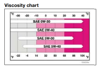

I was thinking the same thing, this is the info I was looking for. this is what is really important for longevity most wear on engines happens at start up. the owners manual list 4 different viscosities and 5w30 is a no-go @ 30C/86F ambient temp, according to the manual. IPD suggested 5w30 semi synthetic and had me scratching my head.
2008 Volvo XC90 Oil Viscocity.PNG (101.69 KiB) Viewed 5947 times
Source: 2008 Volvo XC90 manual.
But 0W30 seems to be fine above 30c/86f, then there is 0W40 and 5W40 both of which can reach ambiant temps as high as or higher then 40C/104F.
I probably wont go with the 5w30 because of the manual.
But which out of the other three, 5w40/0w40/0w30

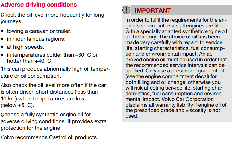

Also Volvo seems to recommend full synthetic here..
2008 Volvo XC90 Oil Viscocity Additional Info.PNG (181.35 KiB) Viewed 5947 times
Not sure how I feel about that. What oil do you use for your 3.2l?
