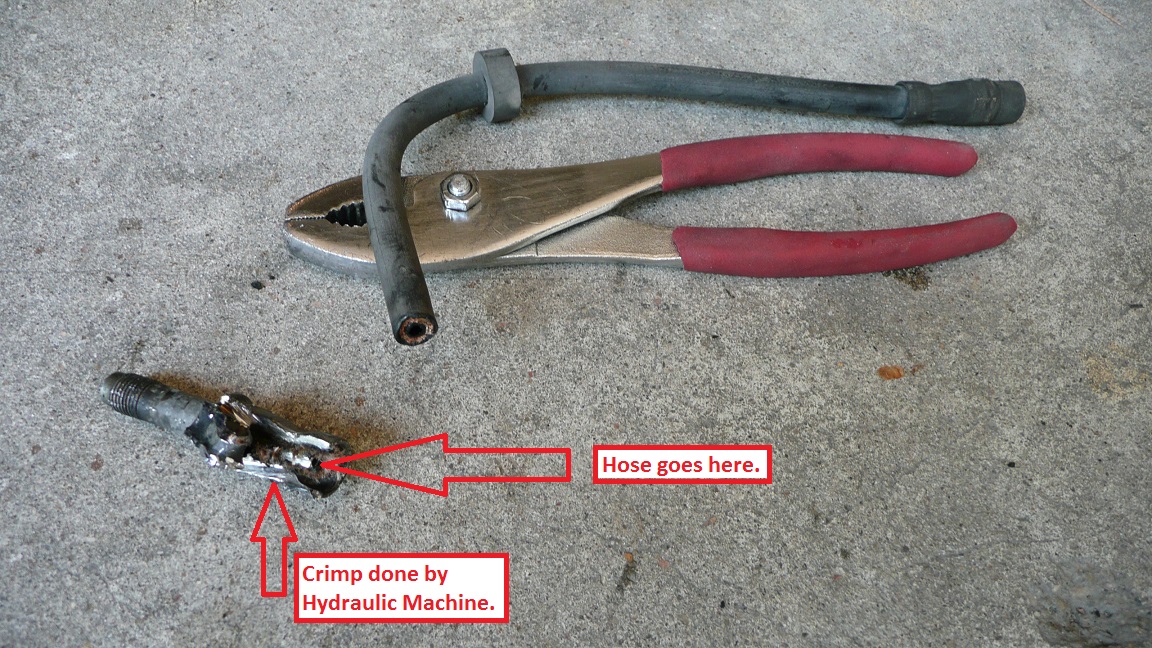

- So...I used a dremel to cut the crimp to see the anatomy. Anyway, this is no different than washing machine hose or garden hose. Basically the rubber hose goes in and the hydraulic machine does the crimping part.

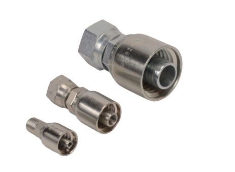

- I also include some fittings I found on the web...
Brake Hose Anatomy...
