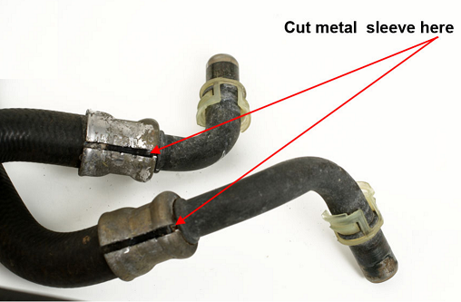

I remember seeing a thread or video on this but have searched here
and youtube and can't seem to find it. I think they cut off the metal
crimp with a cutoff wheel and then just used hose clamps on the
generic hose. Anyone know where this is documented?
Edit, found this JDS60R wrote:
I like the couplers. I don't want any underhood gasses to make it into the cabin. For $33 (new OE coupler) I think its worth it. I remake the hoses with powergrip clamps to avoid the high cost of new ones. I use "advanced formula" hylomar on the orings and we have zero leak problems.
The main problem we did run into was the aftermarket hoses. That's why I switched to Gates hose on the OE ends."
I still can't find the thread where the repair is described. I don't want to do
the coupler delete.

This is the picture that I was thinking of, I don't think that those are the correct ends
but the idea is the same, replace with good quality generic heater hose:

OK cn90 you wrote this: "and simplified the system by using this approach: Heater Core ---> Cut Pipes ---> Generic Heater Hoses ---> Gutted Coupler ---> Re-used the barb fittings ---> Generic Heater Hoses ---> Engine"
Why a gutted coupler, I don't want to do that, just want to reuse the plug in fittings.
You also write: "-Anyway, this is my experience with ebay Heater Core ($40 incl. shipping), and used standard heater hoses to simplify this whole convoluted Volvo setup."
This is not what I want to do, and that is why I didn't read it all.
Are you telling me to reread it with regard to this? "Since others have reported the heater hoses can burst, dumping coolant in a matter of seconds and since the heater hoses are 18 years/167K old, it is time to replace them on a preventive basis. This is one job you do NOT want to do in the middle of nowhere, trust me."
And that is probably good advice so I'm back to considering replacing the hoses
under the hood with good quality generic.
