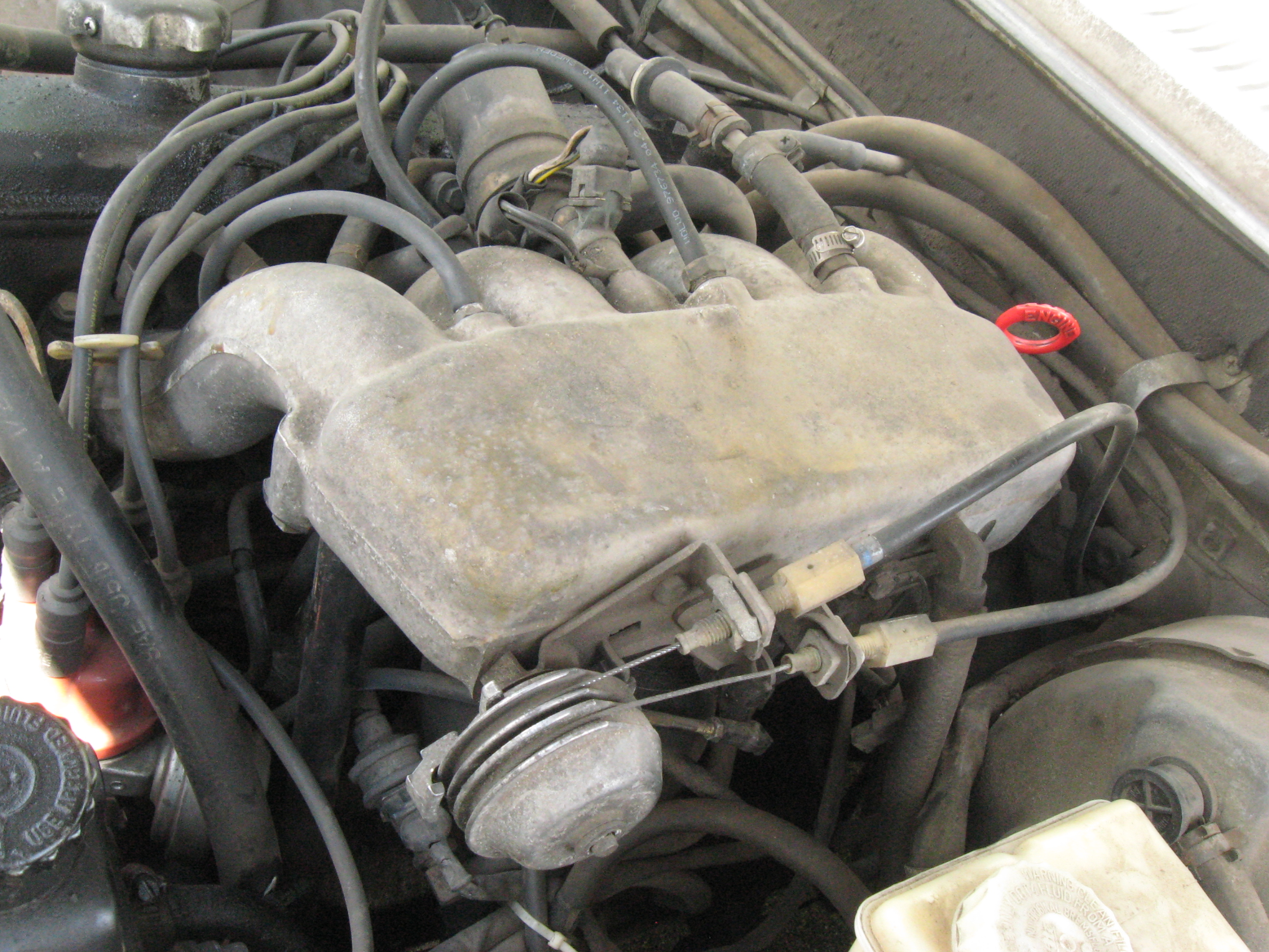

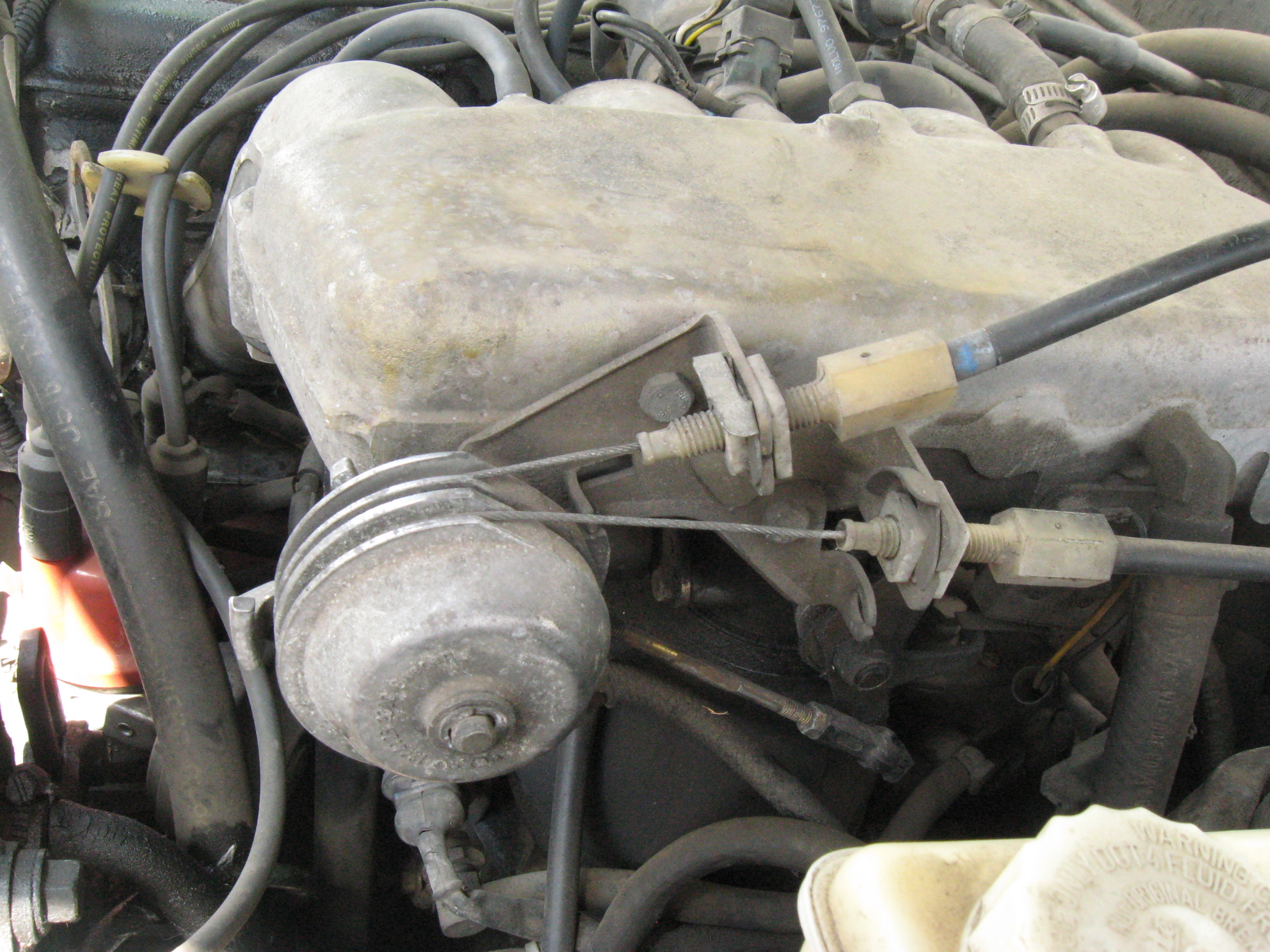

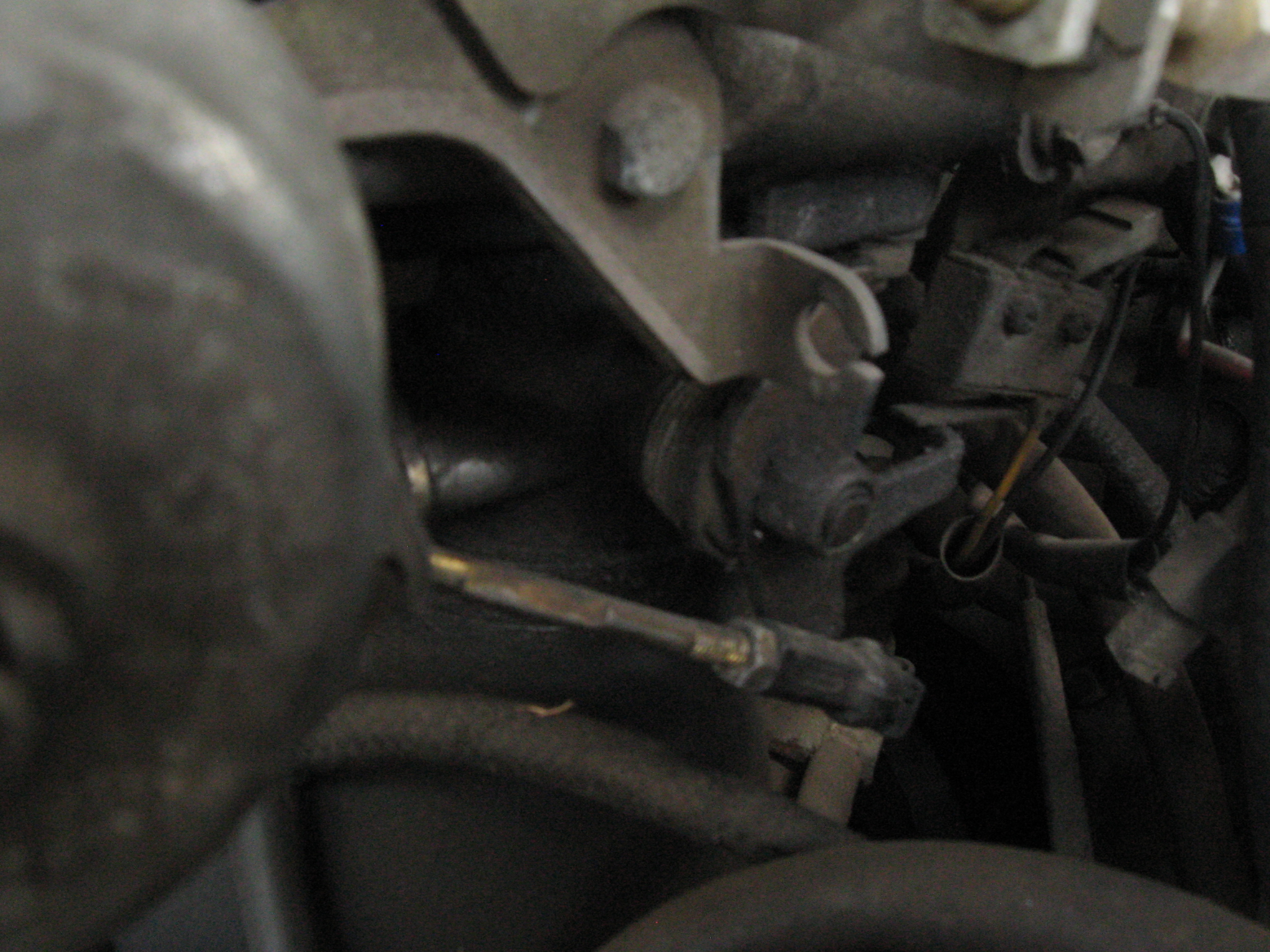

So a few pics to show what kind of setup is going on here.
I can't figure out why I can't locate this black plastic knobbed "idle adjustment screw" that I've heard mention of and the Haynes manual shows. I can't locate it.
Also can't figure out why it seems the throttle isn't stopping at the end of the little adjuster screw on the throttle body, or why the black throttle position switch is out of adjustment. It seems if all these things are out, why did the car run perfectly for the last year or more?
Very strange, not sure what's going on.
