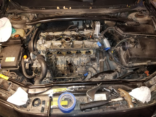

Started the PCV job on my 2004 S60 2.4L NA last night. Something where different between the NA and the Turbo version instructions I have seen. Spent at least 20minutes trying to figure out why I couldnt get the intake off before figuring out there is a bolt underneath the intake tied into a pedestal bracket. I dont think the turbo version has this....anyway had to pick up a few new vacuum lines from NAPA on lunch today to replace the two that disintegrated while trying to remove. Should be quick to button up later tonight (fingers crossed).
