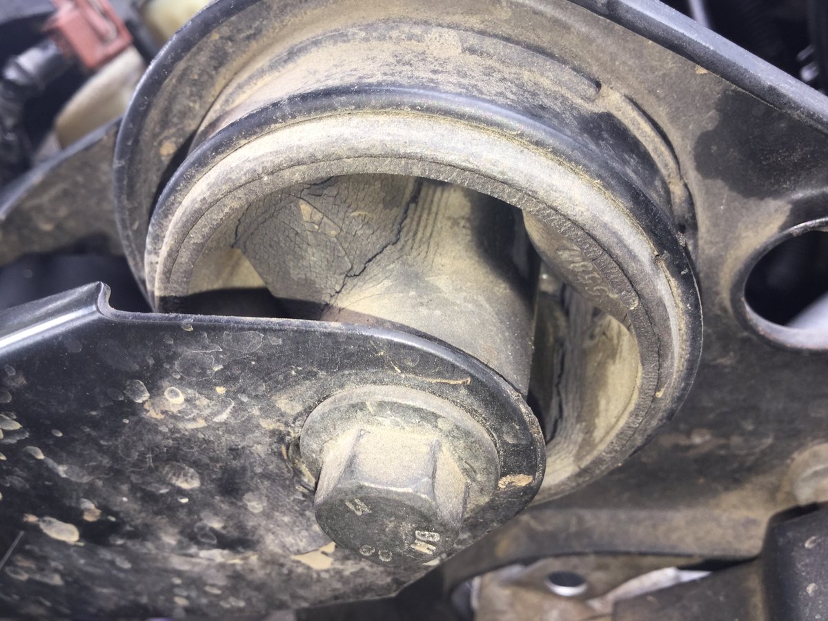

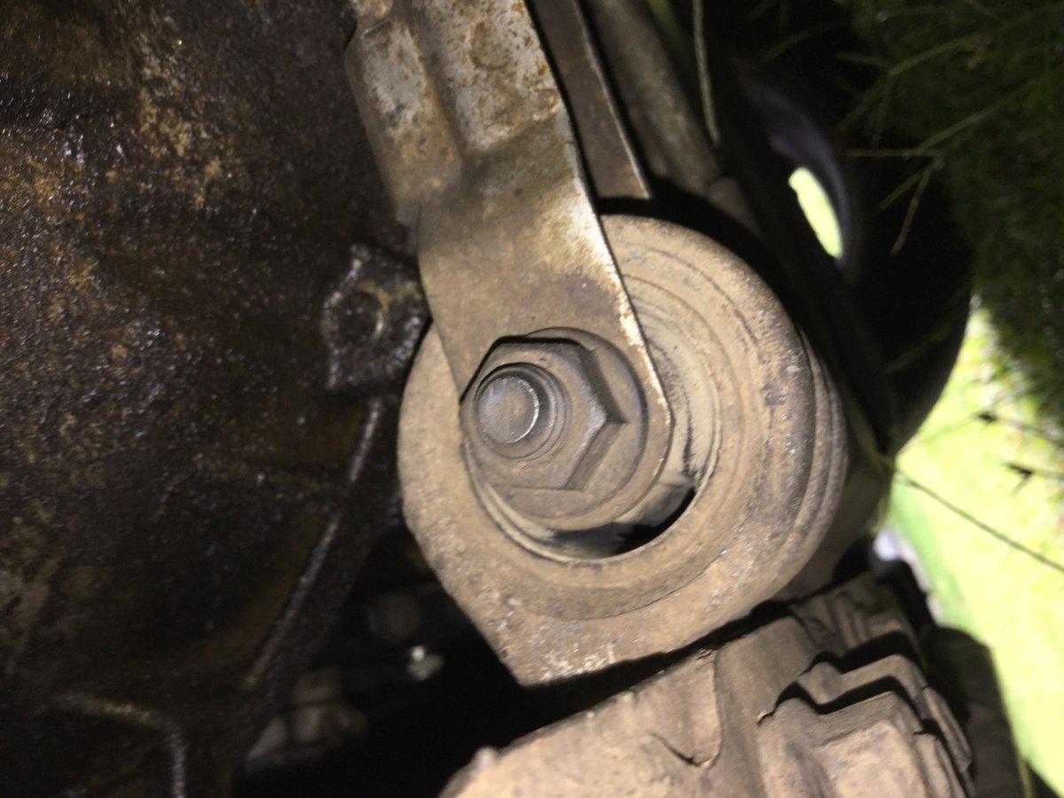

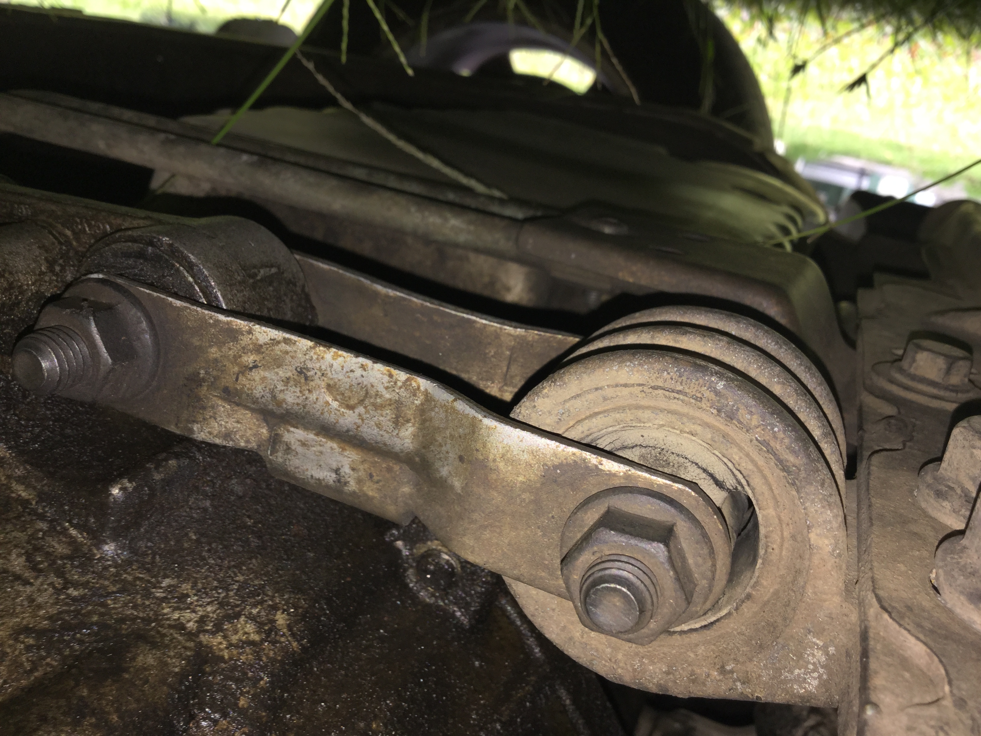

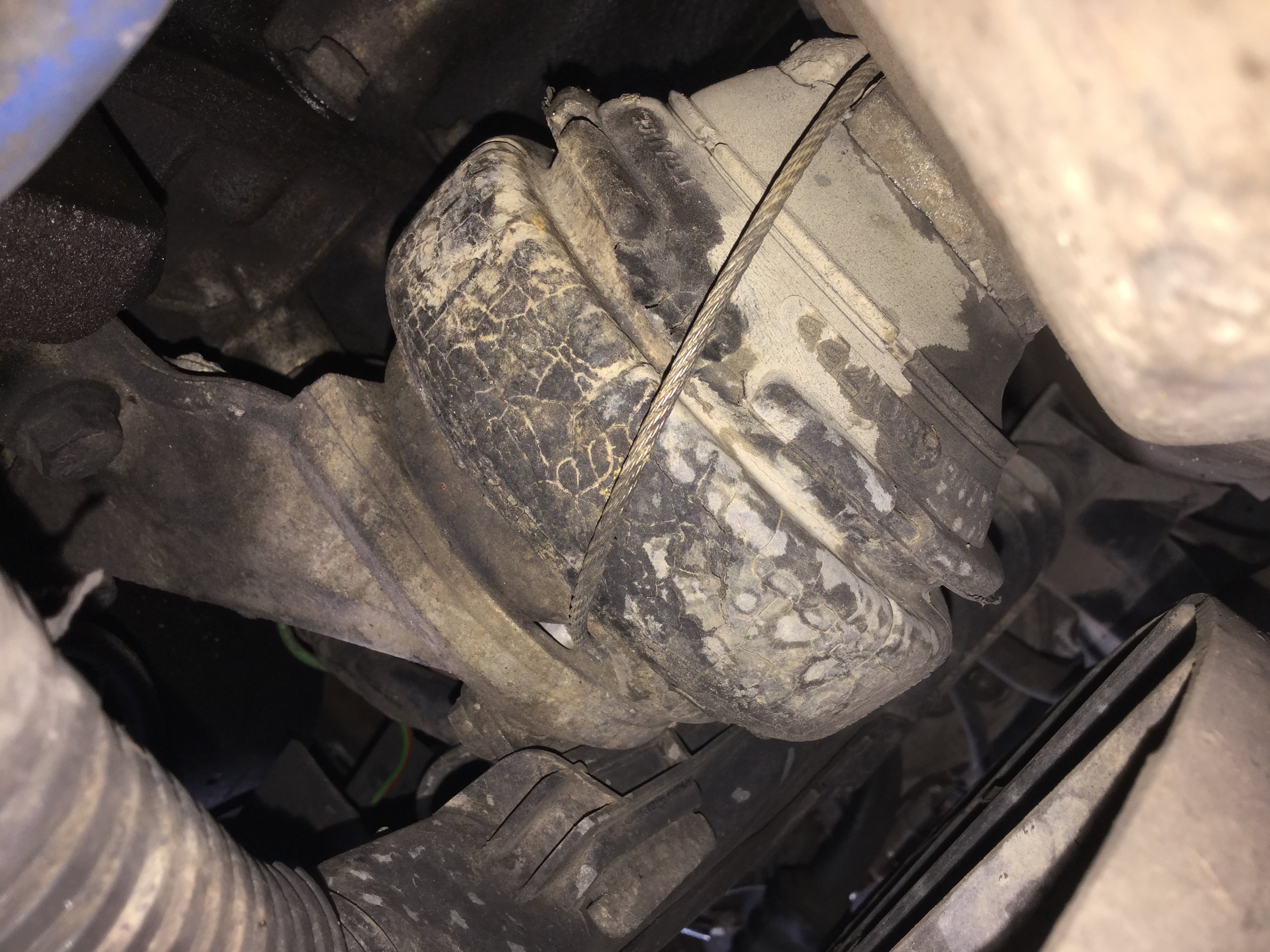

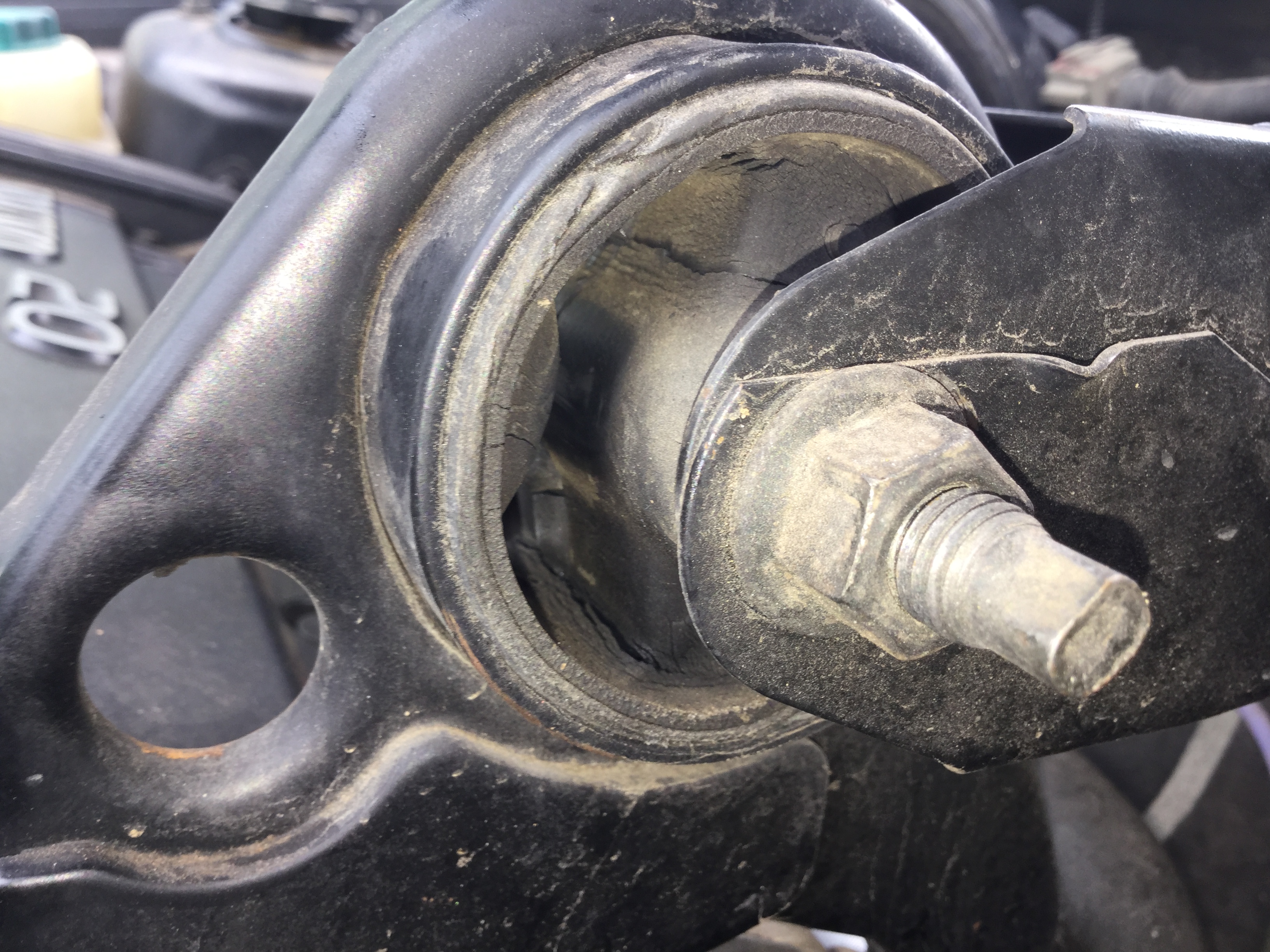

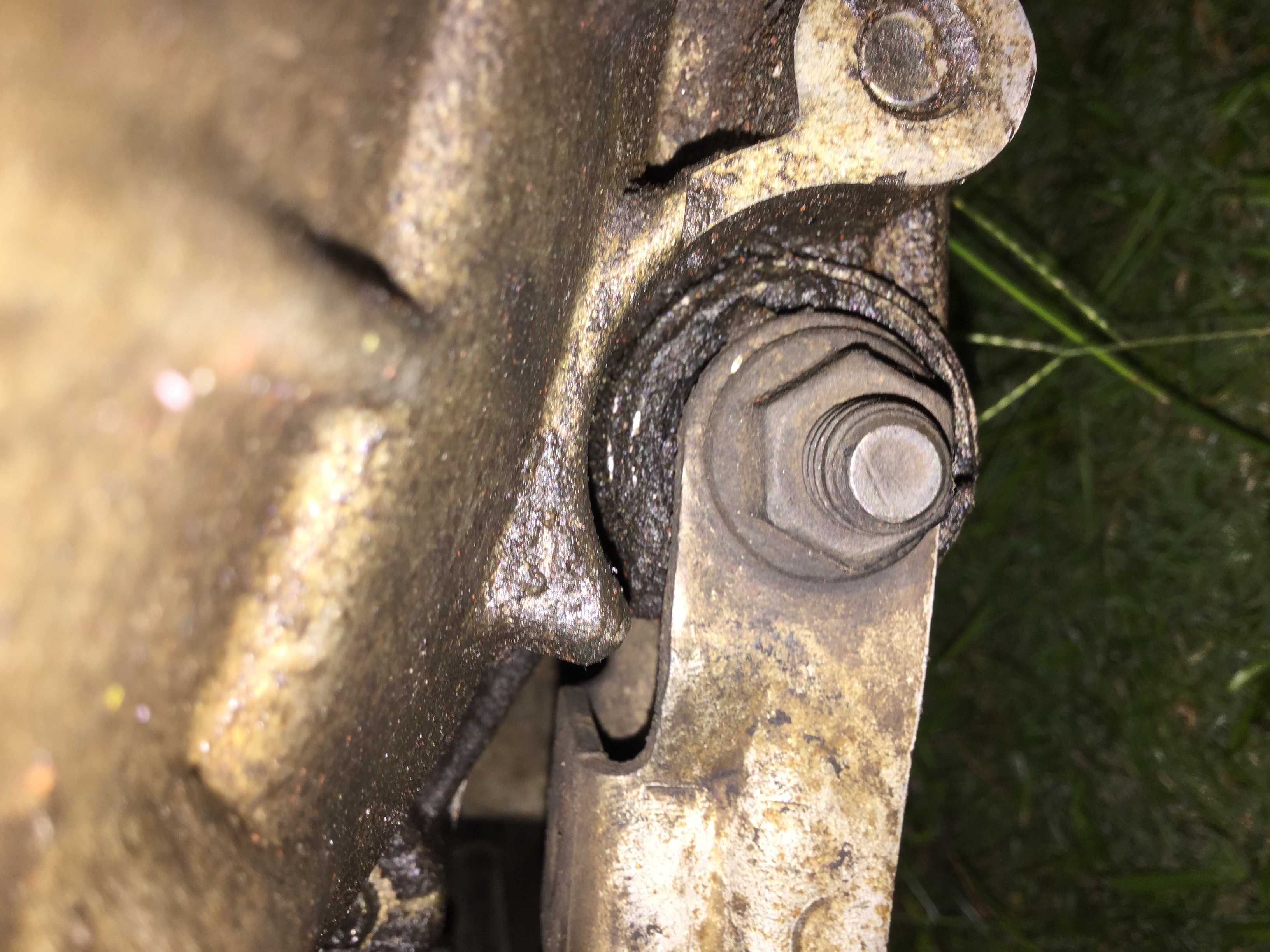

I attached photos of the mounts and such I could easily access. Looks like there is a tear in the top motor mount bushing (not torn all the way through though). On the transmission torque mount, it was harder to tell how the bushings are, the little one was covered in oil from a flame trap leak that was fixed. Also posted a pic of the lower hydraulic motor mount just behind the radiator.
It does make the noise if I accelerate in 2nd gear (one click) and then release the accelerator and after a second (another click). I'm actually not sure if it does it when braking though, will double check that...
