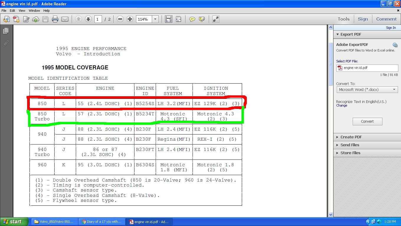

Fire up VIDA, set the profile for Partner group AME, 850, 1995. Look at engine options, the B5254S was not an engine option for a 1995 AME 850 . While you are in VIDA look at the engine management options.
How go back to the VIN decoder and try finding a engine code for a B5254FS, there is not one. If you have a explanation for the discrepancies that is better then Heinz 57, lay it out. However you should know ad hominems won't earn you any points here.

Erikv11....i can only say that my engine number is 746xxx and it's from '97 with M4.4.All '97 n/a were M4.4.
This car have engine number 783414...and it CAN'T be made earlier in the '95!!!
Engine number from this car is pointing that it can surely be from '97+...possibly from '98,since '99 were different.
Since the engine number doesn't match with it's production date provided by VIN,it could easily be that engine and management were swapped from a newer donor,BUT wiring remained the same from original management.
And also....all '91-95 n/a engines were B5254FS...not B5254S.(S) were FROM '96.
'95 n/a doesn't have independant MAF....instead...the MAF from '95 n/a was in one piece with airbox....and they are NOT interchangeable because they have different values and different measuring.
I checked out the wiring diagram for a '96...M4.3 DID exist in n/a BUT it was in a '96.

'95 n/a wiring diagram clearly shows LH 3.2 Jetronic management:
'95 Turbo shows M4.3:
Another one for '95:
