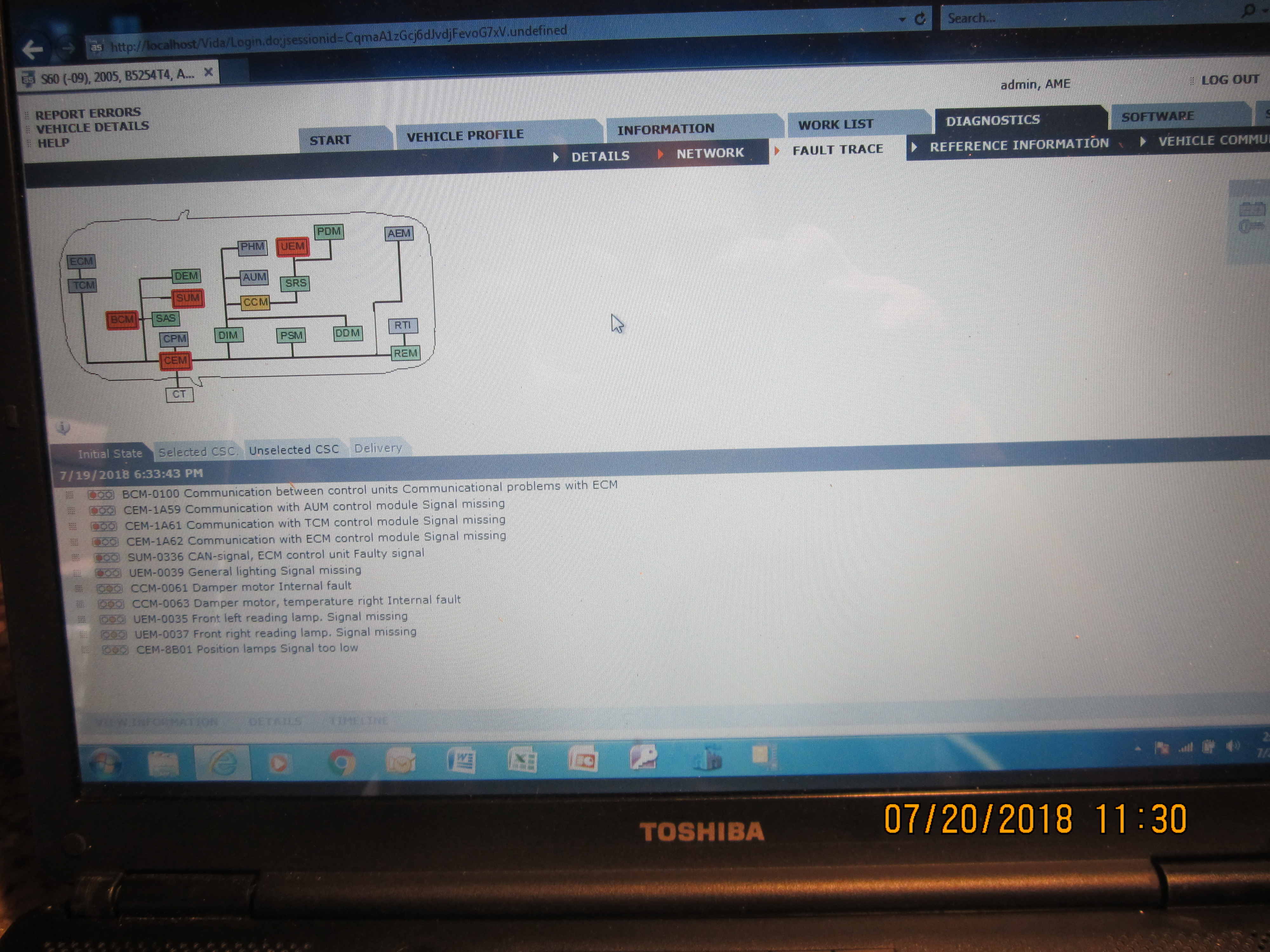

was getting transmission message so thought should clean contacts on the fist TCM so got the removal tool but could not fit it to the TCM without first removing the ECU. So removed both cleaned contacts let dry replaced and now will not start with immobilizer message. Hooked up VIDA can read but will not erase faults. Disconnected battery will leave till morning and hope it is back to normal. Anyone have an idea on how to correct this (no go to stealer ship please)

Post up the VIDA screen so we can see what messages are coming up.

Above my pay grade, let Yagger or similar experts put their heads on this one.
I see a lot of commonality with the CEM onthecerrors that are major
