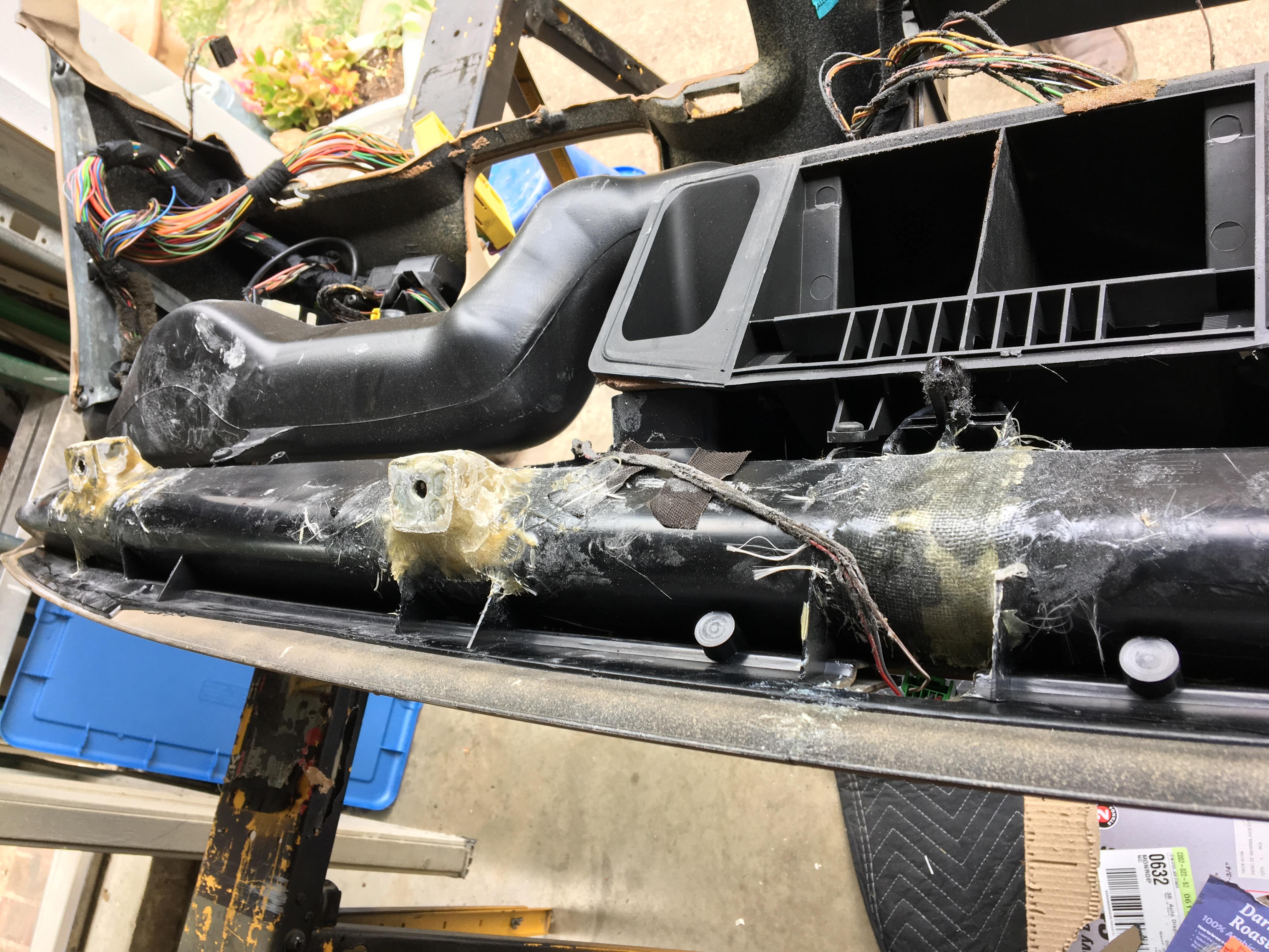

I finally took care of this repair this past weekend, and I am very pleased with the results! It's like I'm driving a completely different car!
My mounts were totally destroyed, likely related to this car previously being involved in a front end collision. With some assistance (I barely had the patience to repair the mounts alone) I was able to repair the mounts using a similar method to the one shown in this thread.
I first glued the remains of the plastic mounts in place with some JB Weld Plastic Weld epoxy. I feel the ABS adhesive the OP used would have been better, but I couldn't find any locally.
Once that cured (it cures in 20-30 minutes, perfect if you need to finish this job relatively quickly), I made metal brackets with a pre-drilled metal strip from Home Depot and glued them in place over the plastic mounts.

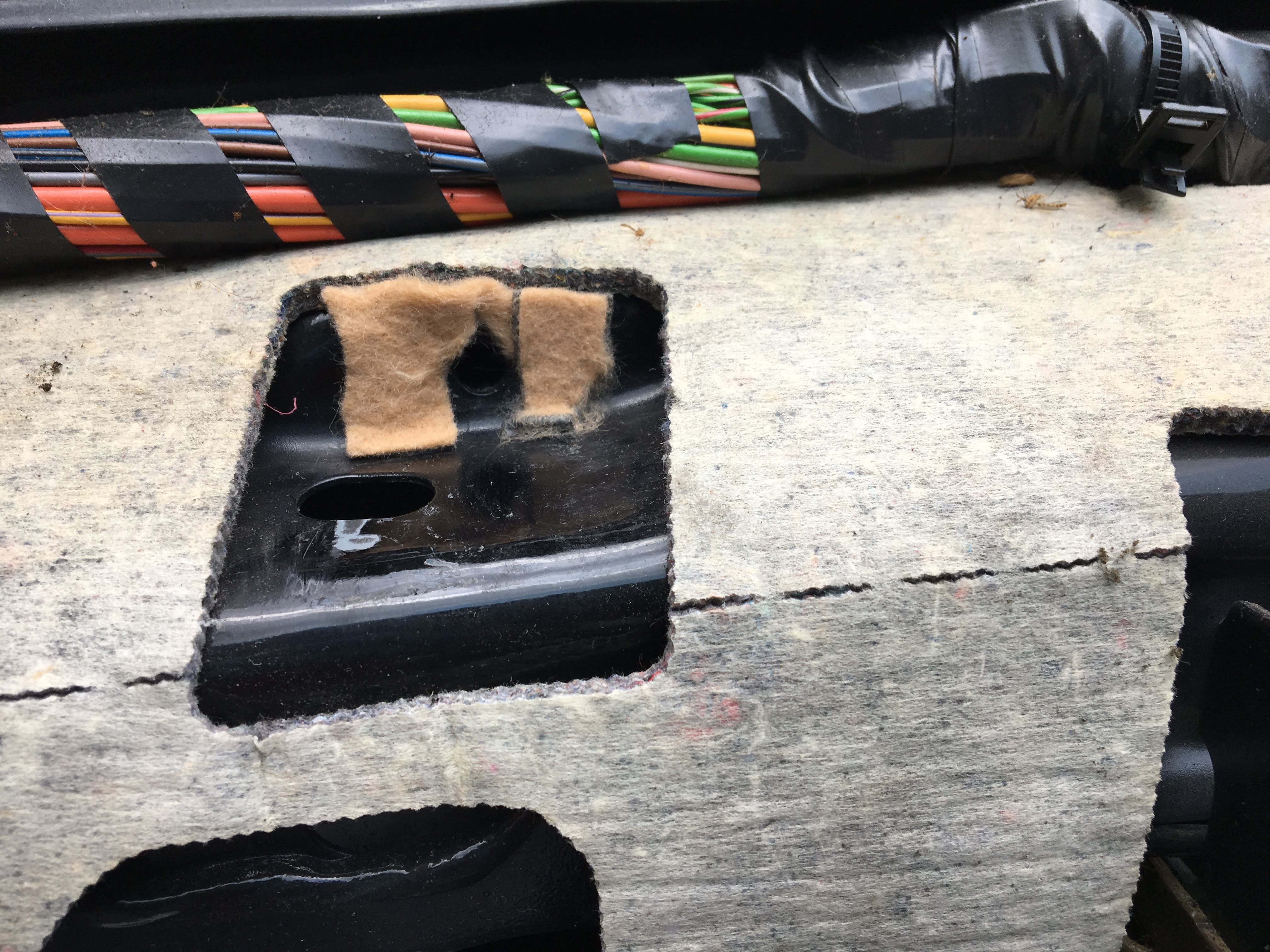

I had a leftover Bondo fiberglass repair kit from another project car, so that worked out perfectly to further reinforce the dash as shown in this thread. I added some pieces of a craft felt sheet to the mounts on the firewall, using some Scotch Extreme double sided mounting tape. Nothing much, but it offers about the same amount of "noise buffering" as the small felt pads that were there from the factory.

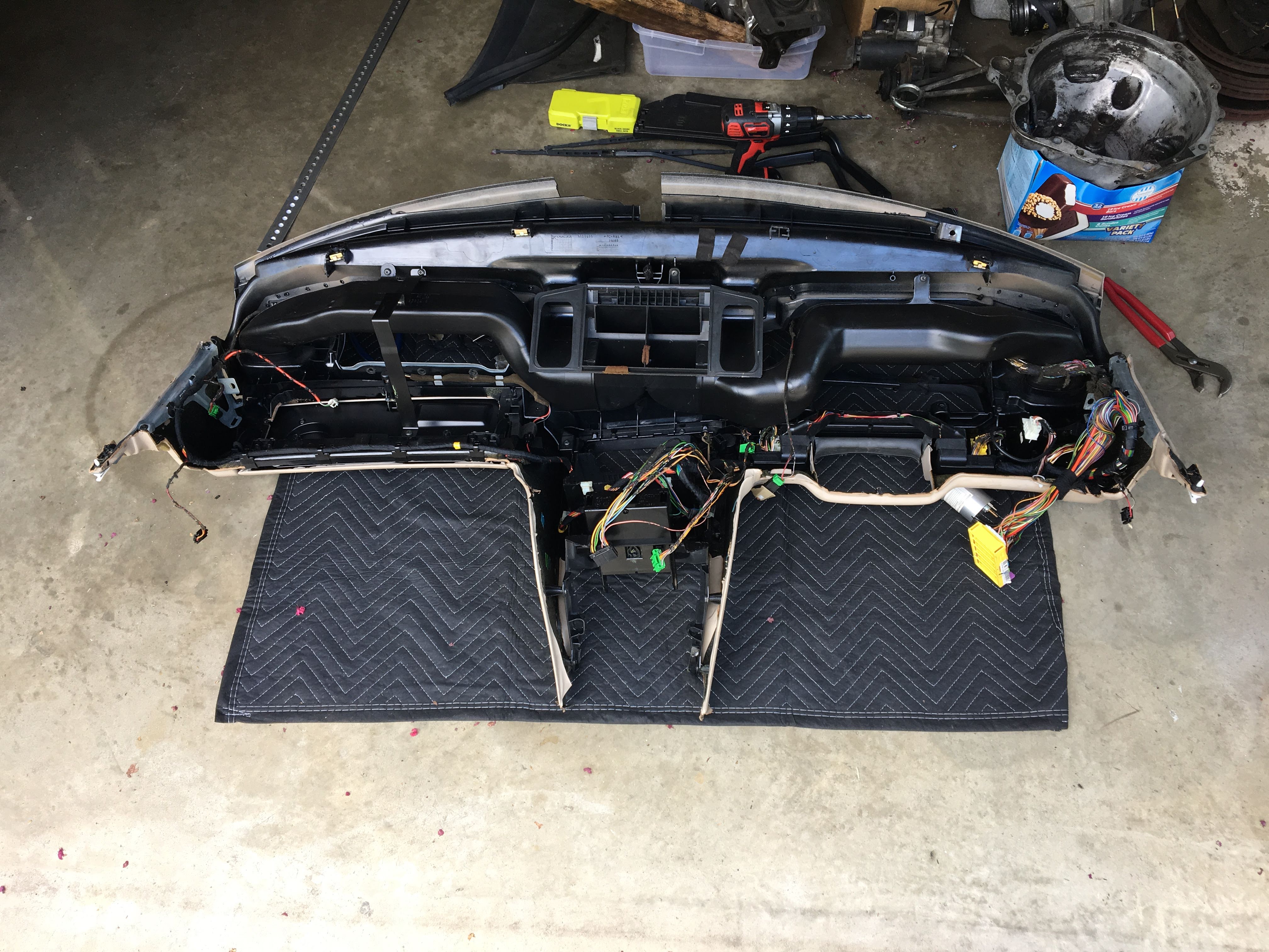

I let it all sit overnight and did some final patch work yesterday morning, then reinstalled everything. R&R isn't hard at all, it's just a little time consuming. I got it all replaced in probably 45 minutes, but I have pulled these dash pads and steering wheels several times before, so that part was quick and easy for me.
One screw (second one in from the driver's side) didn't line up quite right, but the other three hold the dash good enough for me. The screw didn't seem to thread in, but I can't get it out, so I'm not going to worry about it. The wiper linkage is in the way, and the only way to get on the bolt with with a flex head ratcheting wrench, which is one of the few tools I don't have.
The dash is now virtually silent, and roads which previously made me want to stick ice picks in my ears are now tolerable (these roads are still poorly paved!).
