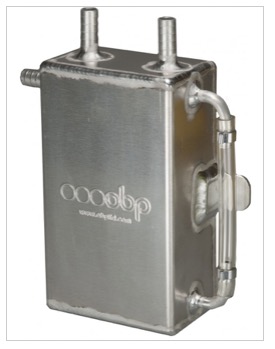

hy,
i have a question about this PCV : wouldn't be useful to install behind the engine block a bottle to catch oils steams before send it back to the engine ? Wouldn't solve the PCV issue for a while ?
Manov
Manov

It sounds like you are suggesting to install a catch can in addition to the existing PCV. This is a reasonable idea and has been done many times. Sometimes done well (some really good examples at Volvospeed), sometimes not so well.
Search "catch can" and your car model of choice for some examples, there have been some clever implementations.
