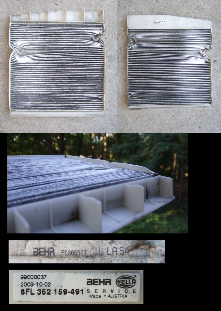

I don't believe this car has the quality monitor feature- that wasn't listed as being included when it was bought and the button only has one light. The light comes on when you press it and goes off when you press it again (although if you hold the button for exactly 4 seconds the light flashes a few times for some reason).
The cabin filter itself was forgotten about for ages and is quite old. There are two areas of text on it: printed down one side, and on a sticker on the face. The side printing starts with something I can't make out, then becomes ">PP PES< BEHR P0806001 LA54 16075". The sticker says "99000037 2009-10-02 8FL 352 159-491 BEHR HELLA service Made in AUSTRIA".

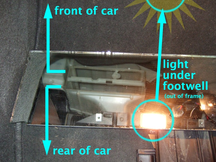

Taking pictures of the slot under the footwell was a real pain since I had no camera with a wide enough lens. I had to use a mirror. Hopefully my labeling makes sense. The larger forward slot is blocked off.

Thats the skinny pollen filter, last changed in 2009
Yuck

abscate wrote: 23 Aug 2018, 18:49 Thats the skinny pollen filter,
What confuses me is that it's neither 1 or 1.5 inches, and again the thinner slot is not where IPD says it should be. Do the number/codes/shape say something definitive?
abscate wrote: 23 Aug 2018, 18:49 last changed in 2009
Yeah that's not surprising unfortunately. The last time it was brought to a dealer was in like maybe 2010 or something that's probably the filter they put in. I forgot that filter existed and didn't remember until a week ago.

Probably nothing to be gained from fretting about what came out from where and if IPD is right or wrong about your car. This is a good time just put in another one and enjoy filtered cabin air. If you want to use the skinny filter, install it in the thinner slot. For the other filter, use the thicker slot. Your car shipped with the skinny filter from the factory.

You can see the thick slot blocked off in your photo, too. If you want to use the thick one, you snap out the plastic blocking piece with a pair of Channelock (tm) pliers - made right here In this US of A States by the fine folks of Erie PA.

I don't know if I want the "thick" or "thin" filter, that's exactly what I'm trying to figure out. I'm not going to assume this car even takes either of the normal filters given that the size and location of the one I have doesn't match up with anything. I'm not even sure if it was the right filter to begin with. I don't know if this car has some weirdo slot that's different from what's normal, or if everyone's info is wrong, or what.
As it stands right now it appears that the "thin" filter might be too loose to properly fit into the slot, and the "thick" filter would require re-programming the computer. I don't want to buy or reprogram anything until I figure out what the heck's going on. I'm hoping someone can help with that.

It's not supposed to be a squeeze though.
If the slot for the thick slot is blocked you get the thin filter and vice versa. If you're unsure of dimensions order from somewhere they've got that covered for you.
