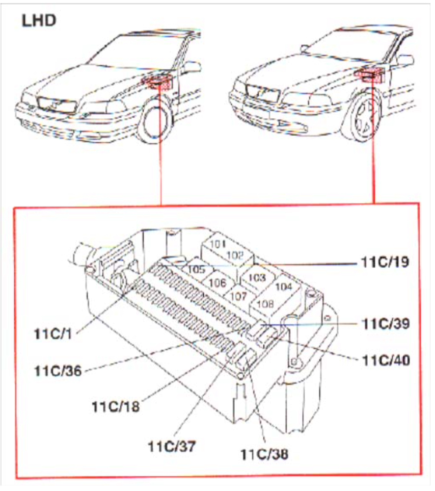

If you suspect an aux relay, I believe that 2/30 is the one you want.
It’s called out as 105 on the attached chart. It can be swapped with
the adjacent 106 relay to confirm your theory.

Perfect, thanks! Will swap out 105 and 106, and then hopefully find it's only a relay and not the ignition key switch. Report back next Monday.
