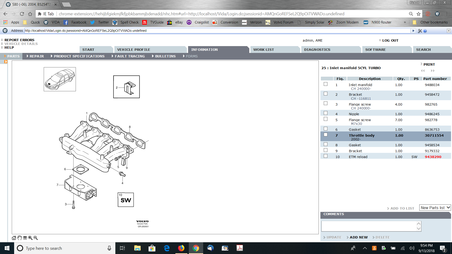

The part sites I've viewed warned that the Body may need to be programmed prior to use.
But Xemodex's part listing states that "No software reload is needed."
If I understand it correctly, S80s prior to 2002 used a throttle body like this one and require a software reload/programming, but newer S80s use a throttle body like as shown here.
So, my question is broken into parts:
1) Will this resolve the P2111/P0420 issue?
2) Who is right? Does the newer Throttle Body need software, calibration, or neither?
3) If it needs to be programmed/calibrated, is this something only a dealer can do? Or can a European car mechanic do it?
4) If I get a used, working throttle body, can I have that installed and go? Or does that also need to be programmed?

I saw one diagram in which it looks like it's on the front of the engine, where one would tug to idle the car while running and with the hood open.
