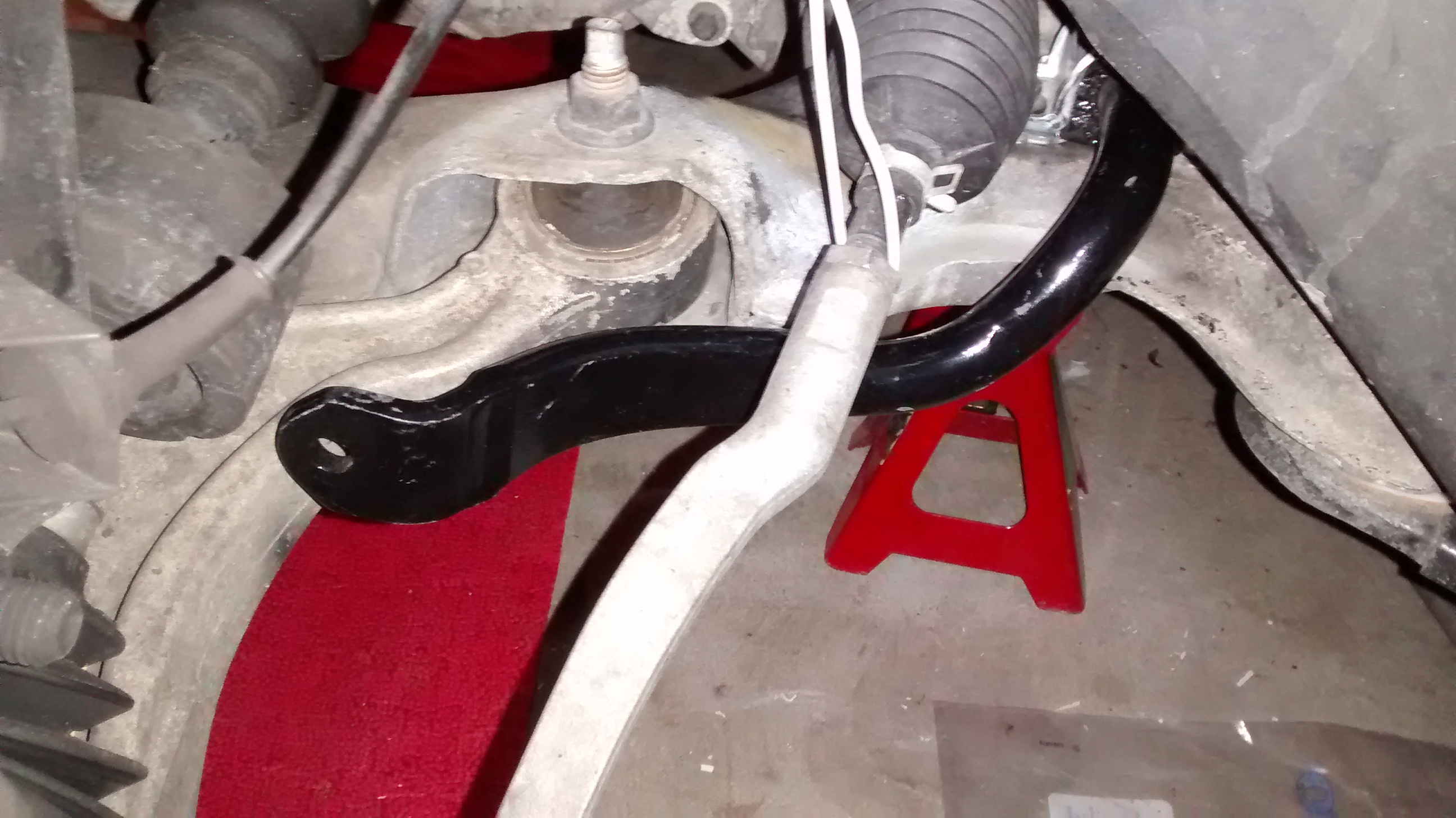

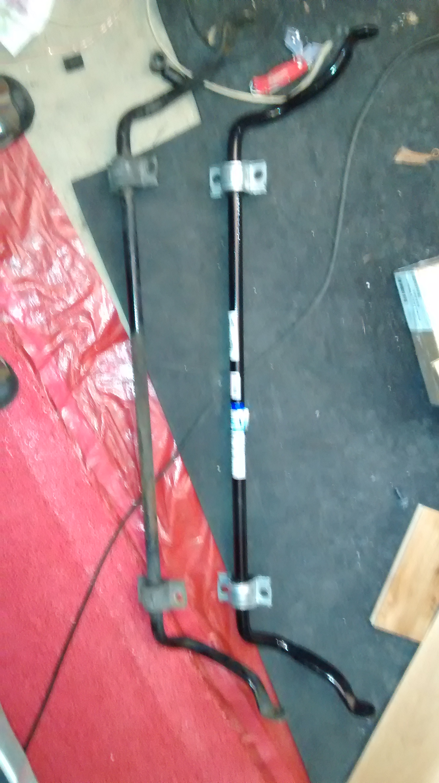

I installed a new XC90 sway bar (P/N 30635778), with a great success. Though its diameter is the same 23.6 mm like original sway bar in my 05 XC70 had, it is much heaver, 2-3 pounds more, has more thick "arms". Also someone did a Rockwell hardness test, XC70 is less tempered than XC90's one.
Car is way more stable on a bumpy road, cornering remarkably is better. Also, what is more important to me, there's almost no additional road noise in the cabin. It's just a tiny bit noisier, due to new intact rubber bushings. I don't want anything poly in my car.
Of course, now I have a problem with what rear end does in corners, but I'm going to address that with rear sway bar from V70R.

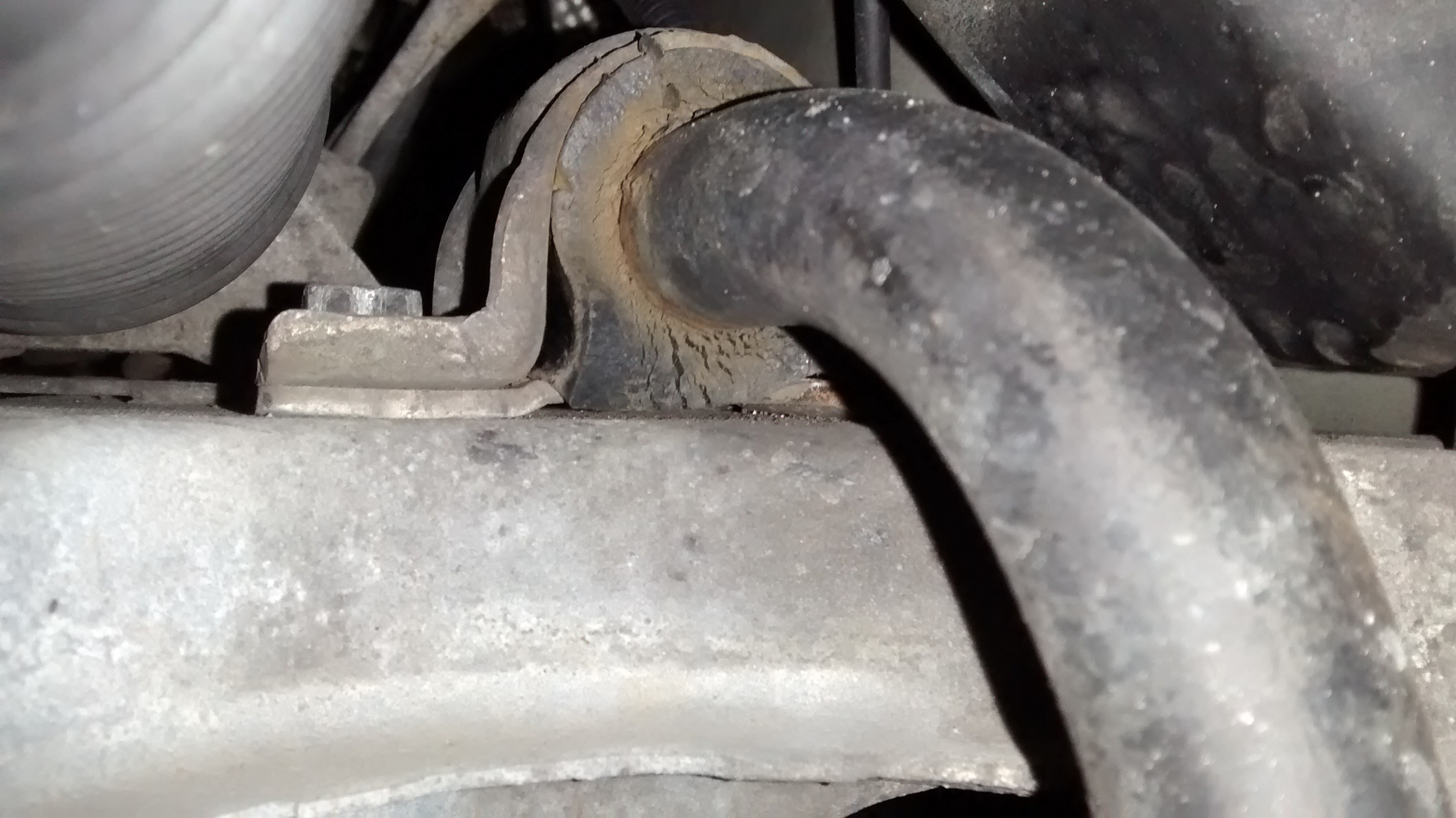

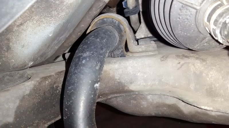

So the XC90 sway bar bushings died in one year. Rattles are all over the place, both LCAs have scratches from the bar touching them
I could not figure out first what this noise was, and did another suspension and steering rebuild, plus put new engine pads, subframe bushings and rear o-rings, all from blue boxes - no luck.

I replaced the sway bar with a new one. Old was in a good enough shape in fact. It was on the car for only 1.5 years, but did see a fair amount of gravel roads and generally some inspired driving. It was touching LCAs because last winter I installed it during my "chassis swap" as close to engine as possible - don't do this, move it as far from engine as you can.
