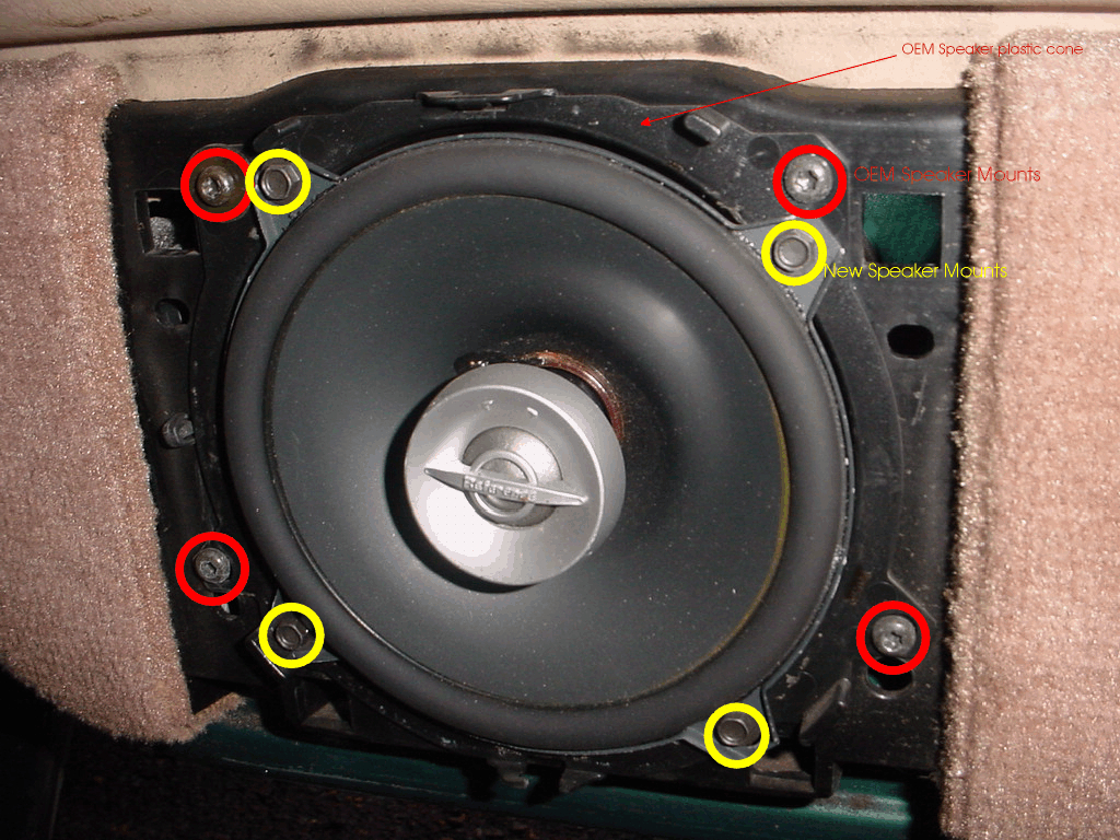

On the rear doors you can use 5 1/4 but you need to use the old speakers to make the mounting work. I basically carved the old speaker out and then used its OEM frame to hold the new speaker. At one time I think Crutchfield had some adapter plates but I'm not sure they have them anymore. As I recall they were nearly as expensive as the speakers.
Rear Speaker.JPG (1.01 MiB) Viewed 536 times
...Lee

I think these Crutchfield brackets were for 4 inch speakers.
Nice hack, Lee!
