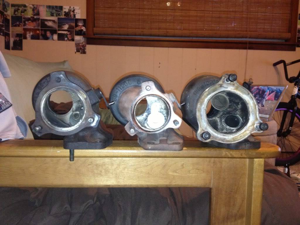

Flanges are all the same diameter and bolt pattern at the exhaust manifold, the only difference is angled, straight or conical on the downpipe side. Conical is smaller diameter on the downpipe, too. They are all interchangeable otherwise.
Conical outlet flange: All 94-95 850 turbos
Straight outlet flange: All 96-97 850 turbos, All 98 x70 turbos
Angled outlet flange: 99+
some pics:
some pics:
