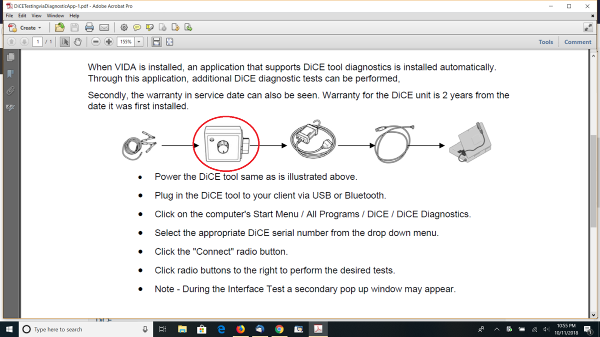

That response is expected for a Interface test without a diagnostic connector on the OBDII end of the DiCE unit. The clone units do not come with the diagnostic connector, most likely because they don't have the information to clone the diagnostic connector.
The LED, Memory and Communication test will run without the diagnostic connector.
If the LED, Memory and Communication test work .. your power supply is good enough.

xHeart: the equipment circled in red is what you are missing. It is needed to do the Interface test.
