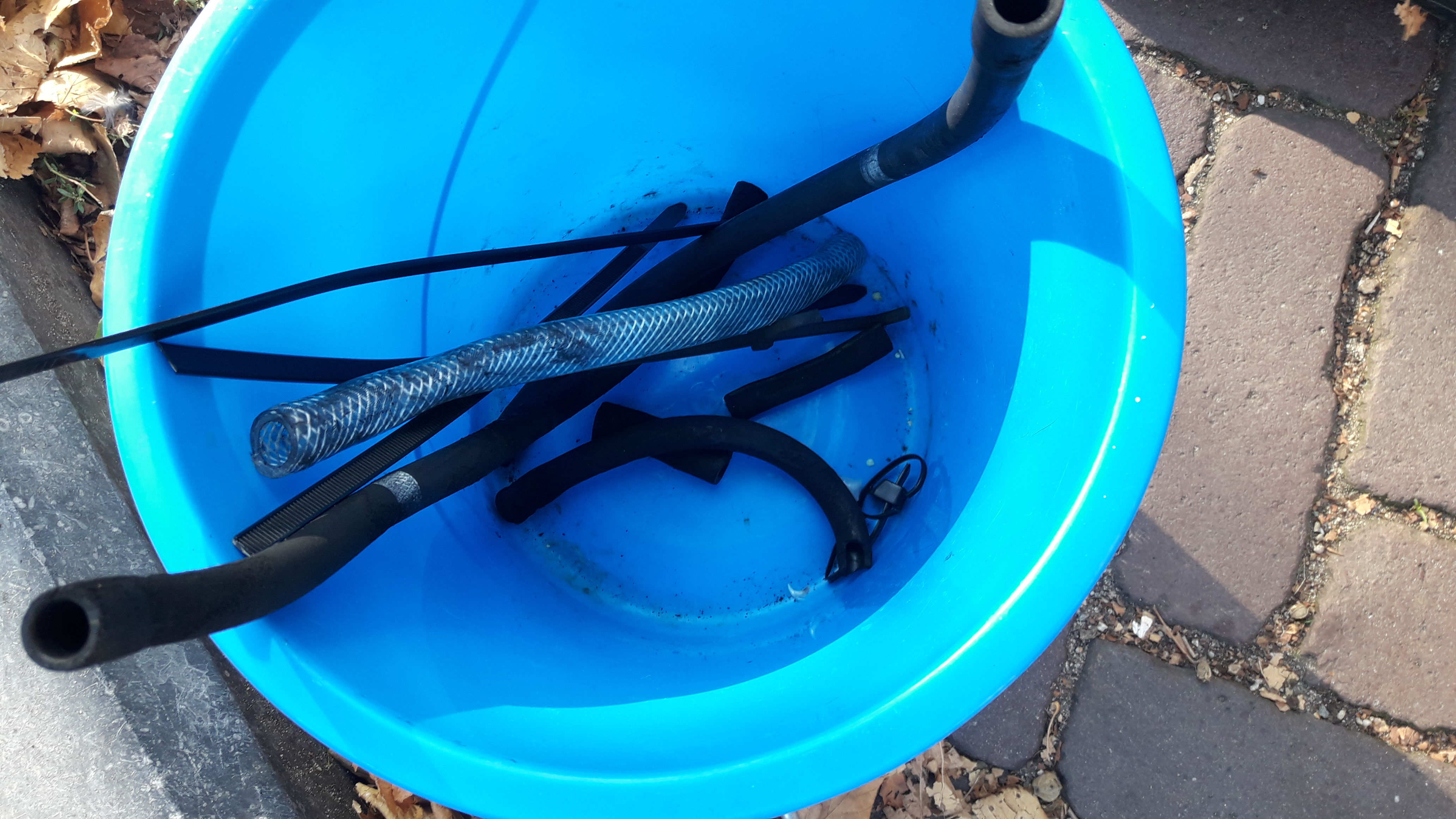

Changed out rotten vacuum hoses for new ones.
The transparent one was put in 2 weeks/ ~1200km ago as a temporary fix untill new ones came in, and it already almost collapsed!

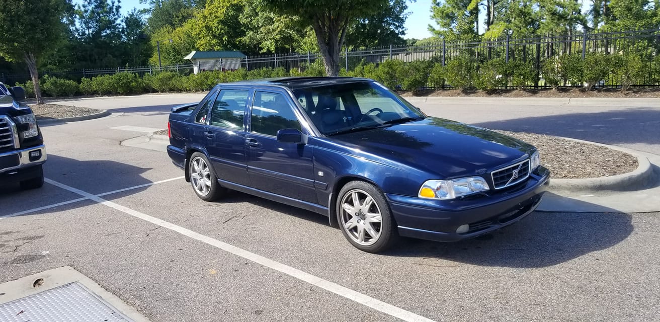

Finished the engine swap and got her running again
Nice to have it back on the road, new engine has gobs of power and runs very smooth.

Nice! What engine did you use, just the stock B5234T3?cmblackburn wrote: 14 Oct 2018, 13:27 Finished the engine swap and got her running againNice to have it back on the road, new engine has gobs of power and runs very smooth. 43950410_10217505483809363_592902514177736704_o.jpg
Got my R running again today! Started right up, and it only has 3 codes! One for intake air temp sensor and the other two for lack of communication with the transmission (obviously...).
The car won't move unfortunately, but I think that's due to the passenger axle. The car still rolls when it's in gear, and only the driver's side axle is turning, so I think the issue is the AW55 pass. side axle that I reused. The driver's side AW55 axle seems to be just fine.

It is a B5234T from a '96 855 Turbo that had been sitting pretty much buried in the dirt in a junkyard since 2011. Took a chance on it for $350, and I'm glad I did.bmdubya1198 wrote: 14 Oct 2018, 16:32Nice! What engine did you use, just the stock B5234T3?cmblackburn wrote: 14 Oct 2018, 13:27 Finished the engine swap and got her running againNice to have it back on the road, new engine has gobs of power and runs very smooth. 43950410_10217505483809363_592902514177736704_o.jpg
That's pretty odd, axle splines seated okay in the transmission?

The axle seems to be in the transmission fine, but it may not be seated in the wheel hub. I'm going to pull the wheel off again today and see what's going on.
I just realized that I won't be able to use the AW55 axle anyway since the outer diameter is a lot smaller and the axle seal will just pour out fluid. Out with the axle again... crossing my fingers the correct axle will allow me to drive the car now!
