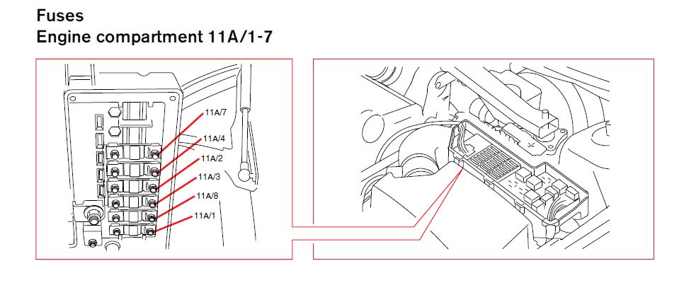

I looked at the diagram and there might be a common +Battery point for these. Under the hood, in addition to the fuse/relay panel on an '01 there are also another panel buried somewhere in there with 7+ large amperage fusible links similar to what my '06 has back in the trunk next to the battery.
Fuse 11A/4, a 60 amp fuse, is protection for sub fuses 21-29 located in the passenger compartment which includes, or feeds something else that eventually supplies all of the items you listed, including a power feed that is controlled by a relay on the CEM that goes to the instrument cluster.
Now, unless it's something like corrosion or a loose bolt causing an open circuit, these large fuses don't normally blow unless there's a dead short to ground somewhere down the line that you'll need to find and correct.
At the very least, check with a voltmeter whether you have 12v battery voltage on both sides of that fuse.

If you have power at fuses 21-29, I'm at a loss. I'm not sure VIDA will give you much to go on other than these modules aren't responding.
In your first post you stated if you put power to these items they will turn on, but otherwise not. Can you elaborate where you're applying power? At the module or somewhere up the line in the wiring or fuse panel?
I'm not ruling out there may be a relay involved, though either it isn't shown or I'm simply having trouble reading the diagram to find it. On the later model years there's a relay inside the CEM that can go bad that takes out (all at once) the power passenger seat, radio, cigar lighter/power port, and the nav system if equipped, while the climate control is on the 'main relay' that is shared with other items in the passenger compartment. Granted there are other major differences between yours and the '05+ I'm talking about, however there are more similarities than differences in the overall electrical layout.
