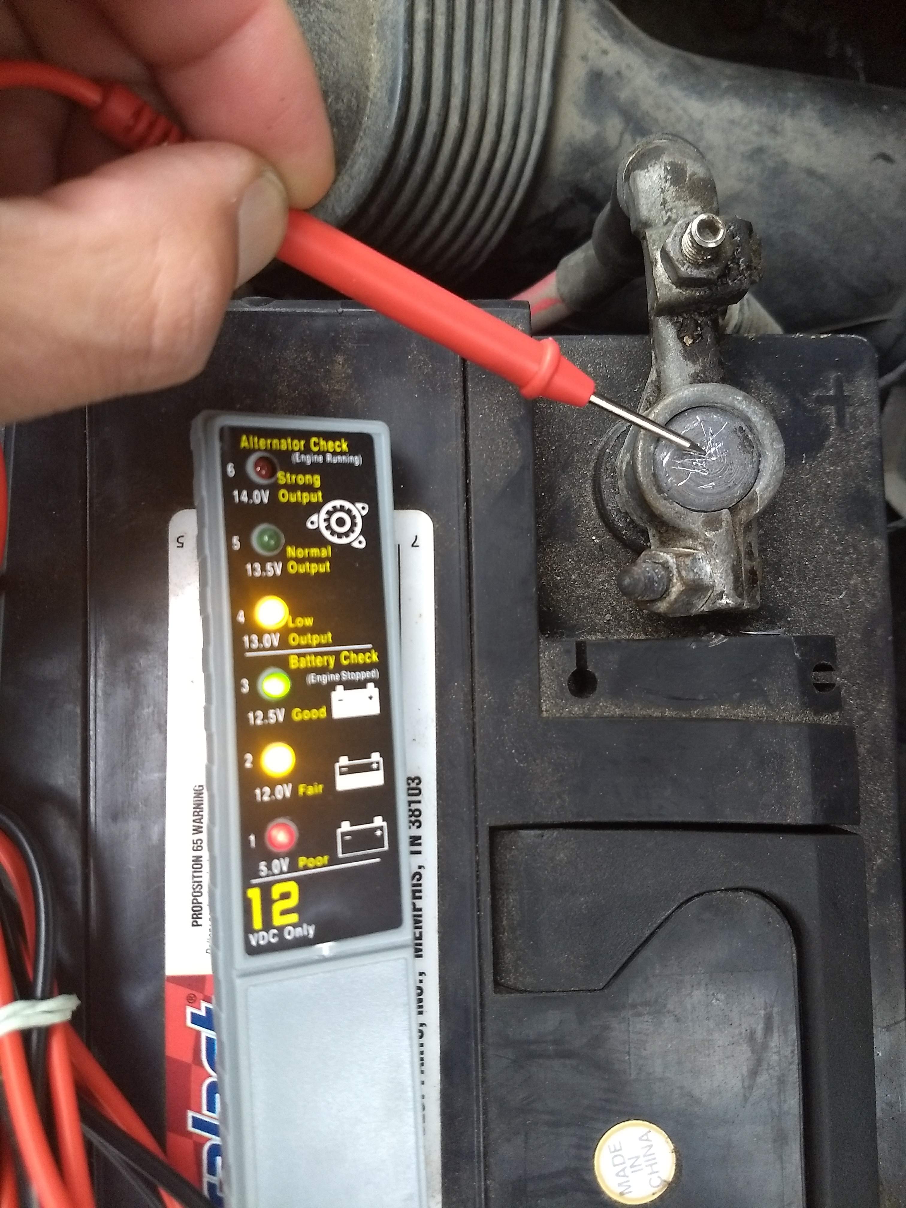

I picked up a simple battery/alternator tester to use on the project/donor '99 XC, and tried it out on the vehicles we currently use — a '98 V70 AT and '00 V70 MT. The older vehicle, which we've had for more than five years, checked out fine.
The '00 V70 had a low battery, which I charged fully. Next, I tested the alternator, and it gave me some bad news.
Any ideas of how long I've got to replace the alternator, or do I seek a second opinion?

I have one of those too, and I'm pretty sure it shows low on my V70 too. I'd use a digital multimeter to see the actual voltage it's putting out.brunocerous wrote: ↑26 Nov 2018, 16:17 I picked up a simple battery/alternator tester to use on the project/donor '99 XC, and tried it out on the vehicles we currently use — a '98 V70 AT and '00 V70 MT. The older vehicle, which we've had for more than five years, checked out fine.

If that battery sat for a while and sulphated it will pull the alternator voltage down. A voltmeter is the right tool, indeed. I’ll add it to the kit.
