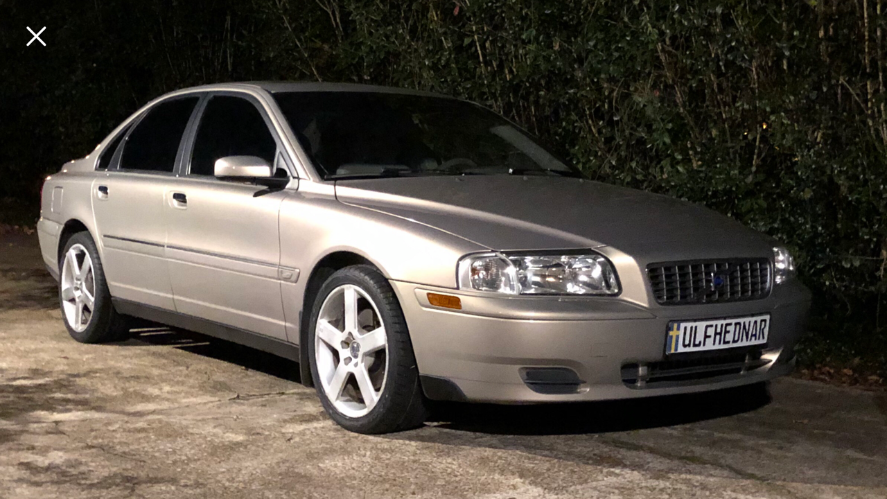

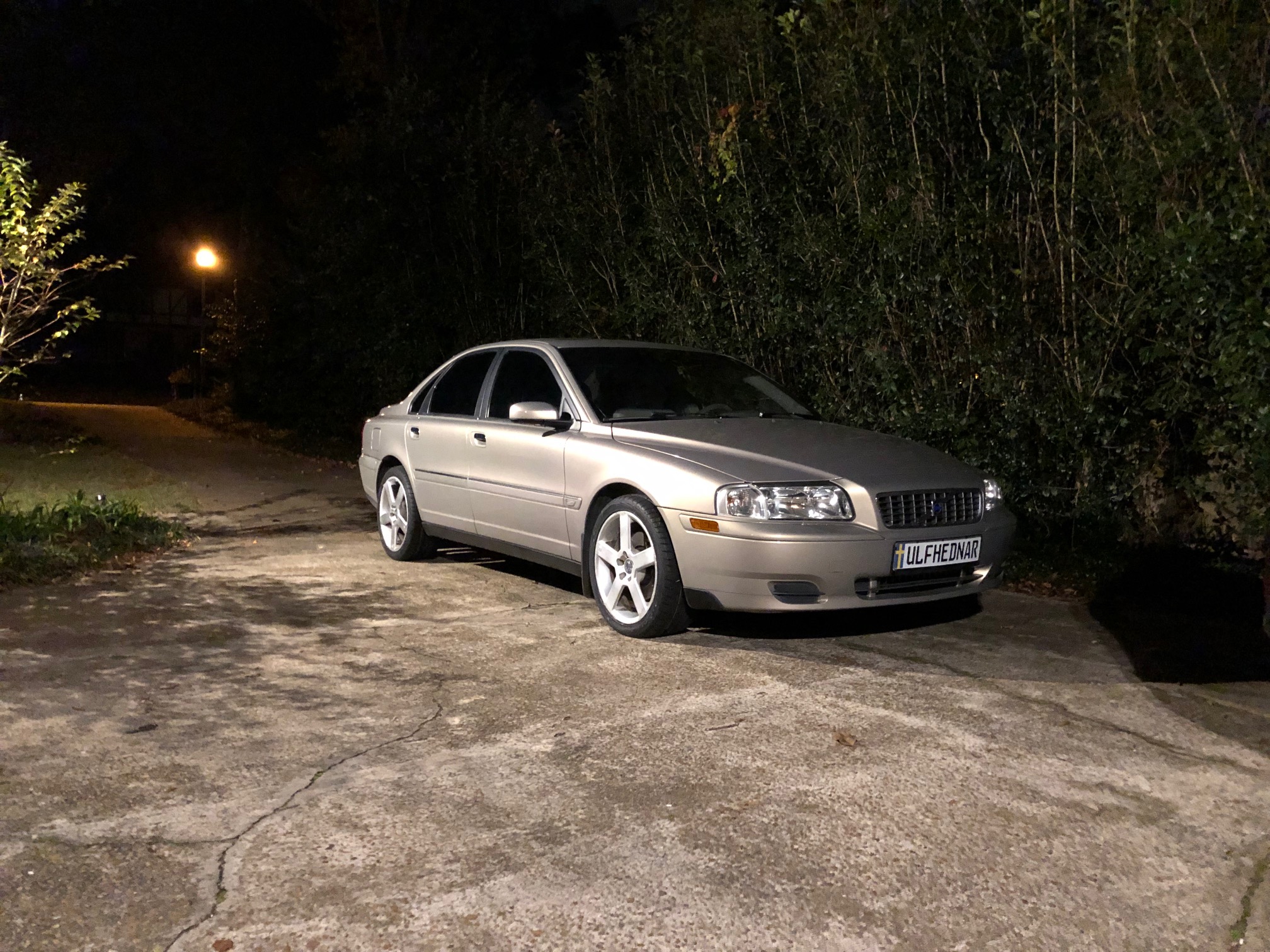

Happy to oblige! I've attached two pictures to this post (hopefully did that right!). I've also switched all of my interior bulbs out with canbus-compliant LED bulbs - huge difference in appearance and function. I've also replaced the H7 low-beam headlight bulbs with LED bulbs that have chips on all 4 sides of the bulbs. The light output is impressive and works with stock reflectors really well, provided that the beams are re-aimed to a lower point. I've got the canbus resistors attached, but need to drill a few holes in the back of the bulb cover to mount the resistors and heat sink to.
Ignition coil and spark plug replacement were wonderfully easy, I've had some V8's that were a major pain in the rear to do, but this car is great to work on, so far!

Looks good! I think the Pegasus wheels will work better on your S80 if they are a tad darker (anthracite / gunmetal). I like the facelift grill, looks better than the prefacelift grille imho.
