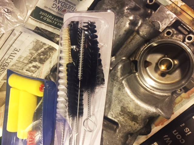

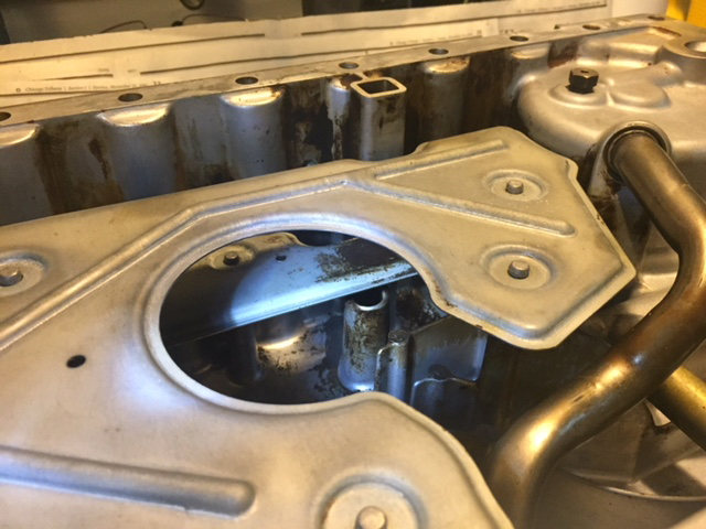

Second wash was with 1 part simple green & 2 part water. The rectangle pipe connection to oil trap is between "V & U" shape. It was semi clogged -- takes brushing to clear.
Cleared the immediate drops. Removed the oil pick up line, now on diaper to protect and prevent.

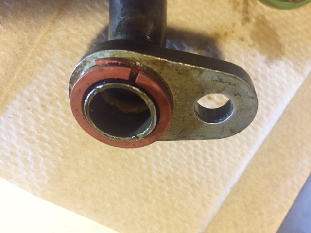

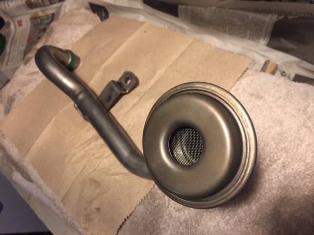

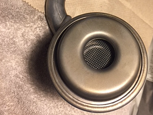

Pick up tube after soaking for an hour in 1:2 mixture, dry and ready with new o'ring.
Posts: 35267
Has thanked: 1497 times
Been thanked: 3809 times
Squeaky clean!
I’m not sure I understand your V and U reference. That’s not true. I’m sure I don’t understand it.

The two tubes, pick up and oil cooler, are curved. Same is not true for the crankcase passage -- straight down with relatively sharp turns. The crankcase passage dropping into the pan appears V like -- the picture x-2792 shows the other end below the shelf.
While scrubbing the block section I ran the pipe cleaning brushes into the crankcase and turbo return passages too. It extracted sufficient amount of dried stuff. The brushes came out loaded. These passages are now more open than previous.
