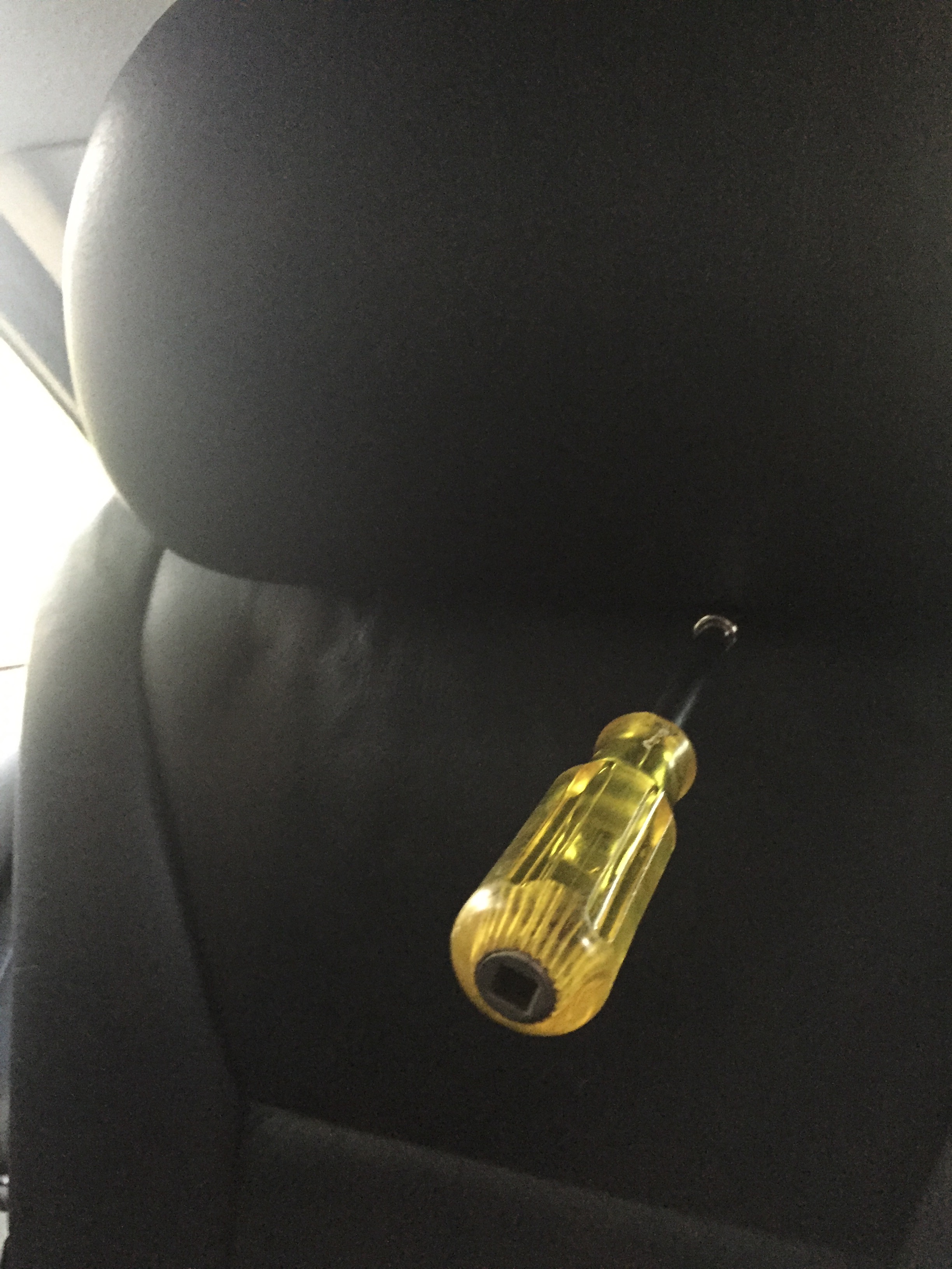

Summary of the solution: How to manually flip down a stuck, electronically released headrest:
The tools are a small hex key, a corresponding socket, and a nut driver, put together like this: You want to squeeze the allen key under the headrest and into the gap between the headrest post and the center trim: Then rotate the nut driver counter clockwise, this presses on the latch and releases the headrest forward: Now to fix it I removed the 2 plastic trim rings And opened up the seat leather. Then without removing the mechanism I reached through the plastic holes and applied silicone lube onto the latch. It's been working great now, nothing else was needed. I didn't touch the grounds, they were all clean.
