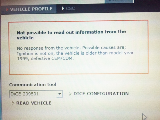

The "unhandled exception..." is resolved with .Net Framework 3.5.1.
VIDA now says this:

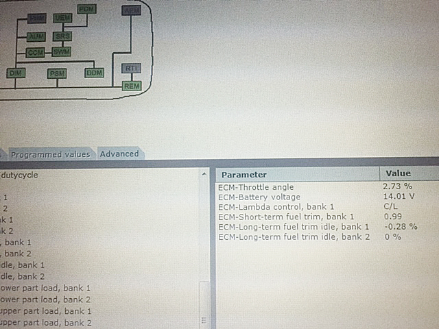

VIDA/DiCE 2014D is now working, FINALLY! Is isoview 7 any better over 4 -- improved?
