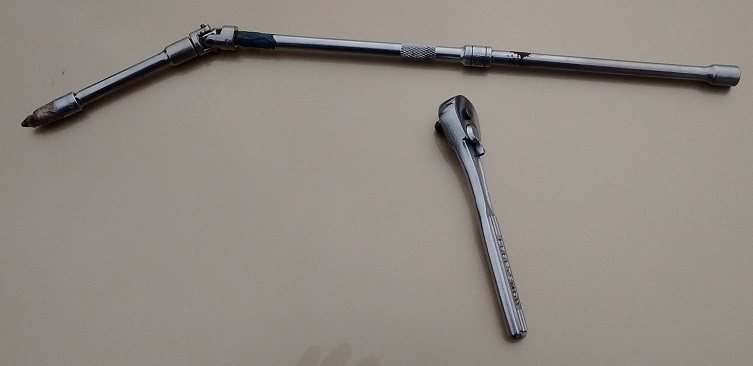

Some say that they can't imagine doing this in the car. You can use a stubby
Phillips screw driver, but this makes all but the rear most cover screw easy:
VOLVO ALT TOOLS SM.jpg (250.82 KiB) Viewed 9783 times

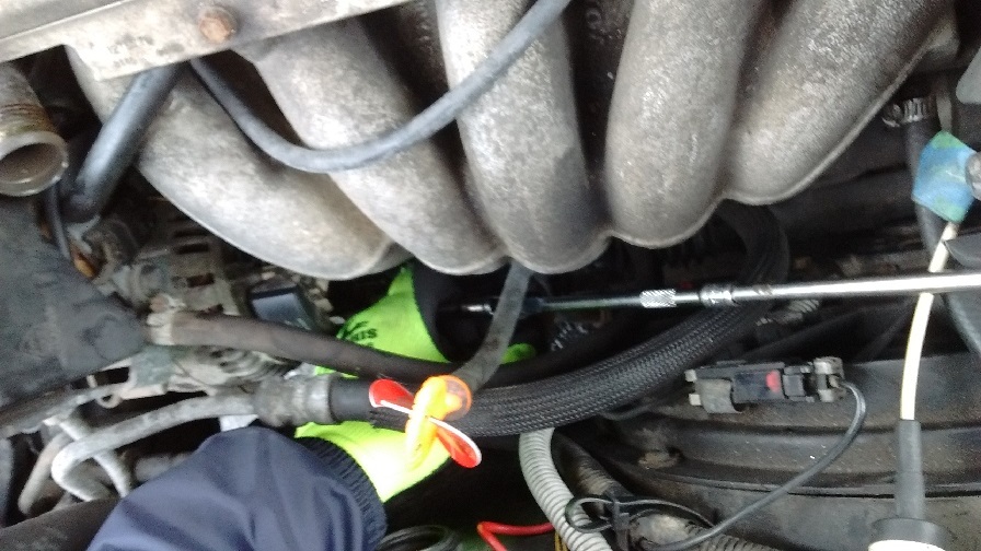

Here's how I guide it in with one hand:
VOLVO ALT SCREW SM.jpg (382.34 KiB) Viewed 9783 times

That is very cool but I used what I had and it was also easy.
Even at 30 deg F out - wear long underwear.
I didn't even remove the dipstick tube.
