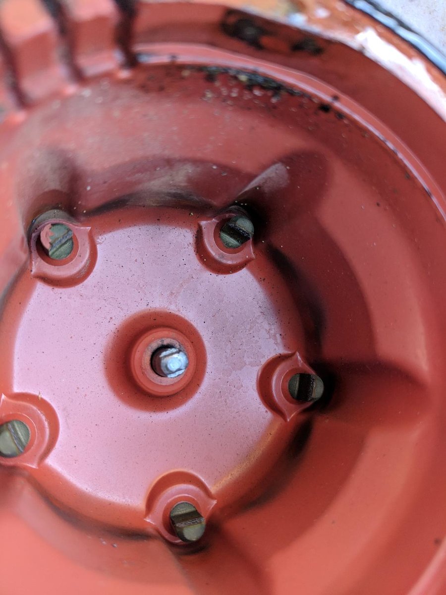

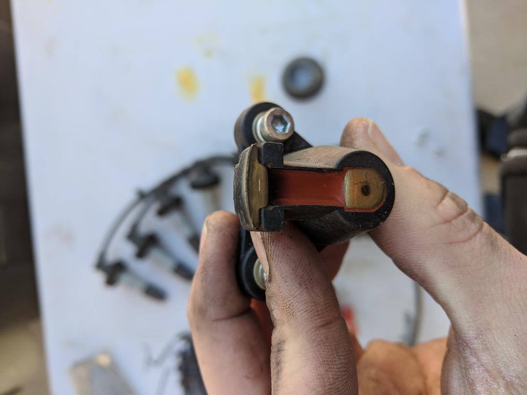

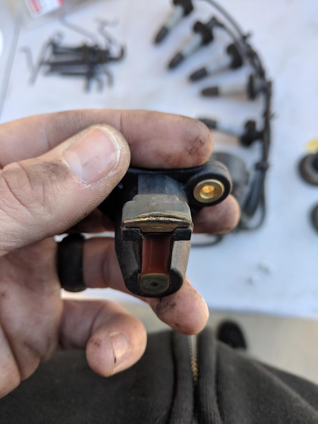

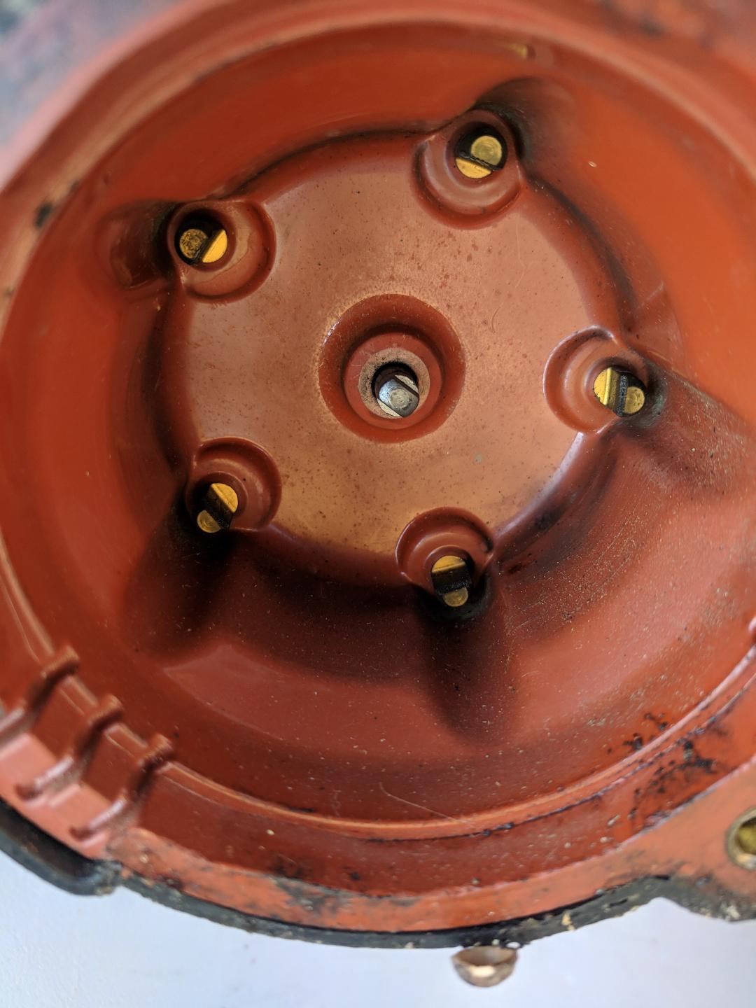

Here are the old cap and rotor and the newer but used cap and rotor...
Here are the old cap and rotor pics and the newer but used one i installed with newer used wires.

First two pics are the newer ones I installed.

Other than being dirty, they look operable. Wouldn't hurt to clean them up a little.
