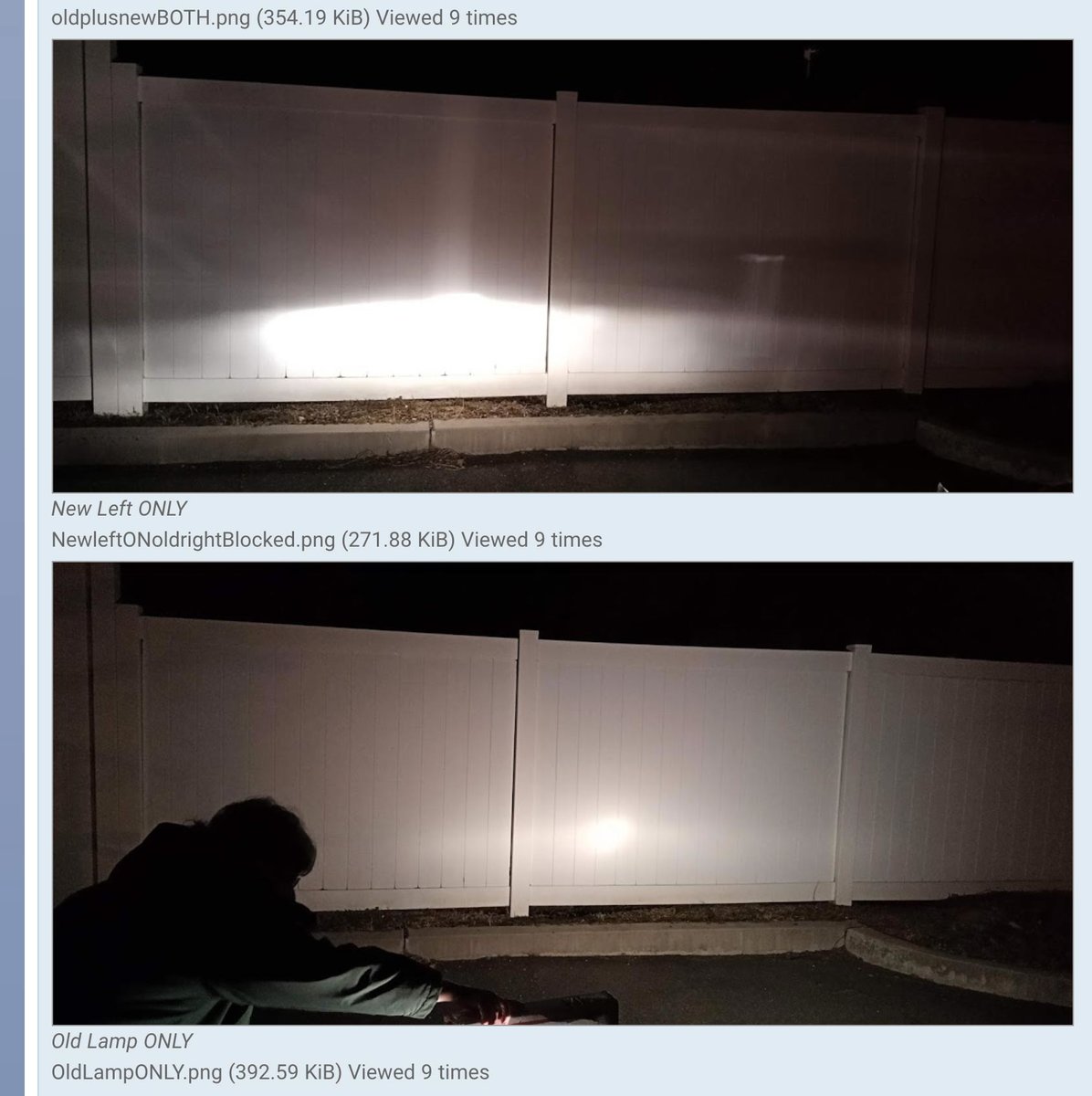

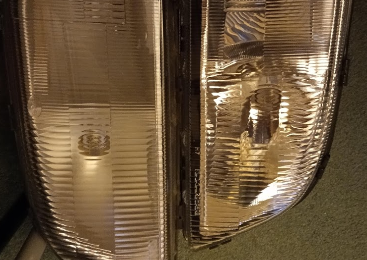

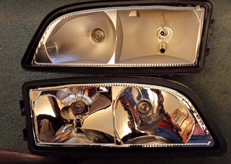

If you haven't replaced your headlight housings, you probably should. You may have followed my musings about headlights and my unwillingness to go outside and actually deal with them in the cold weather and my reluctance to spend any money. Thanks for putting up with that. Bottom line is that the replacement TYC aftermarket stock-style lights at $80 is the only rational thing to do. If you want to go beyond that, go HID or LED or laser, but if the housings are shot, any light source you put in them will be severely limited. Here are some pics:
Quite a difference in terms of reflectivity and focusing of the beam.

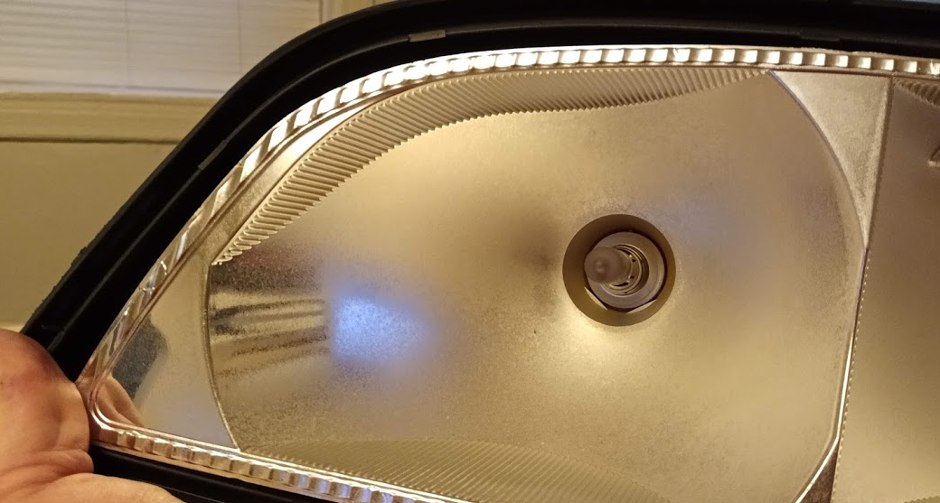

It is, in fact, easy to see when headlights are bad from simply looking into the lens. I thought it might be harder to tell.
You can see just a tiny bit of plating left far away from the bulb. There's no plating anywhere else.
The TYC aftermarket headlight assembly has all of the stock adjustments and even includes a place for the headlight washer rest. It went into the car with little or no trouble. These are priced at $80-83 on the web as of January 2018.

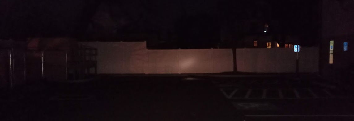

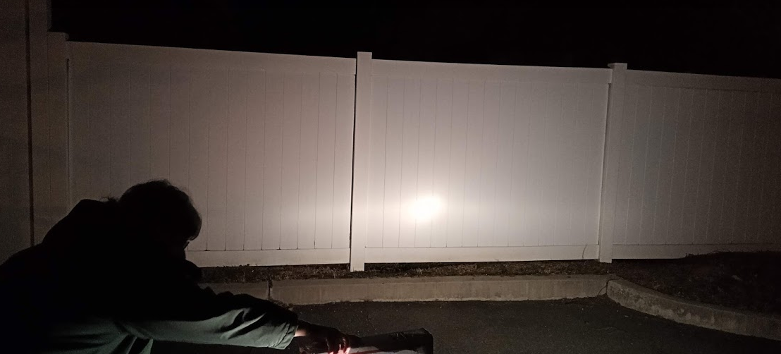

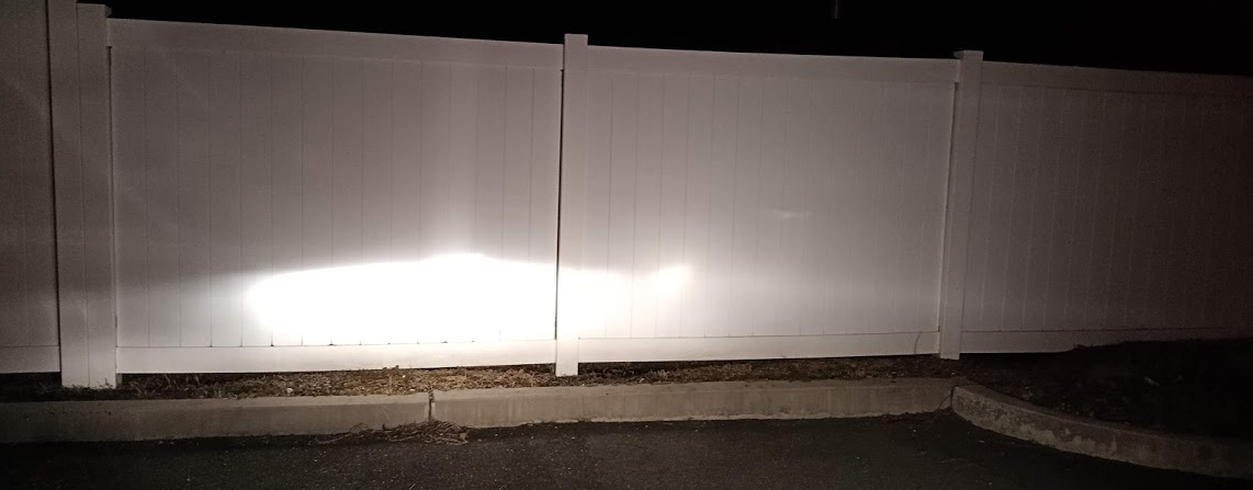

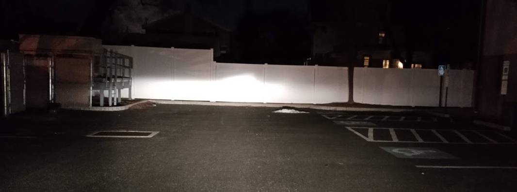

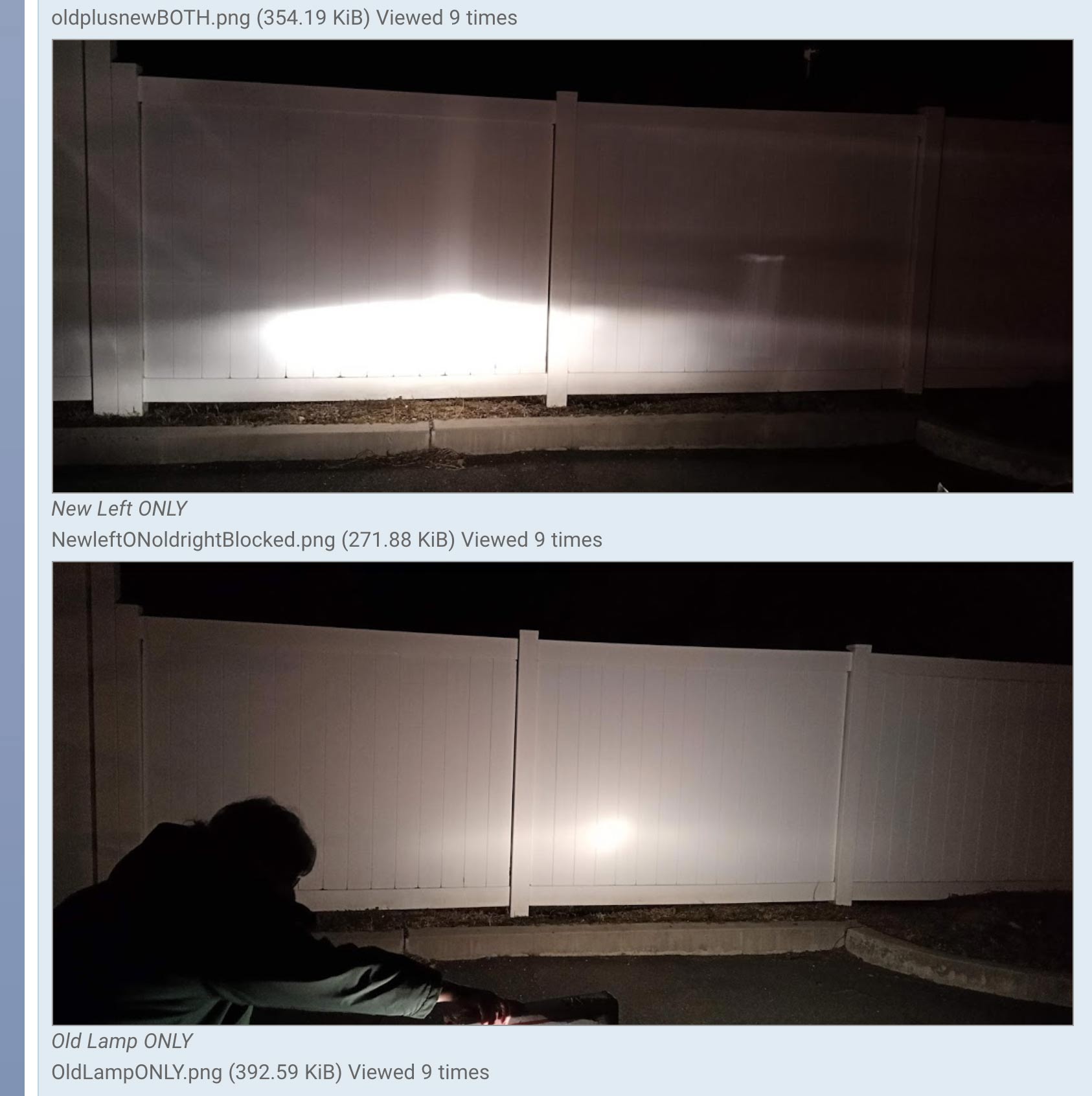

Here's the white fence test with a new left housing and an old right housing:
New Left with Old Right
New Left ON, Old Right Blocked
New Left BLOCKED, Old right ONLY
New Left, Old Right Both ON
New Left ONLY
New Left ONLY
Old Lamp ONLY
Old Lamp ONLY

Oh my I live for comparisons, but if you have to wait til it’s dark and cold, I get it. At least can you do a daylight photo looking at the front of the car with the lights on?

matthew1 wrote: 22 Jan 2019, 15:54 Oh my I live for comparisons, but if you have to wait til it’s dark and cold, I get it. At least can you do a daylight photo looking at the front of the car with the lights on?
Fixed it, Matthew. Couldn't resist a test myself. This headlight loss of reflectivity is a major hidden safety issue that sneaks up on you slowly. Now, I have to order headlights for my V70.

Well, I'd keep an eye out for the C70 jewels, but these are more than adequate for me. What's different about the C70? Just the lenses, or the whole assembly? C70 lights are much more expensive.
That lackluster right headlight has the 30% brighter lamps I just fitted a few weeks ago. The bright left hand headlight has the standard H7's that came in the headlamp assemblies.
