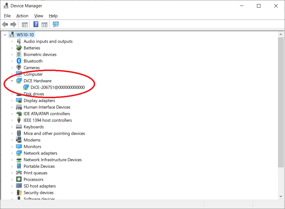

Look again, DiCE does not appear as a com port when it is working.
If your DiCE does appear as a com port, you may have a clone that deviates from J2534.

I remember our 2014A VIDA/DiCE purchase. The install from the original DVD back in 2014-15 did install DiCE Hardware -- similar to as shown in your screenshot. However, since the 2014D upgrade DiCE has turned illusive.
I'll look again, meanwhile, what is J2534 and is there a corrective procedure?

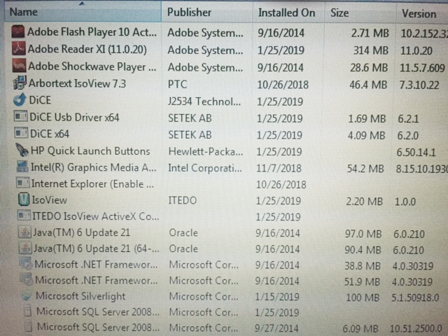

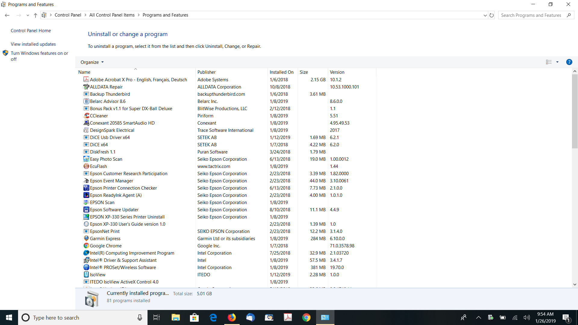

USB Device Not Recognized - device malfunctioned.
No success with DiCE Hardware at Device Manager. Listing under Programs for DiCE show a J2534 item with SETEK AB drivers.
Is this normal? where to debug further?
