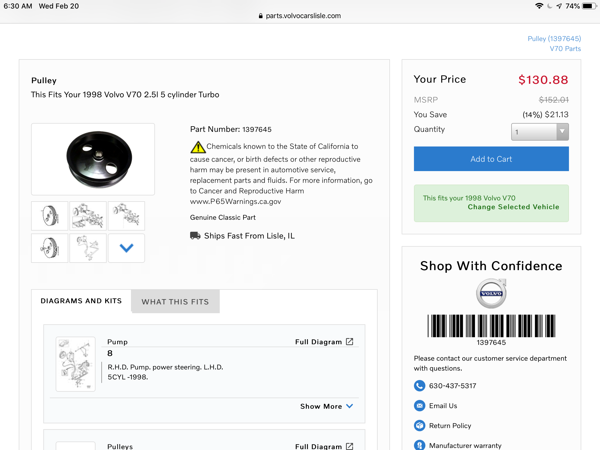

Hello all,
While slowly bringing my 1998 S70 back to life I have determined that I have a leaking PS pump. Reservoir is getting low, and dirty oil all around/over the alternator area, etc. There is no howling noise or anything, but I figured it was just easier to replace the unit. I have acquired a rebuilt unit with a reservoir, but it does not, of course, have the pulley installed. In searching I can't find a good write up on R&R'ing the pulley, it seems most people go used with pulley attached or pay a shop to do it.
The only reference I've found was to the OEM Volvo tool (part number 9995737), or a solitary post for a Lisle 39000 from Amazon.
Is there a definitive answer on doing this procedure that I'm missing, or is it just not something that's done that often?
Lastly, is there a different solution other than replacement? Should I just be looking at the seal to the reservoir and the pressure return o-ring?
