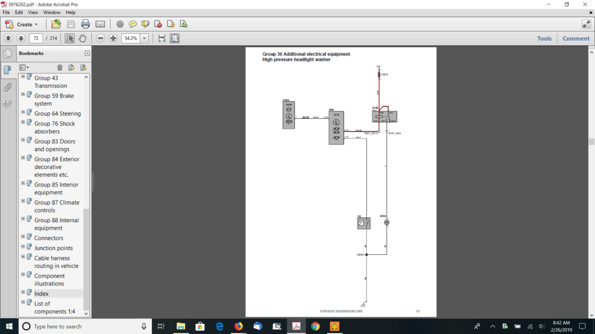

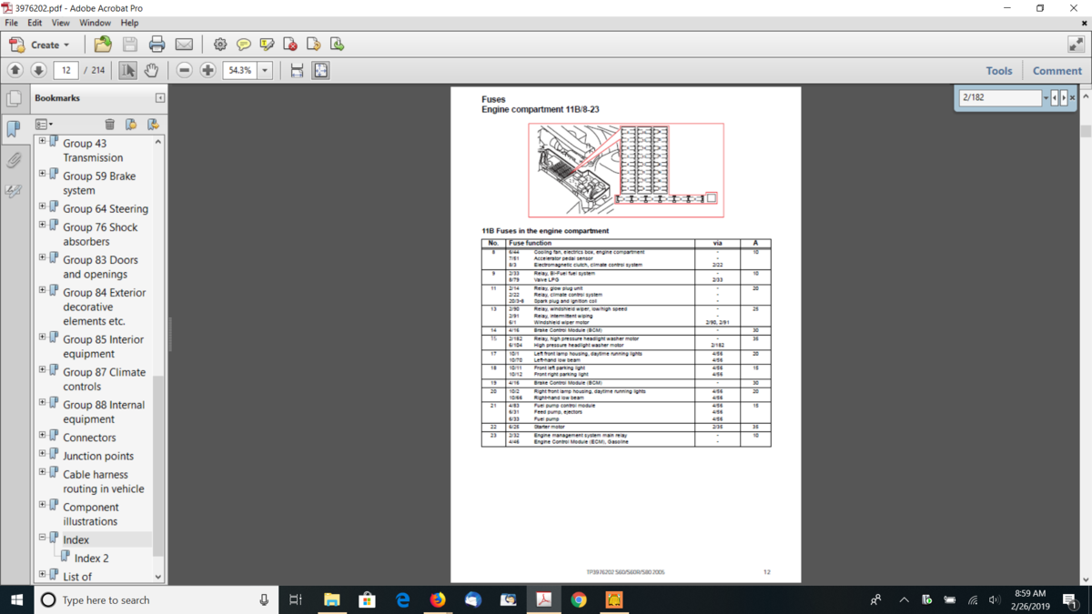

The fuse and relay for the High Pressure Headlight Washer is in the engine bay fuse box.

Check headlamp washer fuse (15).
Switch the windshield washer relay with the headlamp washer relay and see if the fault moves - bad relay.
Try to see if the headlamp washer pump is getting power.
- Posts: 35298
- Has thanked: 1505 times
- Been thanked: 3818 times
You trouble shoot electronics backwards...look for voltage at the component , then work your back to find where it is and why the circuit is broken.
