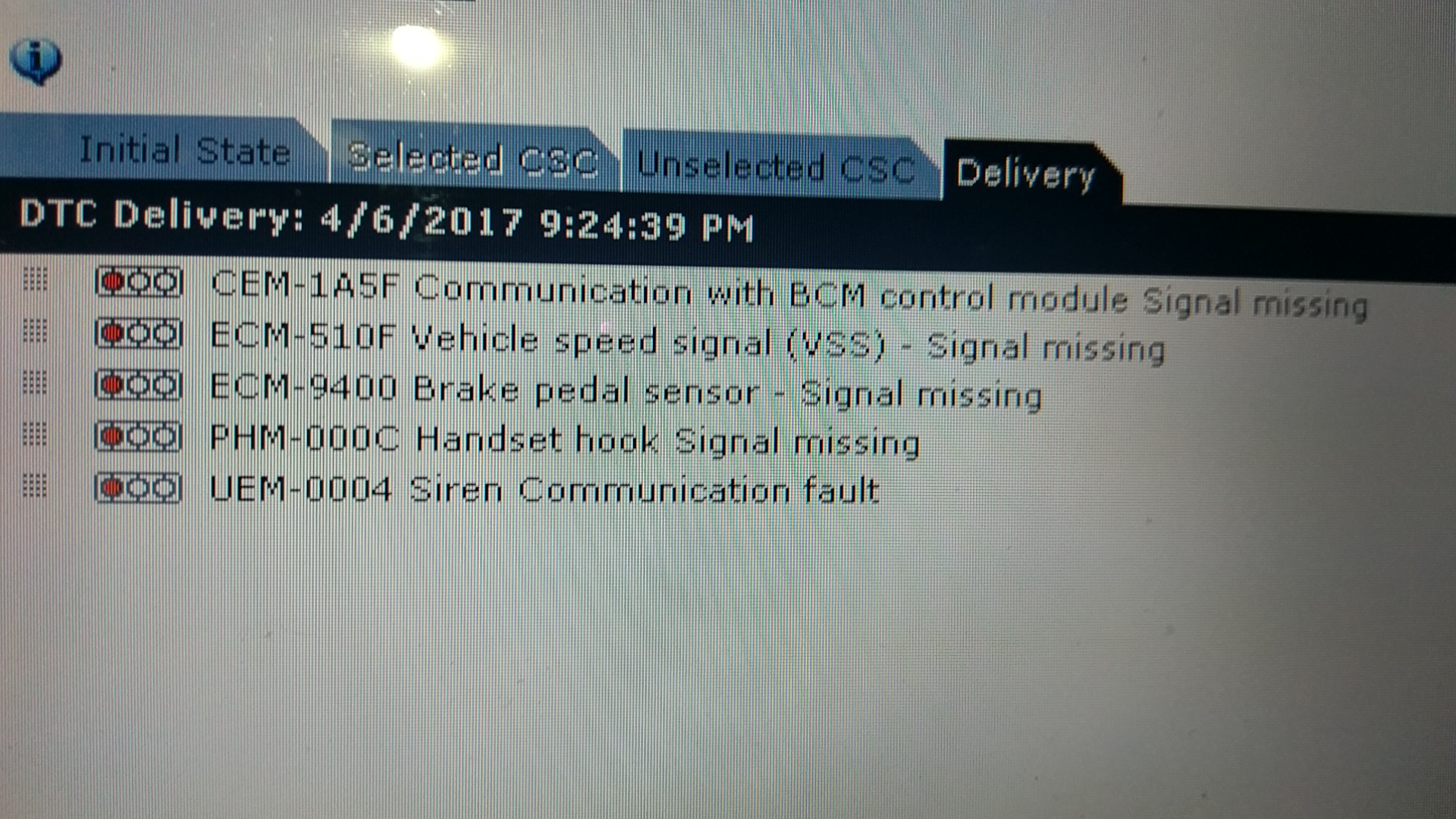

I picked up an 03 v70 T5 a week ago and am trying to chase down a couple of DTCs. I am new to the Volvo CAN-BUS system, but get the idea via my years with VW. I'm just looking for a bit of guidance in making sure I am following the right breadcrumbs! When I got the car, a friend came over and we hooked up his VIDA/DICE and pulled a slew (4 pages) of codes. Everything from Seat Temp Failure to ABS. We reset it and it popped up 5 new ones... but some big ones, but at least it was more manageable!
As read from VIDA they are:
CEM-1A5F Communication with BCM control module Signal missing
ECM-510F Vehicle speed signal (VSS) - Signal Missing
ECM-9400 Brake pedal sensor - Signal missing
PHM-000C Handset hook Signal Missing
UEM-0004 Siren Communication Fault

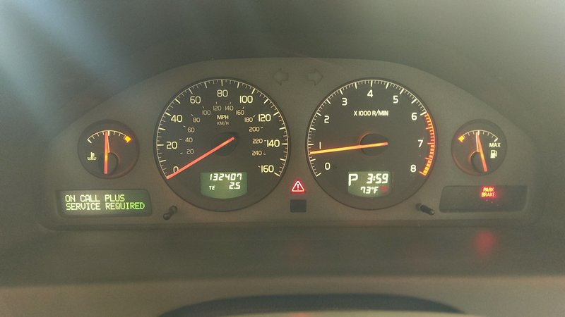

On the dash I have lit: ABS - BRAKE - DSTC - Red ! - "Brake Failure Stop Safely"
Other symptoms: Odometer & Cruise Control don't work. DTSC button is lit constantly.

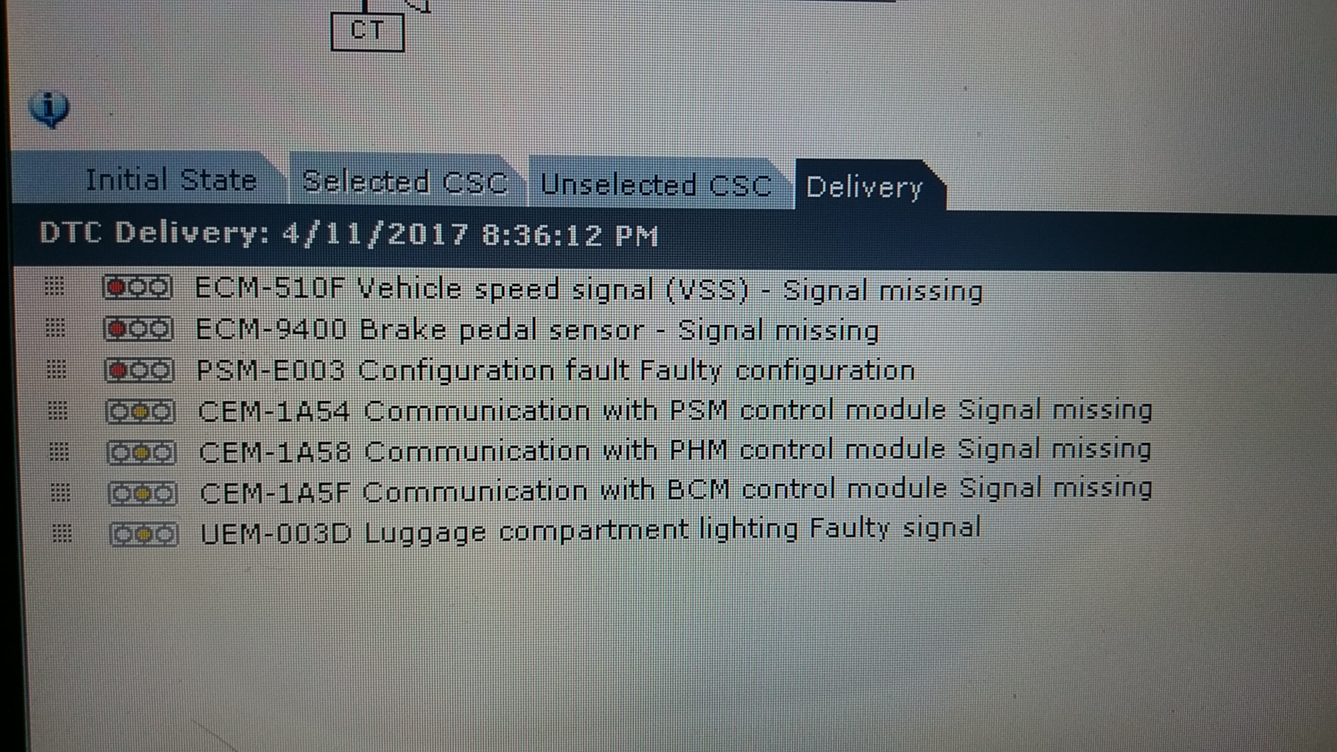

I played on my friends good graces and drove the car to his place. We scanned it with VIDA again and got a another round of errors, some new, some old. Here's what we came up with and the current hypothesis.
A big chunk of these are explainable and I'll manually correct them shortly, such as..
UEM... I tried a LED lamp in the cargo area. It fails to shut off, so I get an error.
PHM..I pulled the phone keypad out, but it looks like it's a terminator, so I'm going to reinstall it and see what it effects.
PSM... I kept the XC seat controls with the XC seats I installed. Apparently they are mated... &^%$*&%$*&^% CAN-BUS. Swap back should cure that one.
That leaves the biggies...
ECM-9400 Brake Pedal Sensor Missing... This one has been constant and I am not sure where to look since all the lights function normally. I have replaced the position sensor on the booster. I'm not seeing the forest on this one. Will the ABS module give this one? Does the switch have multiple circuits that can allow lights to work normally, but cause the BCM to see a fault?
ECM-510F Vehicle Speed Signal (VSS) - Signal Missing... This one has been constant too. I presume this is why the Odo doesn't work. I literally just found a 6 year old thread dealing with this one under a P0502 code title, checking ABS sensors and such, so I have a new path for this one now!
So does anyone have a hint on the ECM-9400 code and where my time would be best spent trying to figure it out? The 501 thread I found had a lot of options to try, so I'll follow that process out and see what fruit it bears.

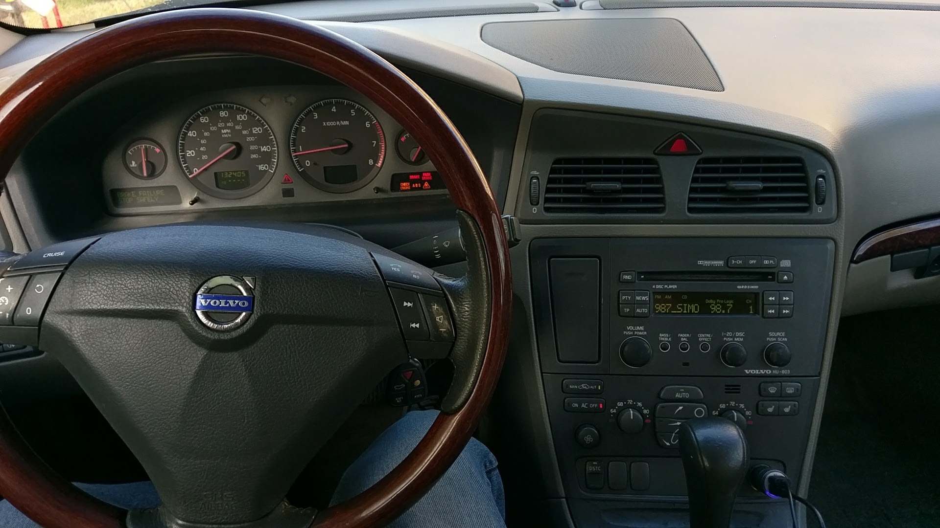

ODO working and lights or!!! Yayyyyyy
