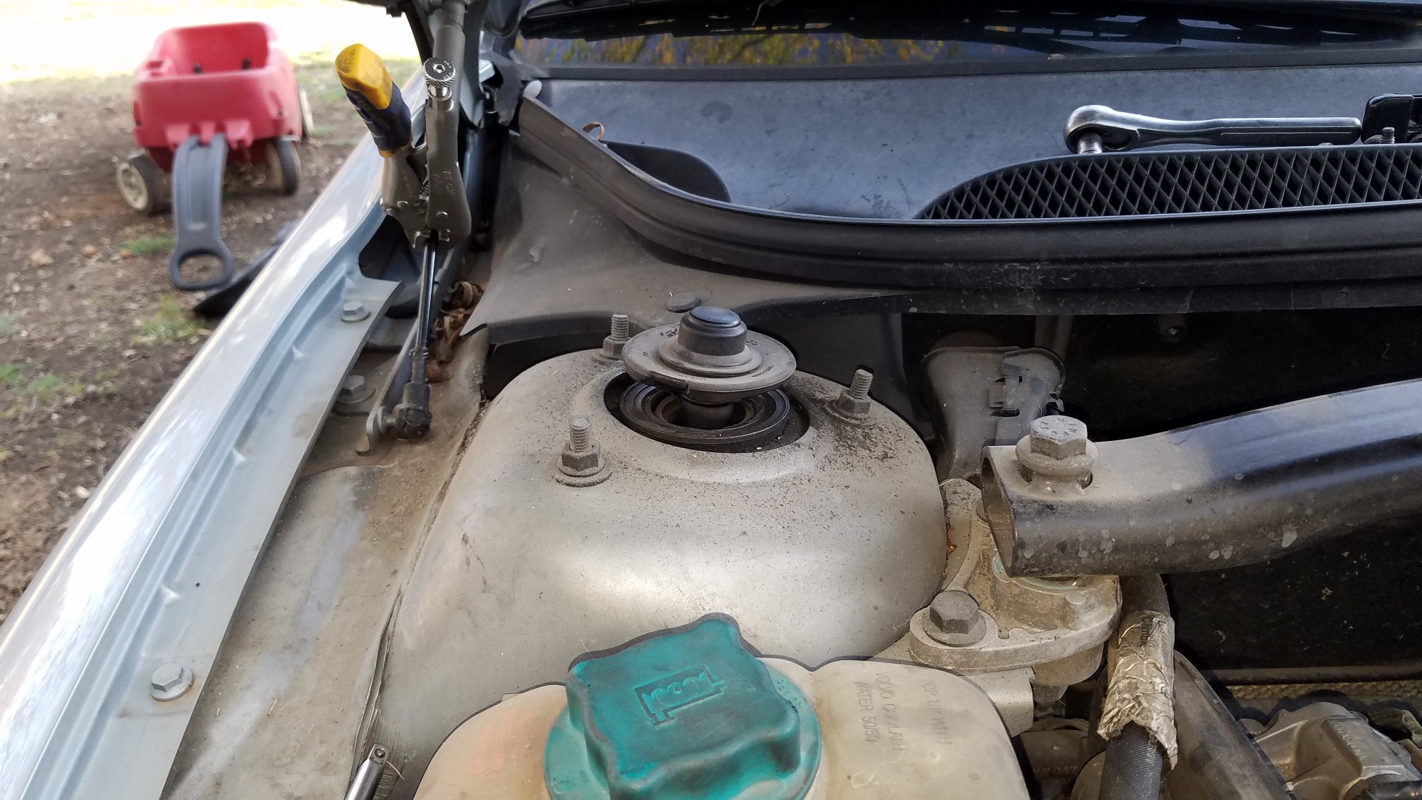

Strut tops seperated (never seen that before)

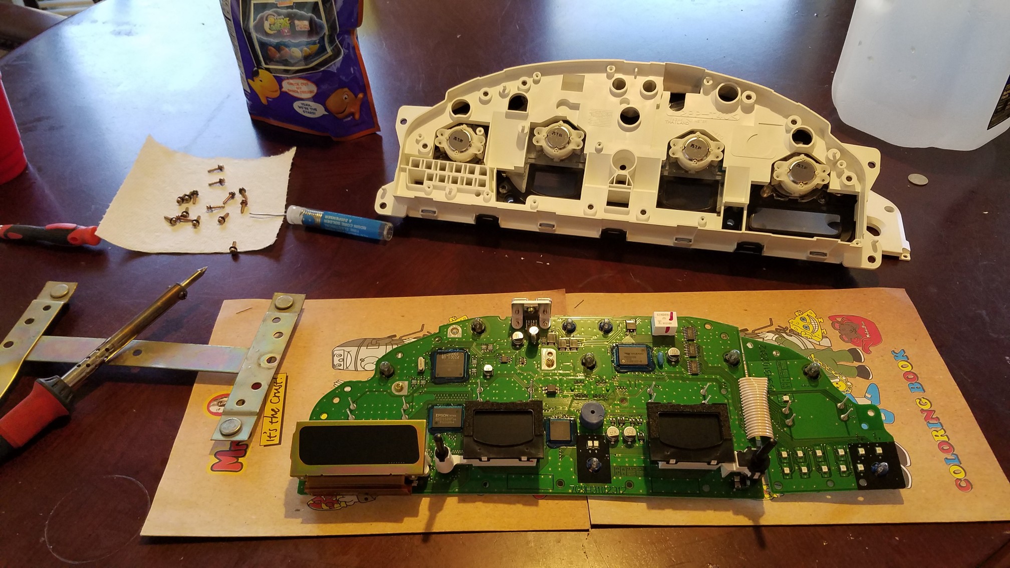

Gauge cluster dead

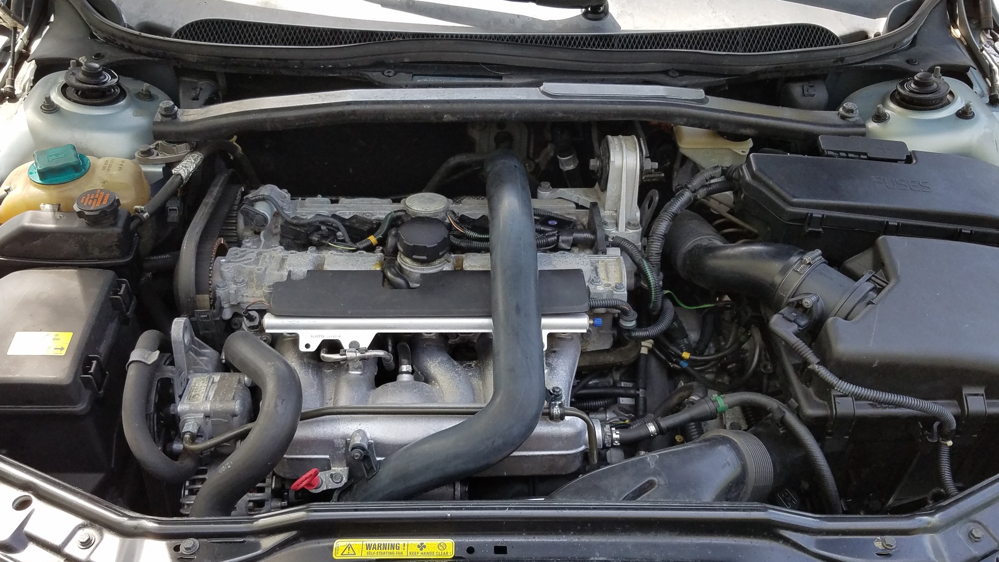

Don't forget to do the glove test to check the PCV is ok (rubber glove over oil filler hole - if inflates, then PCV bad and needs replacement/cleaning).

I do need to check the PCV system for sure. I got lucky with my v70, the previous owner took it to volvo for maintenance, and it had a fresh top end! 185PSI across all cylinders!
didnt get so lucky on this one. 145psi on cylinders 1 2 and 5. 125 psi on cylinders 3 and 4. I know I'll need to do a timing belt pretty quickly, because there are not records of this one being done

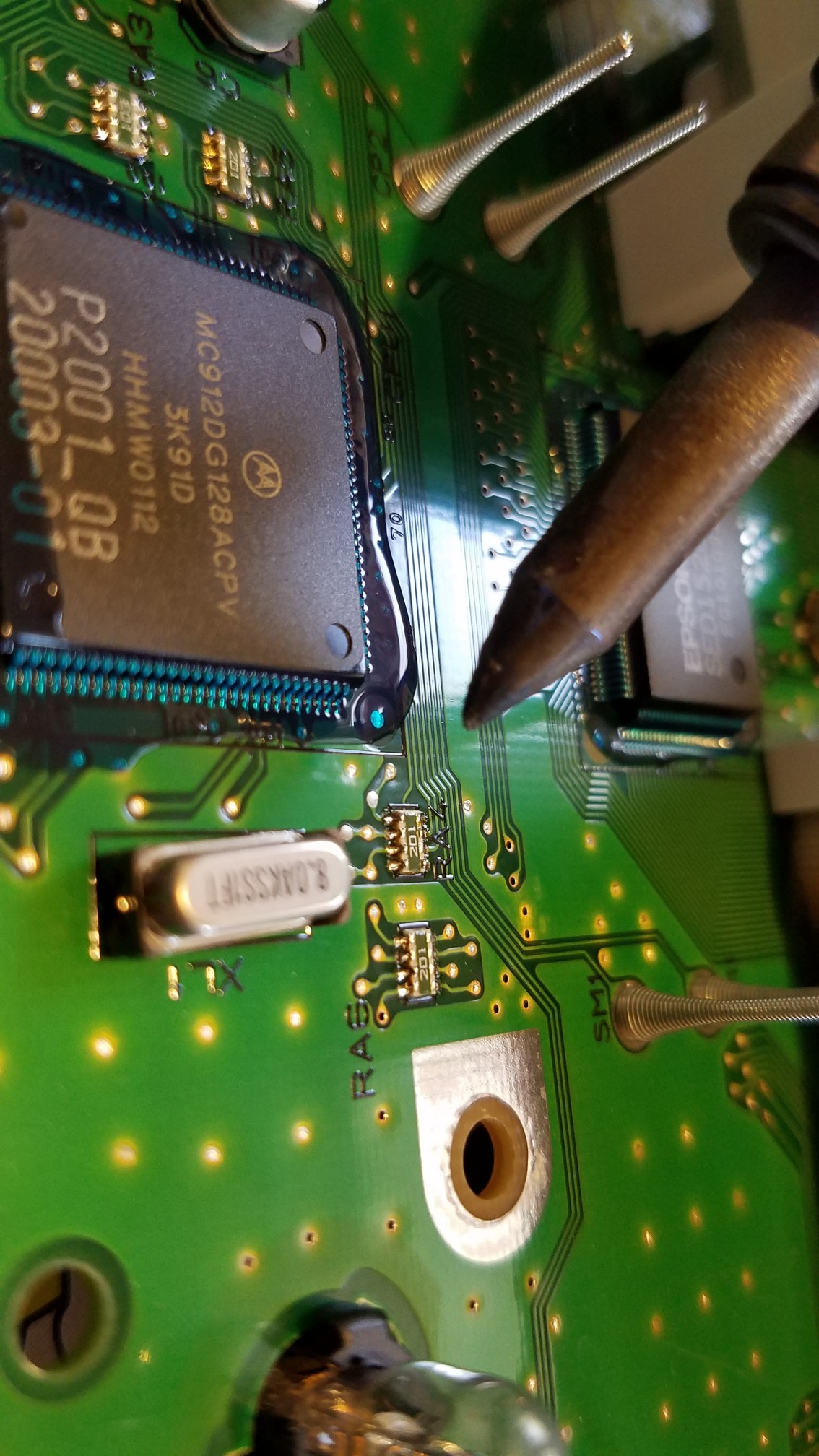

For the reflow of the DIM, I see you have a soldering iron.
- Are you going to work each IC pin one by one?
- Are you planning to prepare the surface prior to soldering? Some have removed the blue colored coating on the pins of the larger ICs.
- Will you use flux?

Thank you!!EngineeringBloke wrote: 27 Mar 2019, 16:51 For the reflow of the DIM, I see you have a soldering iron.
And good job with the Ammo Can. It was a different project than most I have seen here, but I think you did very well and enjoyed it.
For the gauge cluster, I only used a fine tip iron to reflow the pins individually. It takes a very steady hand, but not too hard. I have done alot of various board and small part repairs like this. Something interesting is, of all the Volvo clusters I have done, NONE of them needed any work on the controllers with the blue coatings. Just hit the IC pins in the photos, and you will be good to go.
