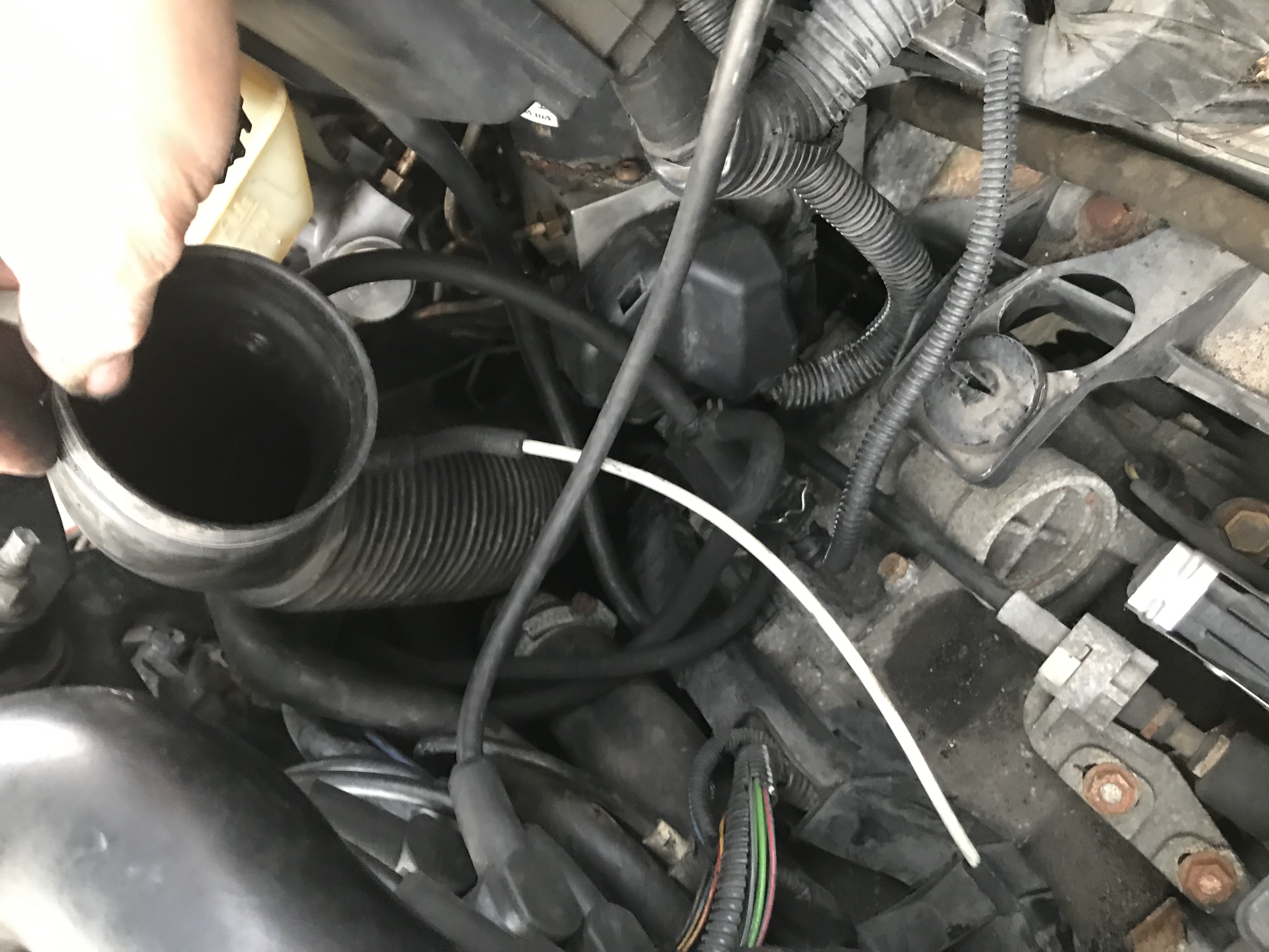

My V70R threw a p0172 code and I found a vacuum line broke, but I don’t know where the other end goes. It’s the other end of the white line. Any help would be great.

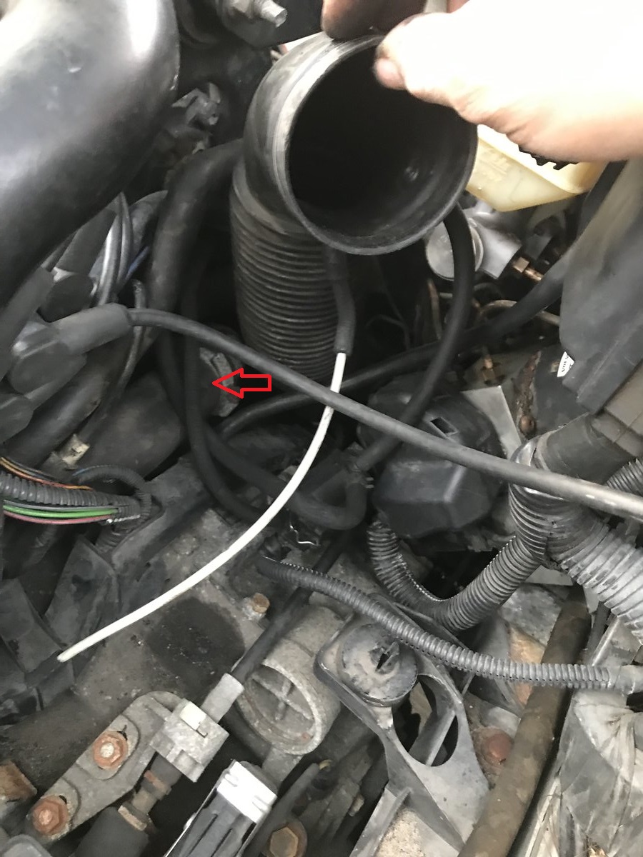

Follow the hose marked with the Red arrow until you find the nipple on the metal pipe.
It is on the side closest to the engine block

To be clear, the white line connects to the fuel pressure regulator behind the engine, down low close to the firewall. Look for a small metal line back there. My preferred way to fix this line is to just get a length of rubber or silicone and get rid of the hard white line and elbows.
Any time you have p0172, first place to check is the nipple on the passenger side of the intake manifold. Get a flashlight and peer in there, between the manifold and the thermostat housing. Otherwise check all the vacuum lines and/or try using starting fluid etc to search for vacuum leaks.

I looked at the elbow and it was still on the nipple on the intake manifold. Does this line go to the PTC? If so, could a bad PTC cause the MAF problem? I will do more with the car tomorrow morning.

you cant loose enough vacuum on the line to the PTC to upset the MAF. It may cause some idle roughness but no code. Check all the turbo connections between the MAF and throttle body.

If that disconnected line was to the fuel damper, it would run rich with high fuel pressure ( smoking), but the line is usually connected to the throttle body tree.
