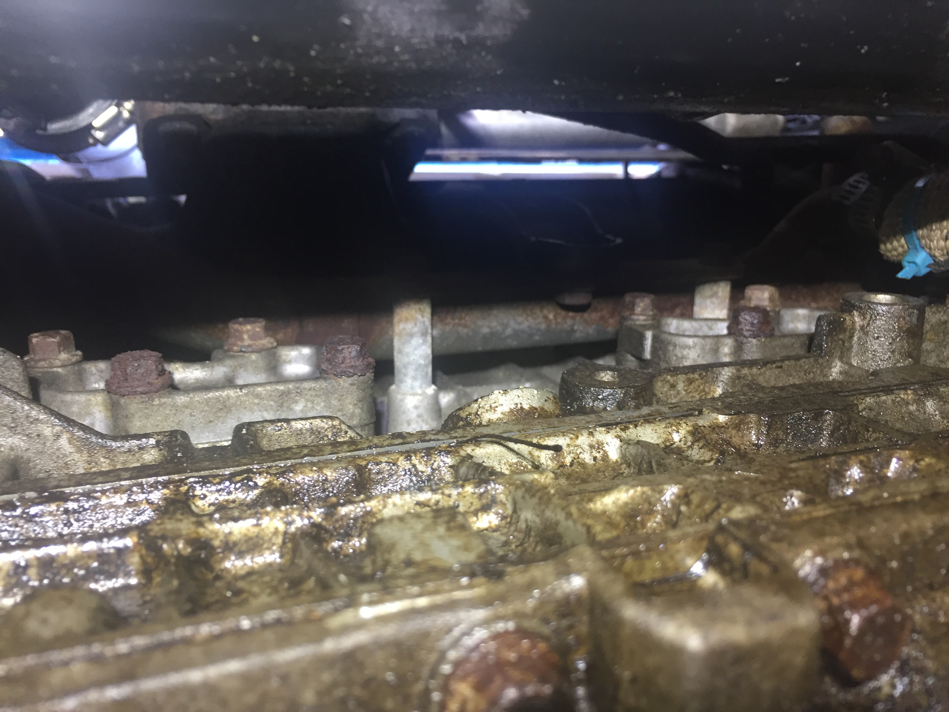

Prompted by leaks pictured here
viewtopic.php?f=1&t=81390
Replaced the turbo oil line, gasket. Clamp. And o-ring on the T5
Chassis break on the oil line, be careful ordering.
These parts hide under lubrication system , not turbocharger category in Volvo parts apps

I replaced the gasket a few weeks ago on mine, easy job once the car is on ramps and it fixed one of my oil leaks
I'd recommend fixing it asap when it leaks, p.o drove mine with the leak for a year and since it drops on the driveshaft it covers the whole engine bay in oil

Well, power washed the underneath and have a hot run on Tuesday next week, so we will know if that has helped the wet engine back (right side) problem shortly....

Follow up
This completely fixed this
