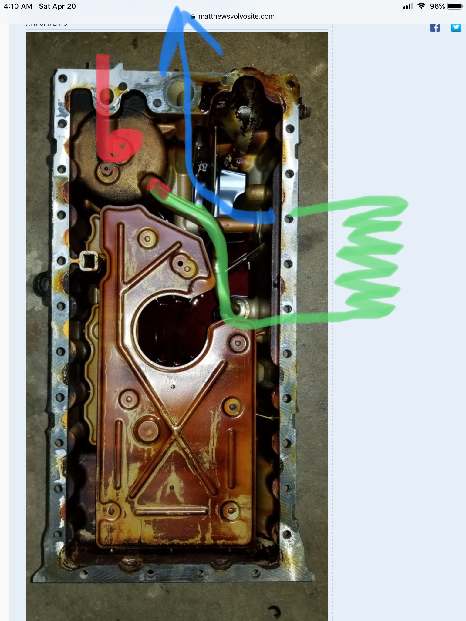

Does this look right?
Red unfiltered oil
Green filtered oil
Blue filtered and cooled oil
Red unfiltered oil
Green filtered oil
