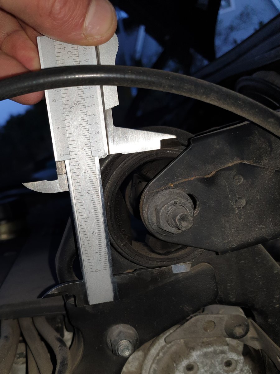

So here's how my upper engine mount bushing looks:
58mm is what I got this time measuring under better light conditions. As you can see, diameter measurement is done on the outer edge of the rubber bushing.
On the backside of the bushing is a part number beginning with 68422xxx (the rest is unreadable due to the crack in the bushing) - but it does look very similar to the 60mm OEM one. So I guess I'll have to assume I need the 60mm one and that violence will make it fit.
- Posts: 36145
Length, lubricant, and leverage, all important aspects of rubber parts
