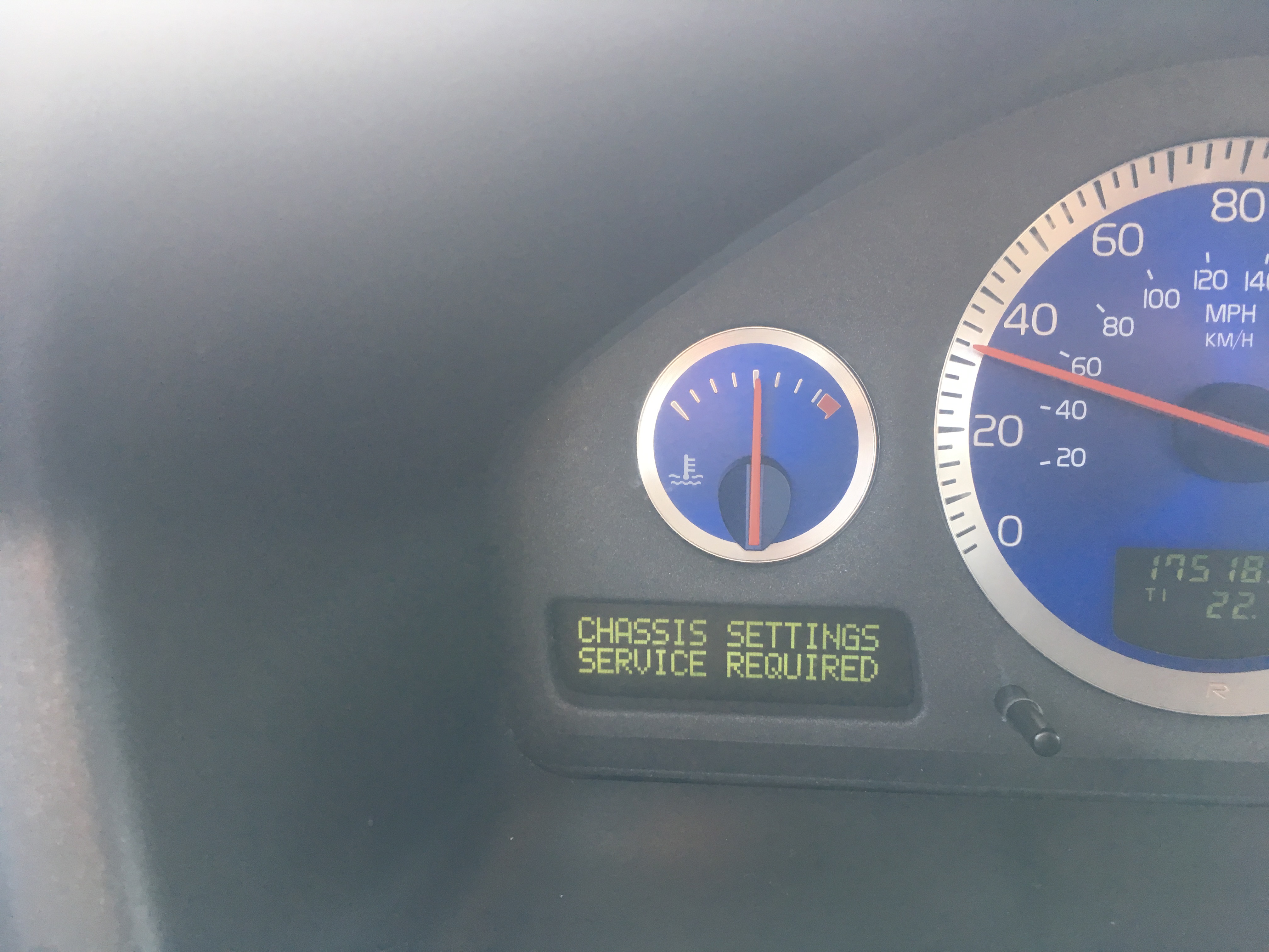

1. Chassis settings service chassis

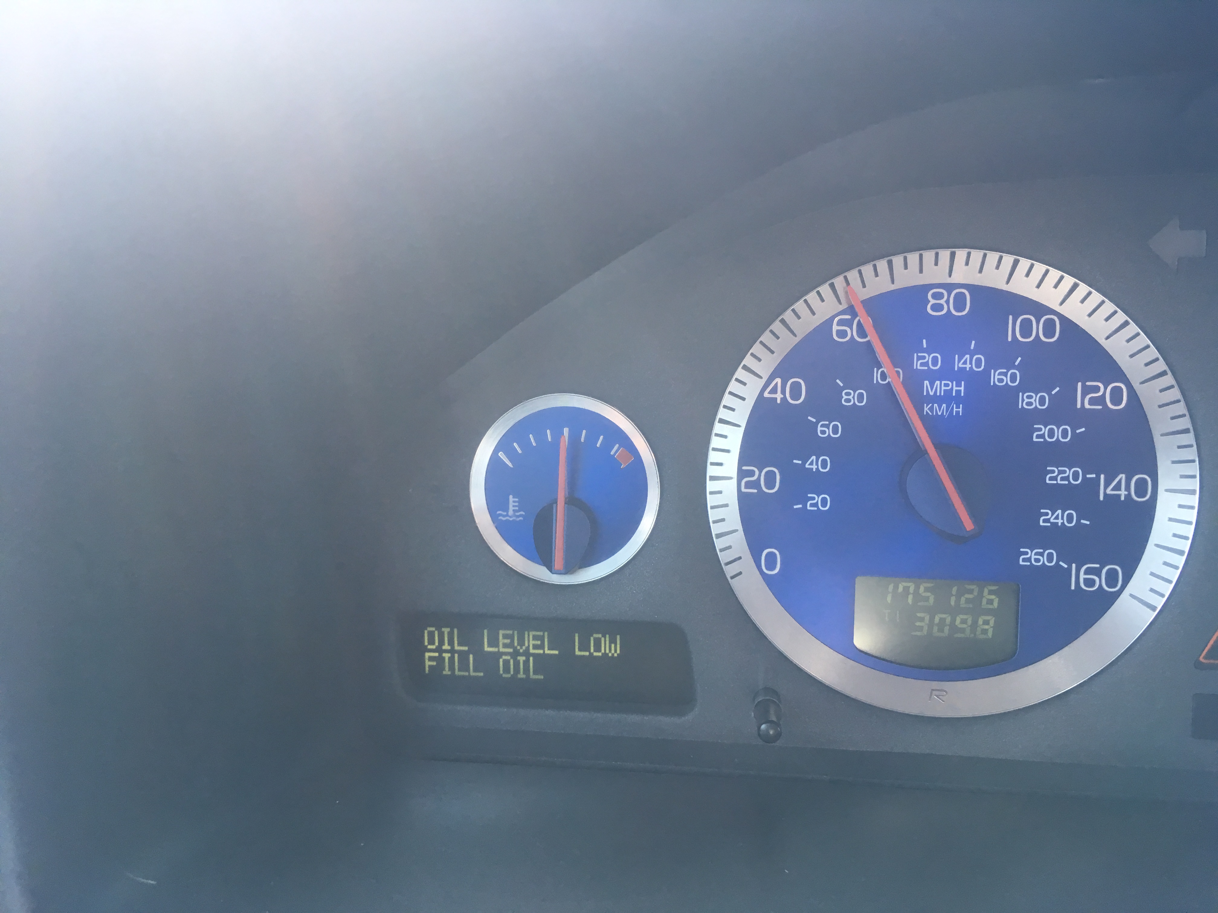

3. Low oil fill oil

Low oil... Have you checked the oil level? It might just be low.
The service chasis message is probably related to the electronic struts. Either they have been swapped out for standard struts of have failed. Check what struts are installed.

The oil level is always at the top of the mark on the dip stick.

I’ll take a look at the struts but the car is handling great. It’s the smoothest car I’ve ever been in. Contrast it to my moms 2007 Caddy DTS and the Volvo is so much more comfortable without having the numb feel of an older American car. I’ll try to take time to take wheels off and get some pictures of the suspension.

I smelled burning oil when I stopped today. The oil was near the bottom of the ok marks. I topped it off with 5w-20. I got pictures of the dash lights.

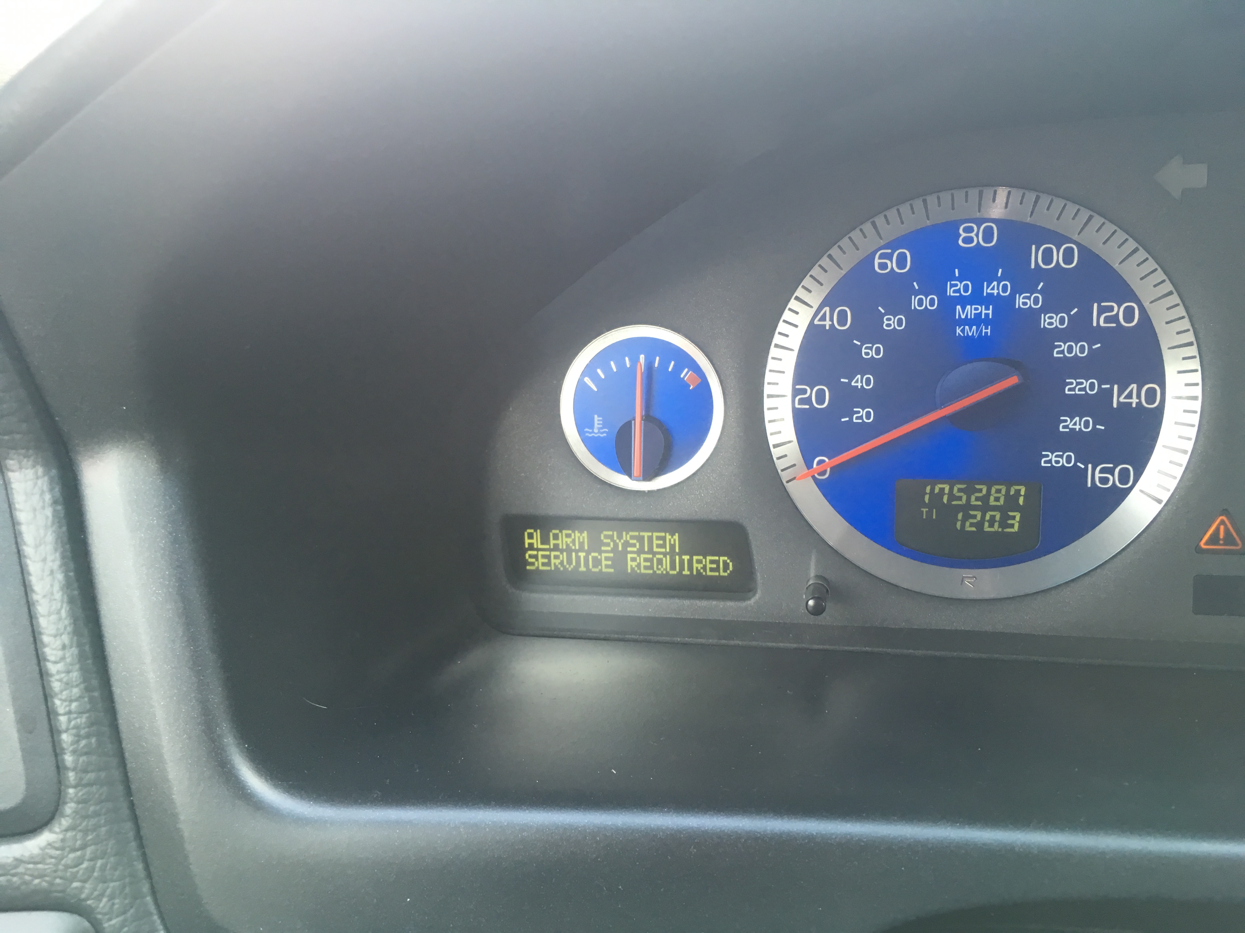

I still haven’t fixed anything. Here’s some pictures. Alarm System is a new light.

The struts have probably been replaced, but with non 4C struts, hence the chassis message. R models come with 4C Monroe struts and replacement are nearly $1k, so frequently they are replaced with non 4C struts triggering that message. Look for a wire near the bottom of the struts. No wire not 4C.

Alarm system warning might be because of a faulty alarm module, had that problem on a V70 I used to own. It also affected the operation of the sunroof. The module is located in front of the passenger front wheel, remove the wheel liner and you'll see it.Saltyvolvo wrote: ↑23 May 2019, 19:57 It’s leaking from under the car. It’s the gas tank but I’m not sure where. I haven’t really looked.
