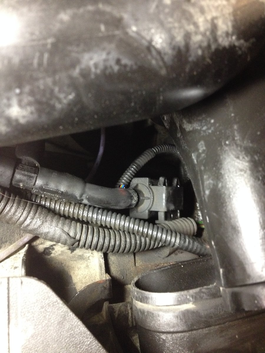

2)For the P0455, I cleaned the purge valve or so I think Please confirm that this is the purge valve, it was under the air intake hose near the rad.
Is this the purge valve?

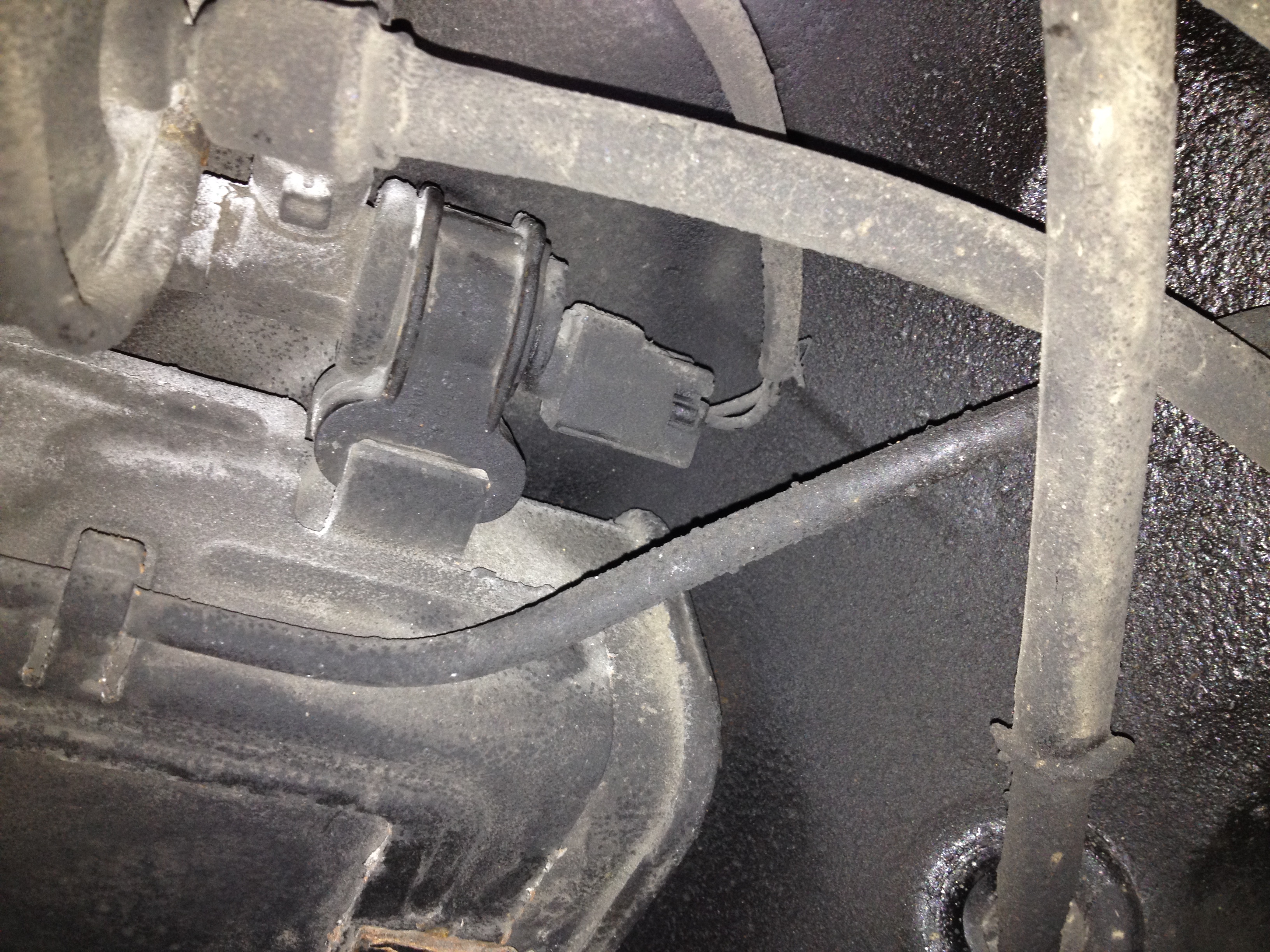

3)For the J hose, It wasn't clear where it is, is it near the fuel filter? See the pic I've attached, I took it bending on my knees near the fuel filter, the picture is of the component it is attached to . Or is it behind the turn signal or front wheel like some have suggested?
Does the J hose connect to this component

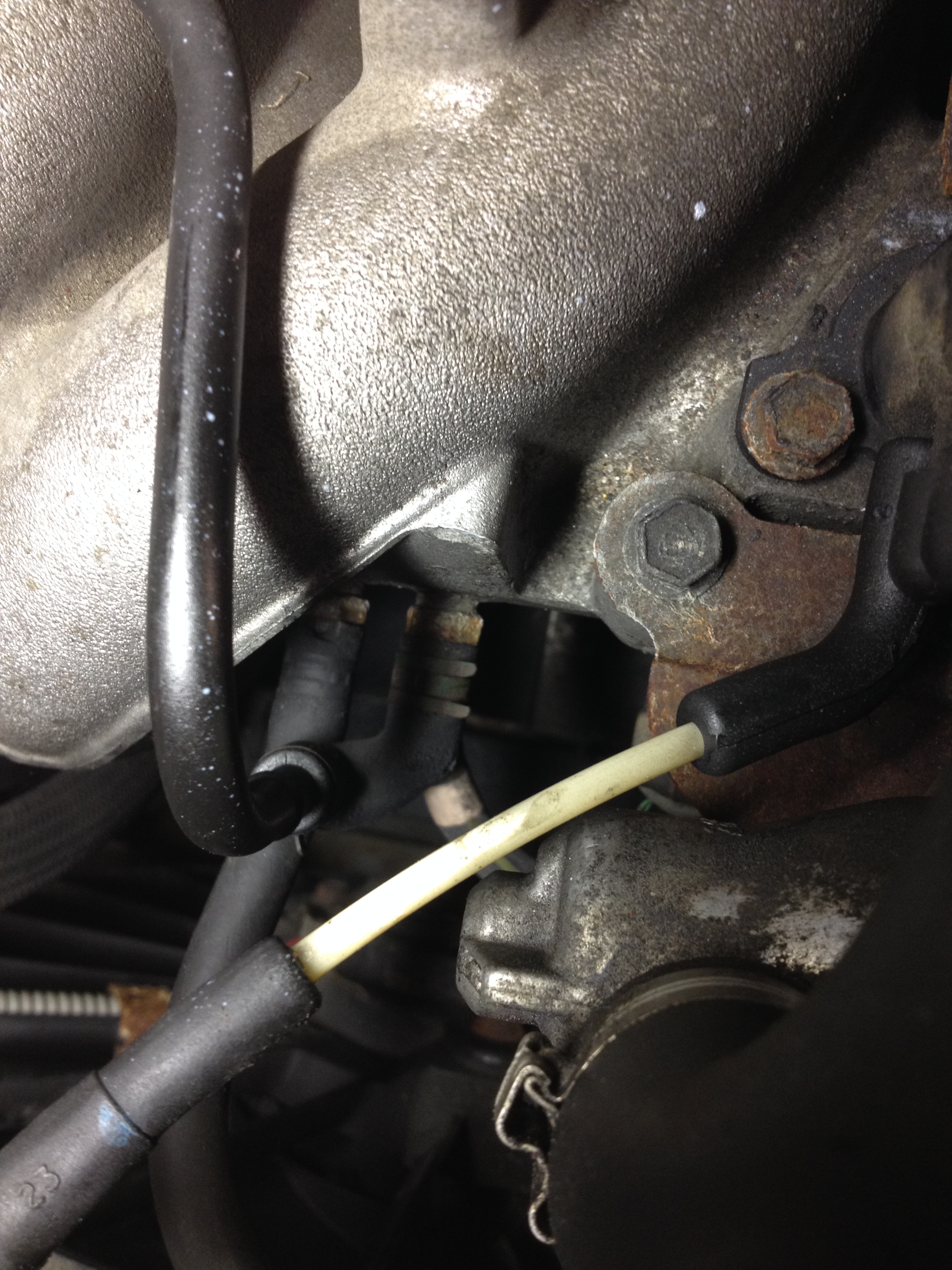

4) There are two small hoses near the throttle body cable that connect to the manifold; they seem old and cracked, what are they for?
What are these two hoses for

2 - That is the purge valve.
3 - I think that is the charcoal canister yes, can't tell for sure. Also look at the hoses on the rollover valve near the fuel filter.
4 - the one that loops over the manifold probably goes to the fuel pressure regulator. The other I am not sure. Bottom line, replace them both when it is convenient. Pretty much all of the rubber lines are shot by now.
